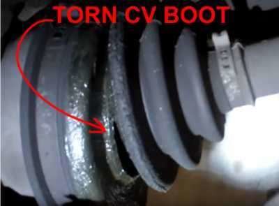

    This is what a torn boot looks like:

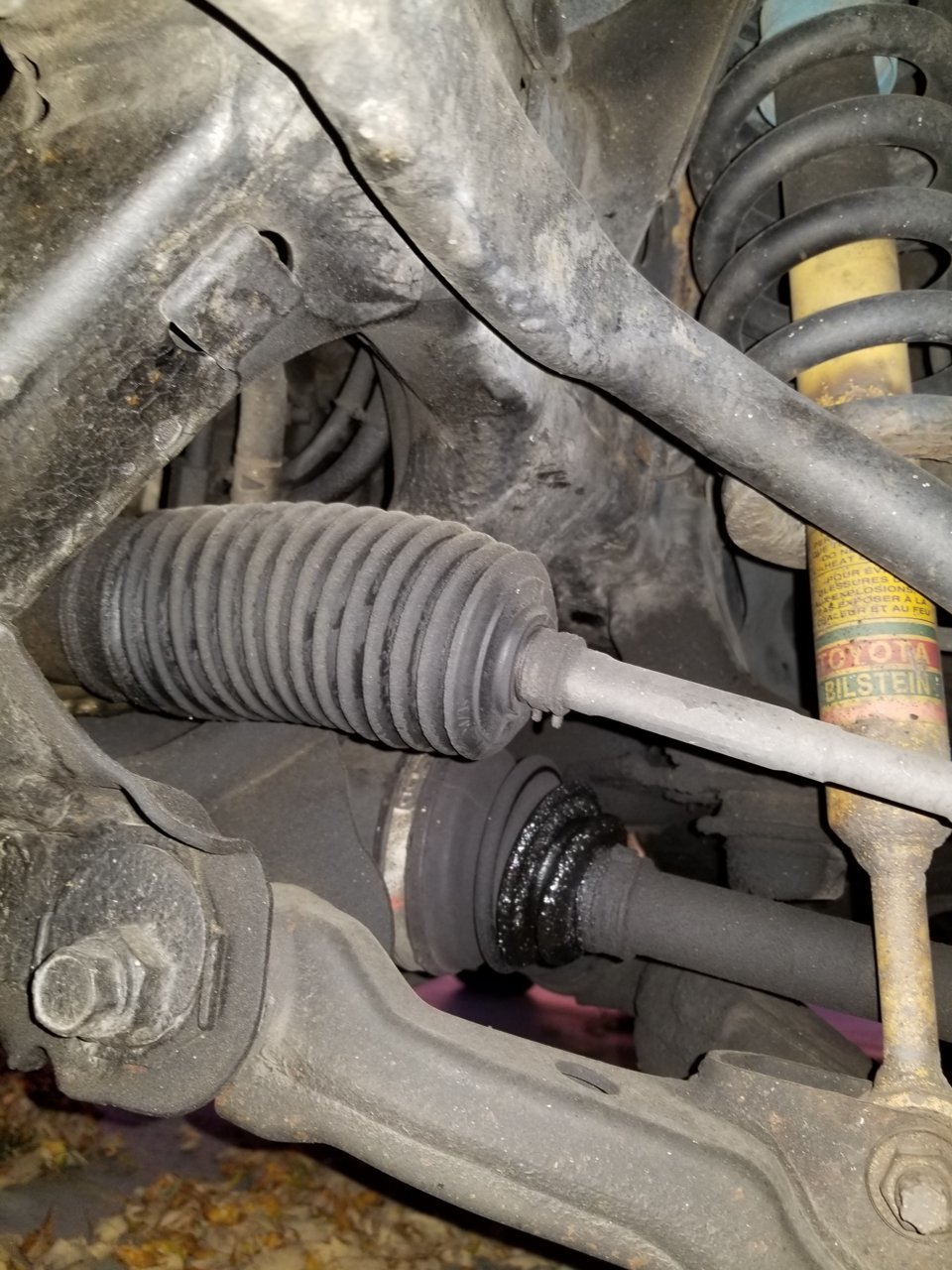

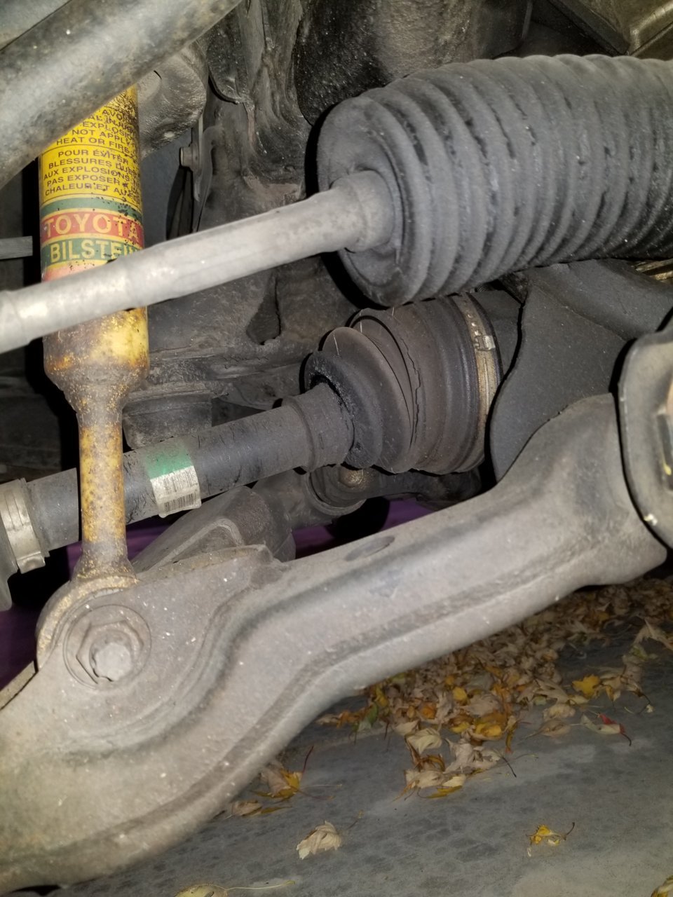

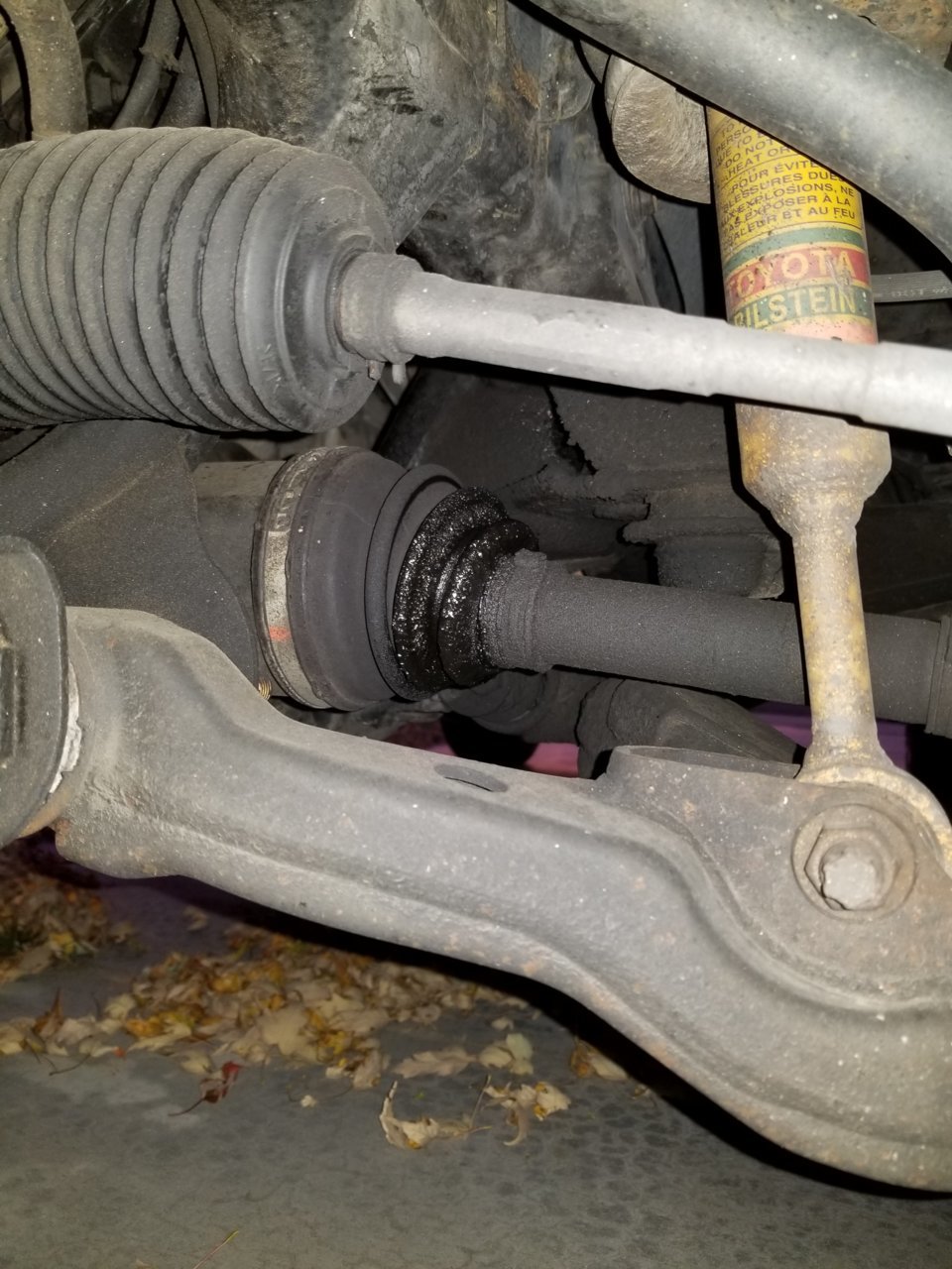

    I see nothing serious as Josh stated a boot is a quick fix as long as it’s greased good. If you can swing it I’d just go ahead and replace it for peace of mind. The carrier bearing can be replaced fairly easy as well and the parts themselves are not terribly pricey.
    I know you stated your brother usually helps you try to coordinate a day with him and bribe him with food/beer. As for acquiring the parts I’m sure we can help you with that.
    If your truck isn’t making any weird noises or Vibes just ride with it but with winter coming up I’d address the CV first.

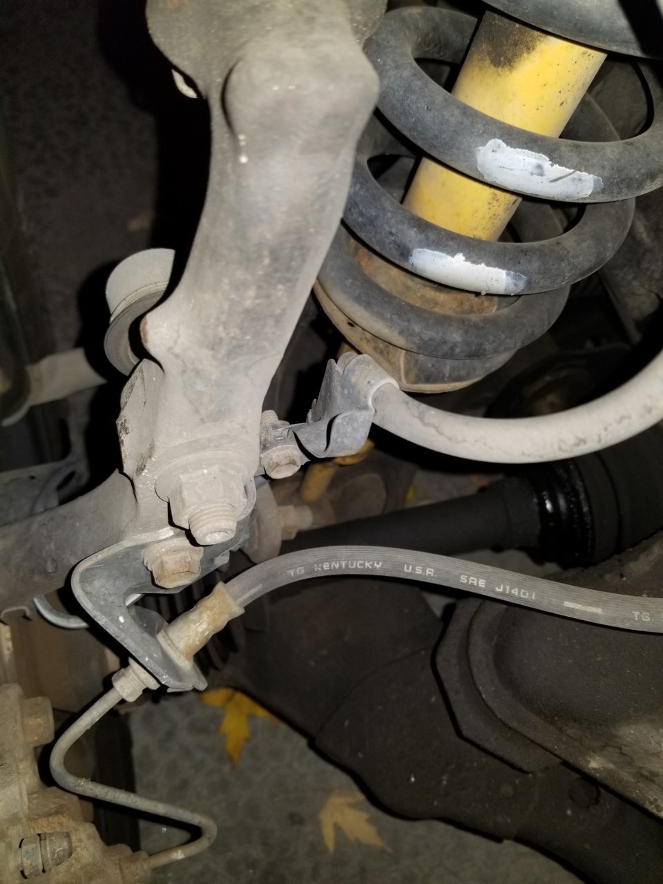

    These are the best I can get right now
    Passenger side
    Drivers side

    From the front? Sounds like the cv they will do that or maybe a wheel hub assembly.
