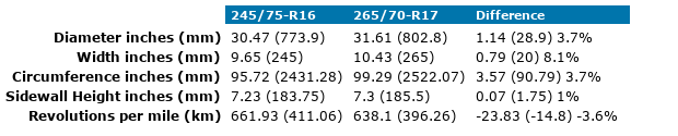

    So I'm looking into just hopping up to the 265/70/17's but was wondering if jummmping up just one size would mess up my milage reading?

    slightly. maybe one to two miles an hour I believe. Somebody has a handy dandy little chart I saw. I'll see if I can find it before they do. :D

    Look under the mods and tutorials tab at the top of the page and at the bottom of the list is this. You can plug in whatever you want and see what it does. Cant vouch for accuracy, but take it as you will.

    Current TireNew TireDifferenceDiameter inches (mm)30.47 (773.9)31.61 (802.8)1.14 (28.9) 3.7%Width inches (mm)9.65 (245)10.43 (265)0.78 (20) 8.1%Circum. inches (mm)95.72 (2431.28)99.29 (2522.07)3.57 (90.79) 3.7%Sidewall Height inches (mm)7.23 (183.75)7.3 (185.5)0.07 (1.75) 1%Revolutions per mile (km)661.93 (411.31)638.1 (396.5)-23.83 (-14.81) -3.6%Forum embed code (copy & paste in your post): [​IMG]from the online tire size calculator
    Speedometer DifferenceSpeedo ReadingActual Speed20 mph (32.19 km/h)20.75 mph (33.39 km/h)25 mph (40.23 km/h)25.93 mph (41.74 km/h)30 mph (48.28 km/h)31.12 mph (50.08 km/h)35 mph (56.33 km/h)36.31 mph (58.43 km/h)40 mph (64.37 km/h)41.49 mph (66.78 km/h)45 mph (72.42 km/h)46.68 mph (75.13 km/h)50 mph (80.47 km/h)51.87 mph (83.47 km/h)55 mph (88.51 km/h)57.05 mph (91.82 km/h)60 mph (96.56 km/h)62.24 mph (100.17 km/h)65 mph (104.61 km/h)67.43 mph (108.51 km/h)Speedometer forum embed code: [​IMG]from the tire calculator

    Ya I seen the chart and heard that if you hop up one size it actuall corrects the speedo.I was talking about how many actual miles are on the vehicle

    Yes it will mess up your odometer, making it appear that there are less miles on the vehicle than actually true. By going up to that size, you will be off by ~3.3%
