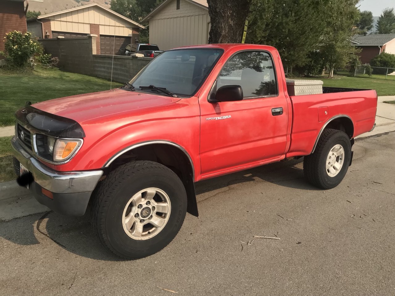

    I have 31x10.5r15LT with no lift. The last time I got new tires (on a different truck, I’ve only owned this for 6 months) the tire place told me the max size of tire they could put on my truck. Worth heading to a Discount Tire or something and asking

    Thanks beikokupilot ! Those look great! Yup Just what I wanted to see!

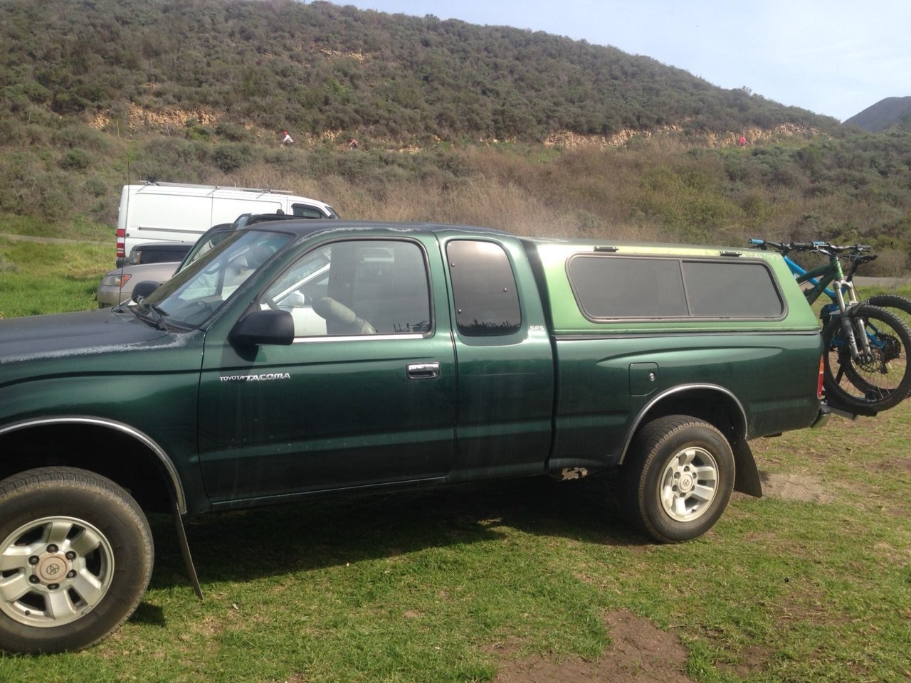

    technically you can "fit" 32" tires in there (32x11.5x15) but you may not want to. the suspension looks like it has seen most of its life and may be worn out :(
    depending on what engine and axle ratio you have it may kill the fun/power of the truck by going larger
    look at the sticker inside your door jamb and tell us the axle code, also 4cyl or 6cyl engine

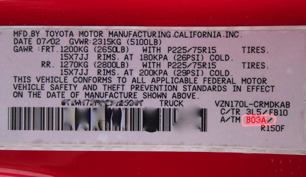

    Where is the axle code?

    I see you highlighted B03A on your sticker. Mine sticker also has B03A. This will help determine if I can put 30 or 31 tires? Sorry, but noob to any tires other than stock.

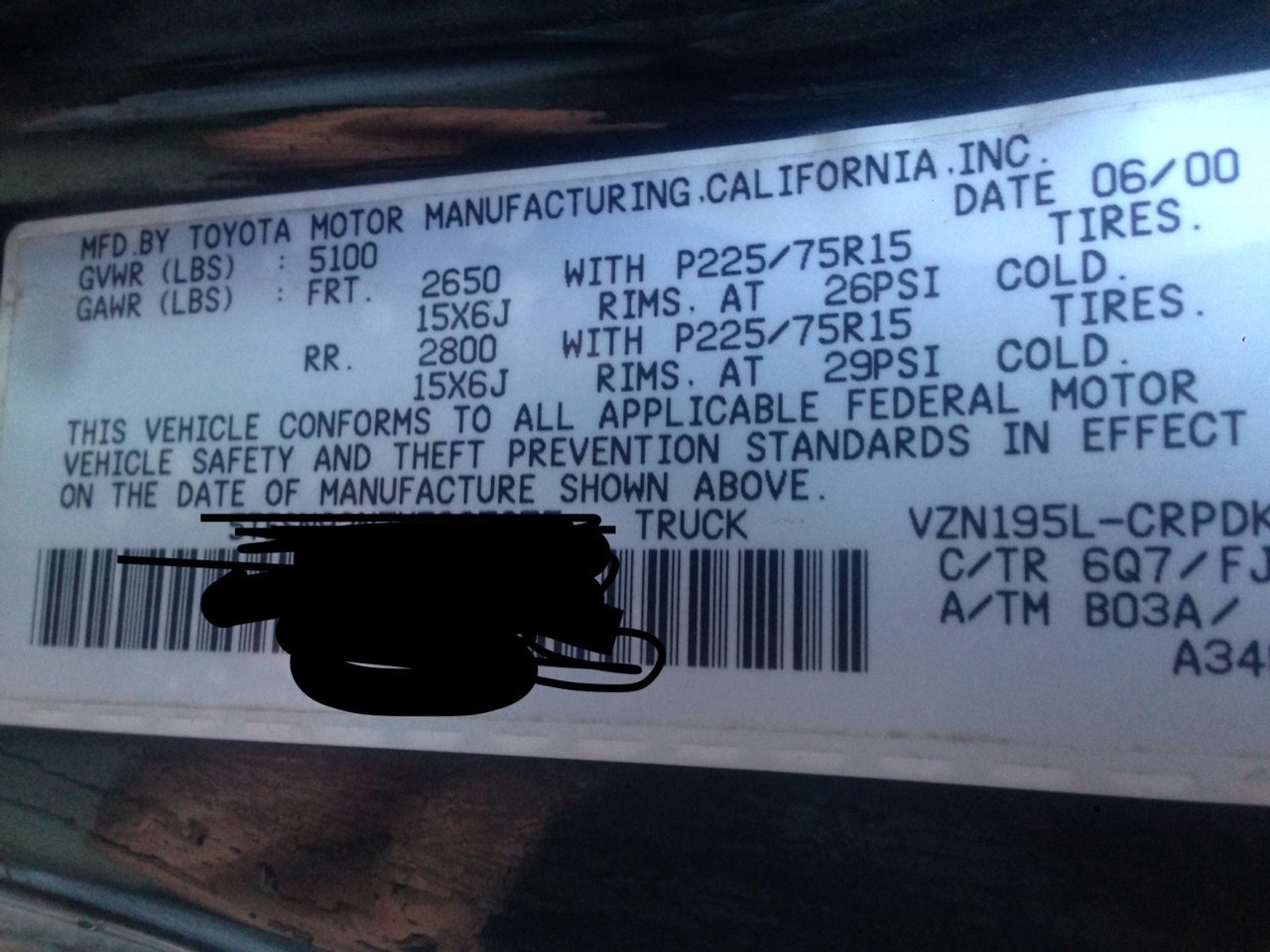

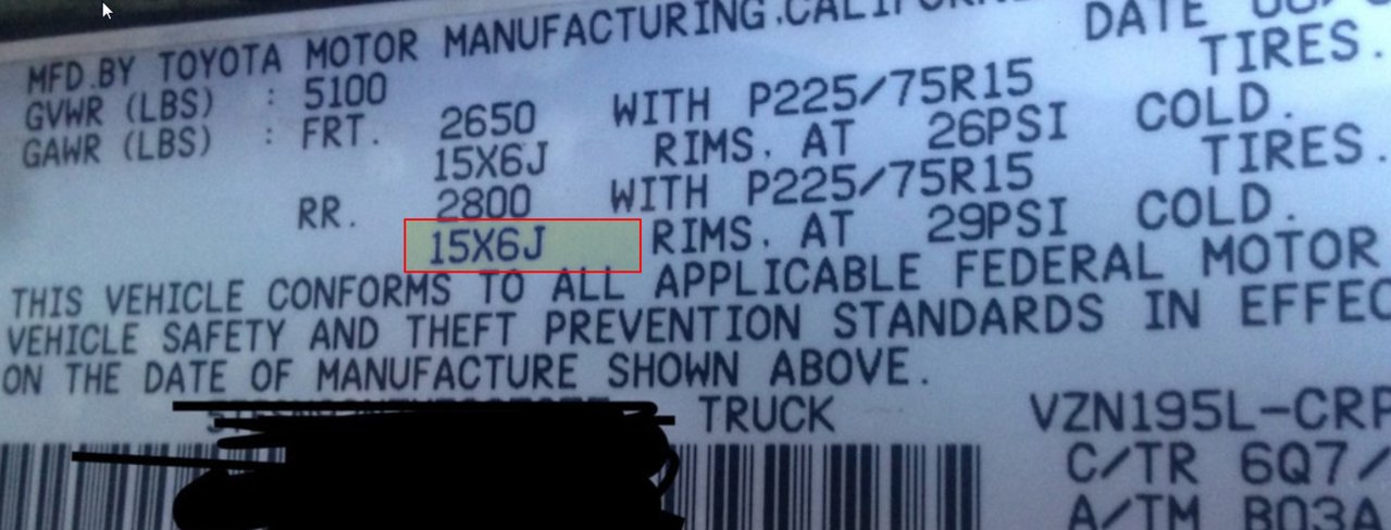

    On you sticker:
    If these are rims that you have now, they are 6 inch wide (same as I have) so nothing wider than 9.5 will not fit in there.

    B03A is the axle code. That means you have 4.10's, which will be more than fine for 32's. That's what I have stock, and I run 32's. A lot of people run 33's with 4.10 gears.
