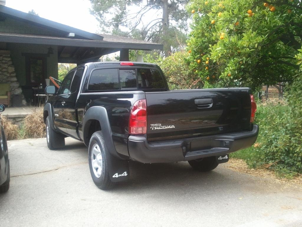

    so i got 245/75/r16 it looks a bit like the wheel well has a very large gap. What do you think? looking to go up slightly w/o loosing mpg (or minimal) hmm..

    going up to 265/75/16 isn't too bad. they are only an inch taller overall and a 20mm wider. I lost a mpg or two at worst. if you off-road much it is the best improvement you can make. they fill up the wheel wells nicely. I ran like that for a while before I lifted
    this is how it looks at stock height

  10. Apr 13, 2013 at 11:40 AM
    yellowdotz
    yellowdotz [OP] Well-Known Member
    Apr 13, 2013
    #101982
    69
    SiNNeR
    Pasadena, CA
    13 tacoma i42.7L 4x4 manual access
    this is how it looks at stock height[/QUOTE]
    looks good.
    how big was your lift?
    keep in mind ur truck has more power than mine. I have to worry about weather or not my 4 banger can handle it properly as im assuming torque goes down the bigger the wheels get.
