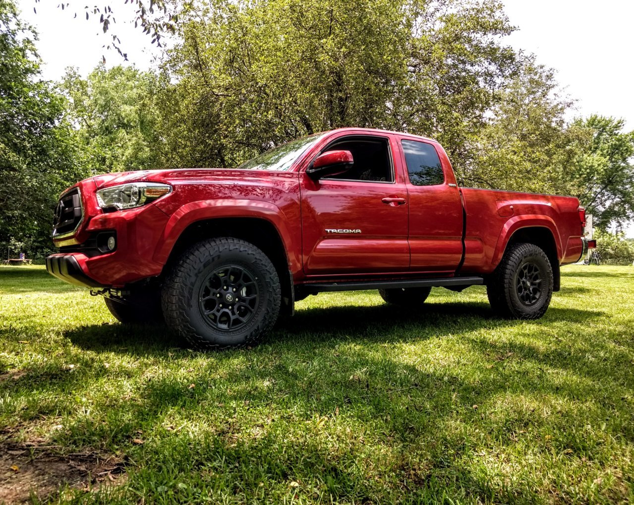

    Wildpeaks 265/75 16.
    Stock suspension on my SR5 and doesn't rub on anything.
    Really great in the rain lately.
    I live on miles of gravel and they don't hold rocks to throw out later on pavement.
    OEM mudflaps and running boards...it's exactly as I wanted.
    Best of luck with whatever you get - researching and hunting down the extra 'stuff' is easy and fun with these trucks.My truck!.jpg
