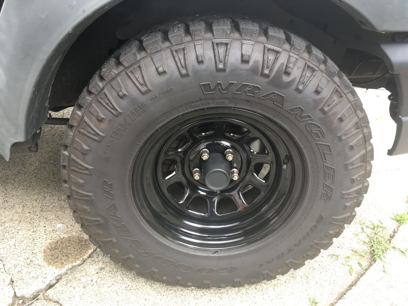

    Some Serious Tires
    265/75/16
    255/85/16
    235/85/16
    285/75/16 will fit with the right alignment.
    FYI, lift on Toyota Ifs does not allow for taller tires unless you plan to drive in straight line and never cycle your suspension.

    I would highly recommend 255/85/16 (33x10) the only problem most of them are Mud terrains.
    I’m running 255/80/17. A lot more AT options in 17” size. Or you could always stick to most popular 265/75/16, also awesome size, 31.6x10.4
