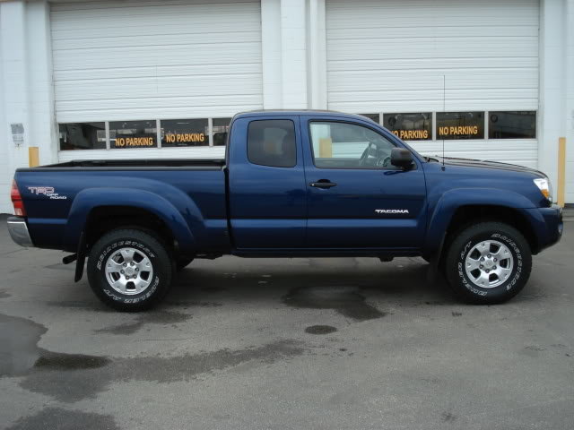

    Thanks jolayiv, does anyone have a pic of how they would look?

    You can stuff 285/75/16s with a little bit of trimming like I have... Otherwise, 265/75/16s are all you can fit with no lift. :cool:
