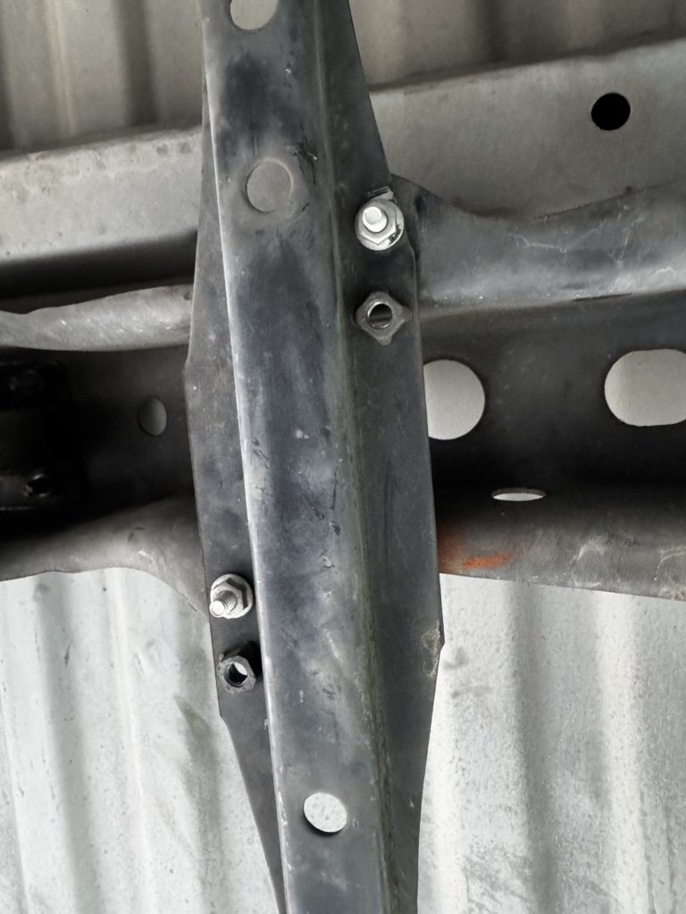

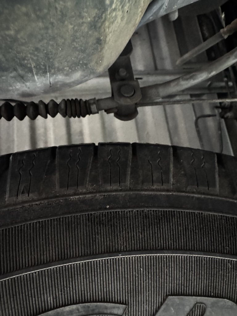

  5. Nov 29, 2024 at 8:59 PM
    #25
    bazzoozzab
    bazzoozzab New Member
    Sep 29, 2024
    #457881
    2
    2001 Single Cab 4X4 MT 2.7L
    I tried putting a 265/75-16 and it was touching the axle. I modified the stock bracket by drilling new holes and moving it back one inch. My stock tire was 265/70-16. This is on a regular cab with 6' bed and no tow hitch.
