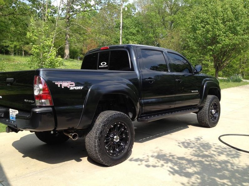

    Hey everyone... I have question that I haven't been able to easily find and I'm sure I'm not the only one who has asked this.. I have a 2009 double cab trd sport and I'm putting a 3 in. toytect lift on. I've decided to go with 18x9 XD Hoss wheels and the seller I'm dealing with suggested 325/60/18 for the tire size. I wasn't sure if I would be able to put this size tire on without any mods or rubbing? If so, does anyone have a suggestion for a good tire size? I'd appreciate any insight.
    Thanks guys
  12. Apr 13, 2012 at 8:32 AM
    #232
    TexasTacoma37
    TexasTacoma37 Well-Known Member
    Sep 3, 2009
    #22227
    31,174
    Welcome to TW. Those tires are going to rub like crazy. Even a 285/65/18 will rub slightly but a lot of people on here run those.
    If you want absolutely no rubbing, you have to stick to 265/65/18.

    Thought I'd share... I ended up going with 285/60/18- no rub at all.

    Looks good. That's my next tire size.
