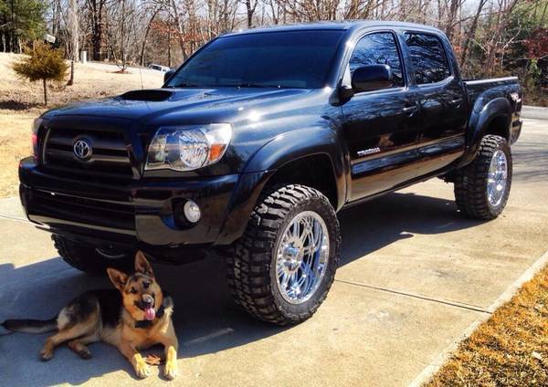

    3 inch Readylift,17x9 Mickey Thompson Sidebitter wheels and Baja MTZ Tires , Window Tint, Black Emblems/ Decals ,In channel VentShades , 23 inch LED light bar, Black Nerf bars and Bull bar Shorty Antenna , TOY black 3rd brake light cover
    265x70x17 are perfect with 2.75 lift front and 2.00 inch rear
