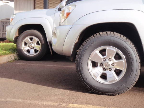

    Just put on some Bridgestone Deuler AT in 265/70/17. That is how the stock truck should look!!! Very happy.. Costco went ahead with a "test fit" to see if it would clear before mounting (because I went up from the 65s). Took them 3 1/2 hours to get it done, but happy that I could get it done with them (price and free balance/rotate)
    Now for a small lift via 5100's.. and I'll be good to go..

    Took a pic yesterday at work. Co worker has same truck in a earlier year..

    Looks great, no rubbing at all?

    No rubbing at all.. gave the truck a very small ~1" or so lift as well..
    No.. not the revo 2s..These are the regular ATs They would have had to special order them at Costco.. I do like the look of the revos, (a little more offroad/agressive look), but like the guy said, may have a bit more road noise in the long run..
    Gonna put on my "small lift" on friday.. 5100's set at 1.75 and 1.5" fabtch aal.. will have some pics of the 265/70/17s with the lift later.. hope it doesn't look silly..
