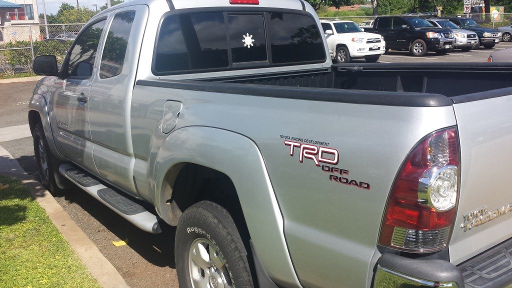

    Hi guys
    Can I use Goodyear duratrac 265/75r16
    On my 2009 tacoma trd offroad prerunner? Without any issues? 20141121_113021_zps198ec8ac_93c23f1df84a40113a7e0a3f4bd9dfc25c96c6da.jpg
  14. Nov 21, 2014 at 5:14 PM
    #394
    colbyrainey
    colbyrainey Well-Known Member
    Sep 22, 2013
    #113049
    324
    Colby
    KC
    '11 Dbl TRD Sport
    TSB Leafs, Bilstein 5100's @ 1.75", K&N Filter, Kenwood DNX 6180, BFG Rugged Terrain T/A's, ImMrYo Rearview Mirror Bracket, Extra D-Rings, Gloss Black Stock Wheels, Grillcraft Grille
    Yup!
  15. Nov 21, 2014 at 11:55 PM
    #395
    hardrive
    hardrive New Member
    Aug 24, 2013
    #111109
    3
    mike
    hawaii
    09 tacoma trd sr5 offroad
    No rubbing of any kind? If I use this tires?
  16. Nov 22, 2014 at 10:36 AM
    #396
    TacoDeLaPlaya
    TacoDeLaPlaya Total Automotive Performance Sleeper Cell
    Apr 15, 2013
    #102133
    927
    Bobby
    Del Mar, CA
    06 Silver Access cab
    Custom sotoshi deep dish grill 6112 front 5100 rear Leer 100xl
    You will be fine. No rubbing
  17. Nov 22, 2014 at 10:39 AM
    #397
    hardrive
    hardrive New Member
    Aug 24, 2013
    #111109
    3
    mike
    hawaii
    Thanx taco
    I guess im going to get this tires
