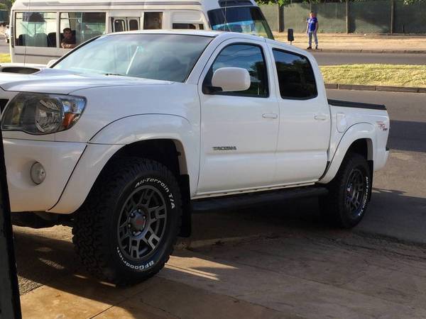

    Marcio LK
    Santa Cruz de La Sierra - Bolivia
    Tacoma TRD Sport
    Custom leather interior

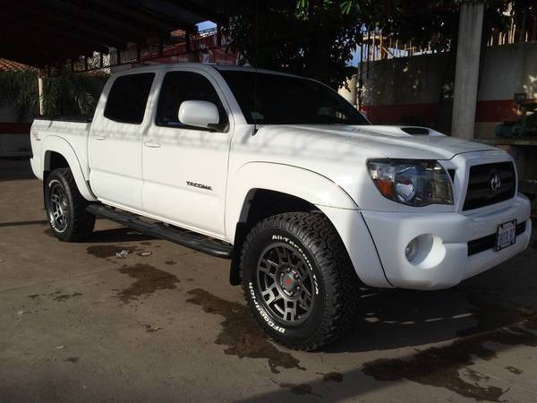

    Marcio LK
    Tacoma TRD Sport
