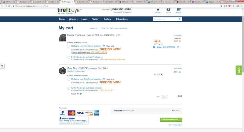

    New to posting in TW but not new to reading all the great info on here, so thank you very much to all of you out there who have helped thus far. I am looking to put new wheels and tires on my 09 dbl cab 4x4 TRD Sport (6ft bed if that matters) below is what I am looking at getting and I am wondering if I will have any rub issues. I really don't want to do any cutting. My truck is stock, no mods or lift. If this will fit, could I go with a taller or wider tire or is this pushing it as is? Oh, these wheels have a 0 offset which I'm pretty sure with an 8.5 rim will give me 4.75" BS and I know that with my current stock wheels I have 5.5" BS, b/c of that I know the inner rim should sit about 17.3mm further away from the strut. Will that be an issue? Will I need spacers or anything else to make this work? Thanks in advance and I appreciate all the feedback. I can't seem to make the image any bigger, the tires are MT MTZP3 265/70/17 and the Rim is 17x8.5
