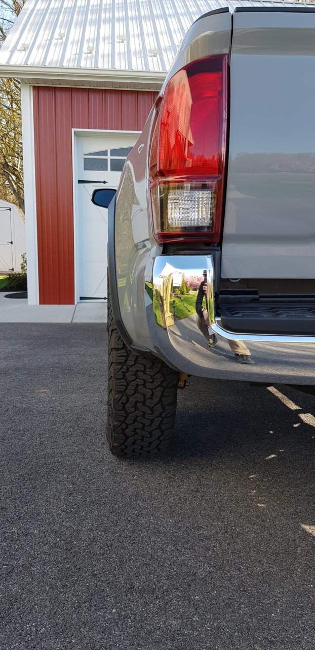

    Do you have any more pics of the wheel & tire setup? Specifically from the back or front? I'm looking to get this exact same setup on my new Tacoma and I'm curious how far it sticks out of the fender well, if it sticks out at all.

    Here are a couple pictures for you. I am still running stock suspension. 20200422_170612.jpg 20200422_170640.jpg 20200422_170654.jpg
