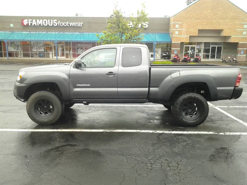

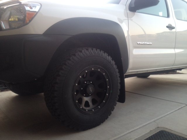

    Not all the way true, unless every trucks dimensions are not spot on. Here are 265/75/16's BFG AT-KO's on bone stock suspension. They rubbed on the inside of the inner fender flair and mudguards. Also on that small mini mud guard thing that hangs down from front bumper. I trimmed about 1/2 and inch from the plastic flares, and the inside of the mudguard, and also removed the small mini mud guard things in front of the bumper and no there is no rub.
    *Tire shop did say, if I got same size tire in say a Michelin MS2 or anything less aggressive than the BFG, AT it would not rub. If it means anything, my wheel offset is -6.

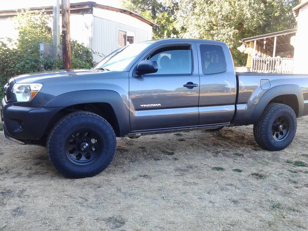

    265/75/16 on 4.5 BS fit on my stock suspension and only rubbed a little while turning left and going over a bump or rut, nothing to worry about. IMO, this size looks good with or without a lift.

    This could be the reason. I got the Firestone Destination A/T. Looking at your pics mine do not look that aggressive.
