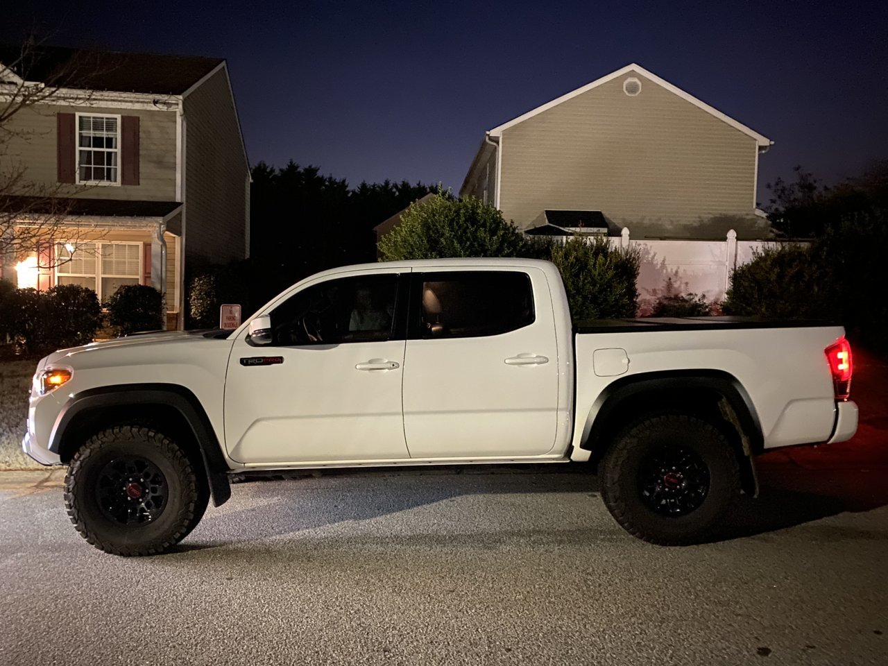

    07A61346-4F34-46CD-8085-53FE26DF2C92.jpg ko2s

    Love the look of your truck. I like K02s. I’m probably going with Cooper ST Maxx in 285s because of how quiet they are on the road. I use Bluetooth phone on CarPlay a lot for work calls while I’m driving.

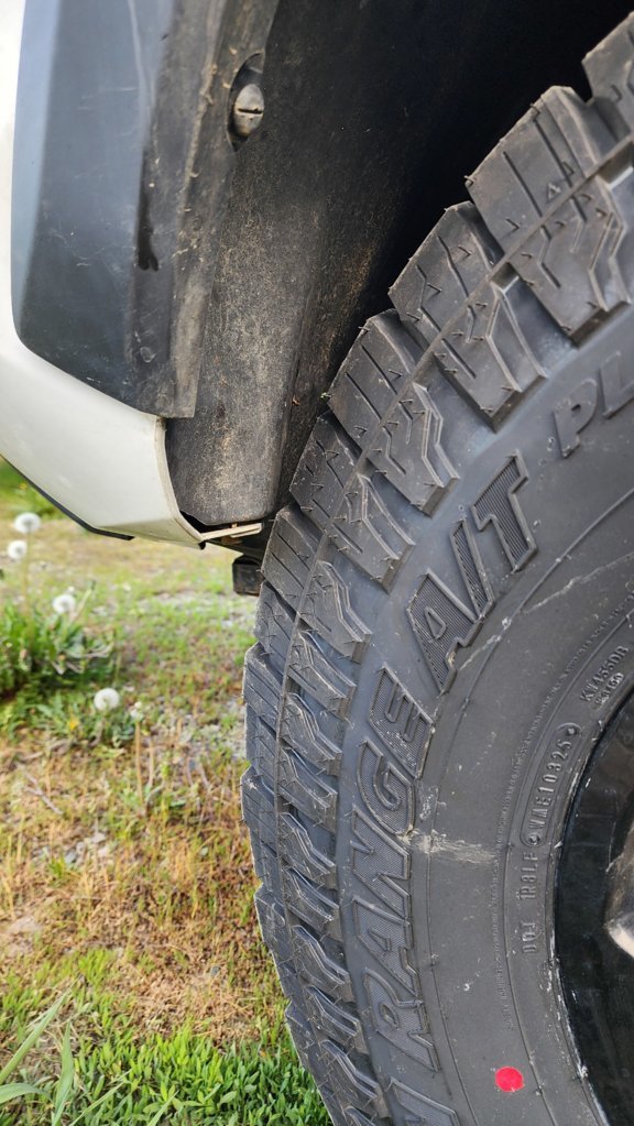

    I know I am digging up an older thread.
    However, since this thread helped me in my decision, I figured that I would post my experience to it as well to possibly help another TRD Pro Tacoma owner that reads through it.
    To set a baseline, my 2019 Tacoma TRD Pro was 100% stock. This truck is my daily driver and spends 90% on pavement, 10% on gravel forest service roads in the Cascade mountains.
    Note that the 90% pavement time is all seasons with 40% of that on snowy mountain paved/plowed roads.
    I needed new tires so I started researching what might be a good fit for me, hence this thread. Thank you to all who have contributed so far.
    My personal decision was to go with some Mazama Open Range A/T 285/75/R16s on the stock 2019 16" TRD Pro rims. No other modifications from stock yet.
    My conclusion is that most everyone on this thread was actually correct.... :) They do fit. AND they will rub on plastic if you drive on anything other than straight pavement.
    Sitting in my driveway, the rear tires are free and clear and will probably never touch the truck with any compression the land may throw at it.
    The front tires have plenty of clearance when straight, but any compression at two specific turned angles will certainly touch plastic at both forward and back points of the tire in that front wheel well.
    Now the front touch points are exactly what I expected and easily remediated with a heat gun and some pressure, as many have suggested.

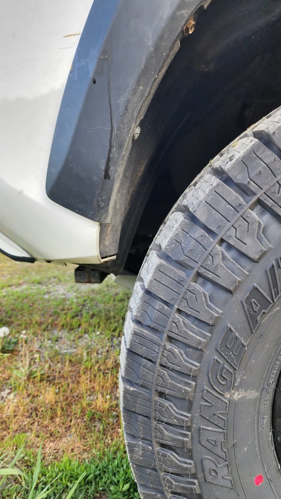

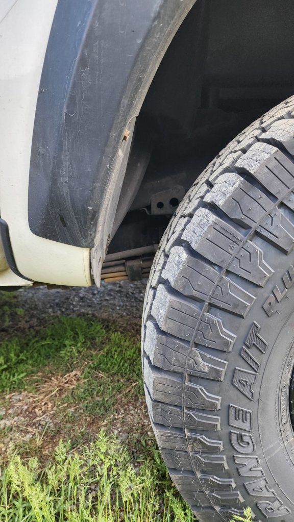

    Without any mods, here is my truck with 285/75/R16s on the rear left wheel:
    Forward:
    Back:
    Plenty of clearance on the rear, even with full compression.

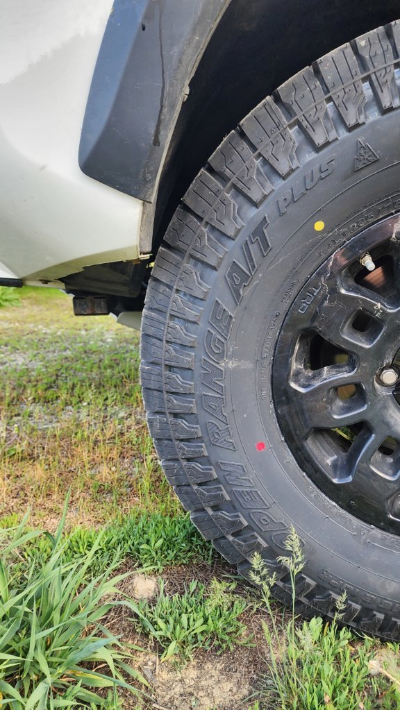

    Here is the Front Left wheel, straight and still:
    Forward:
    Back:
    All good so far...

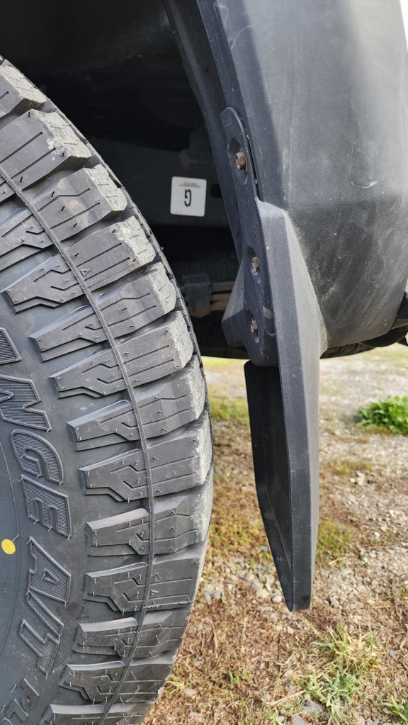

    Here is the Front Left wheel turned right 60%:
    Back:
    Maybe 1mm of clearance. but with any compression, it will rub on the mud flap at this turn angle.

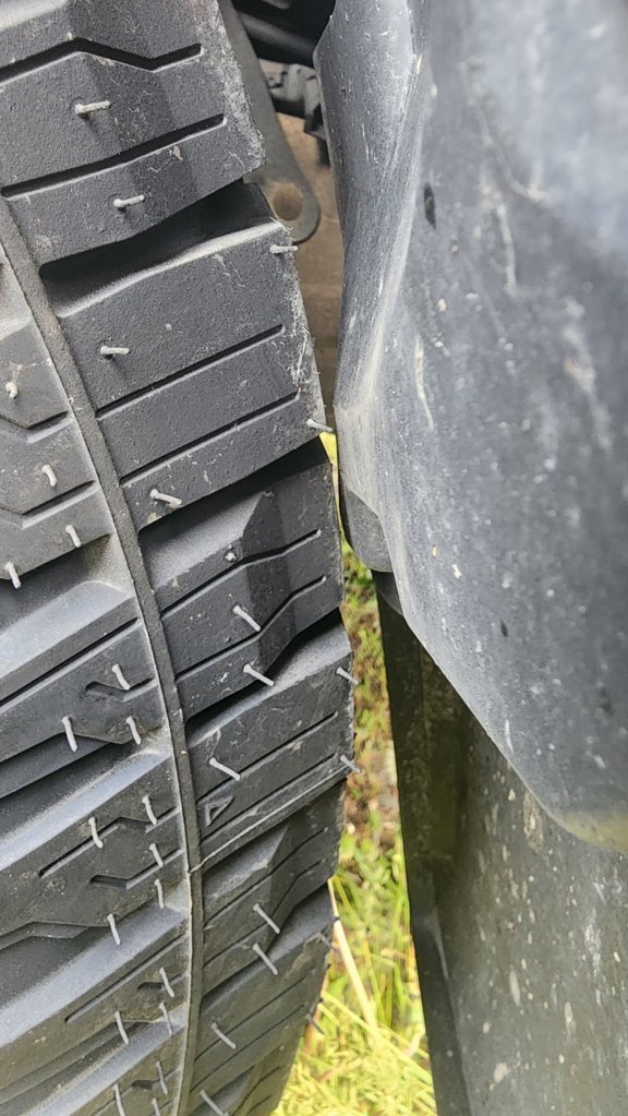

    Front Left Wheel turned right 40%:
    forward:
    Maybe 3mm of clearance but with any compression it will rub here as well.
    My conclusion...
    So far I am very happy with the 285/75s, as the look definitely compliments the truck and the traction is improved overall from stock tires. I will be heating up and applying pressure on those 4 points in the front plastic wheel wells to remediate the rubbing, but don't expect to have to do much more than that to run these for 50k + miles:). And I don't really care about the gas mileage, or speedometer being off a bit.
    Perhaps this will help others in deciding for themselves as well.
