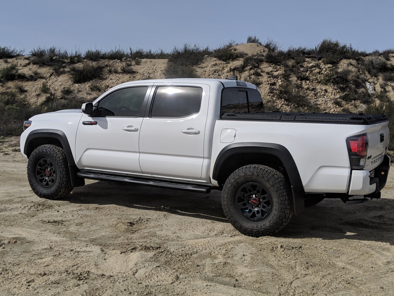

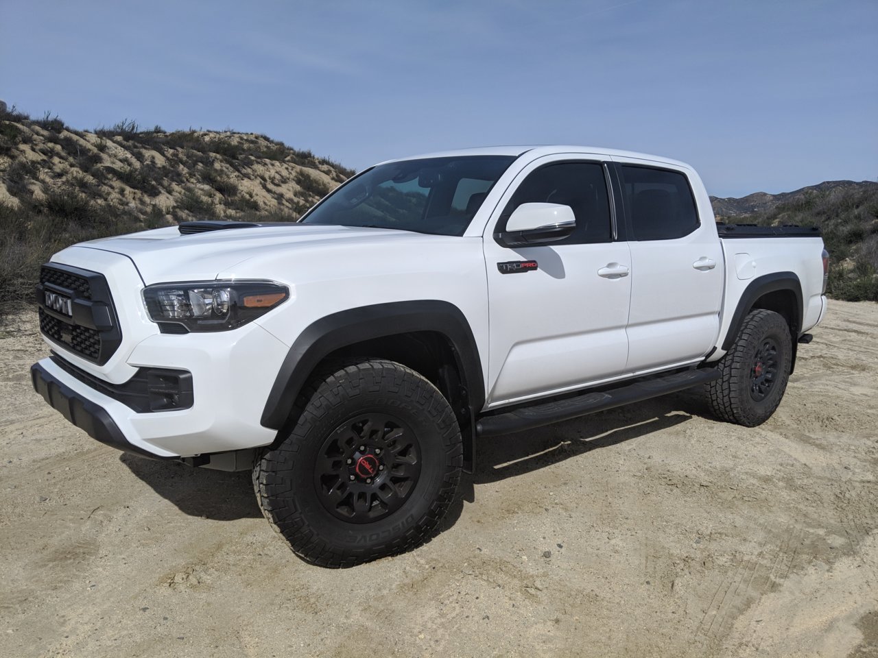

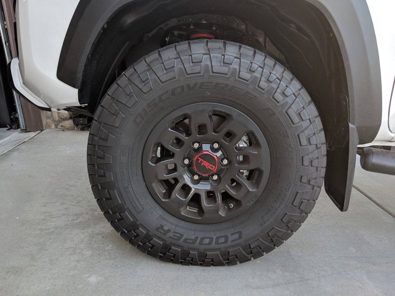

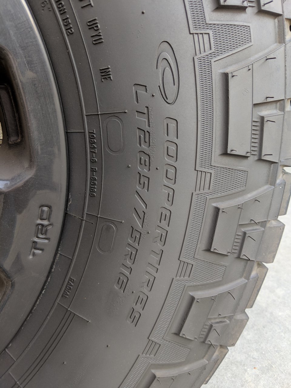

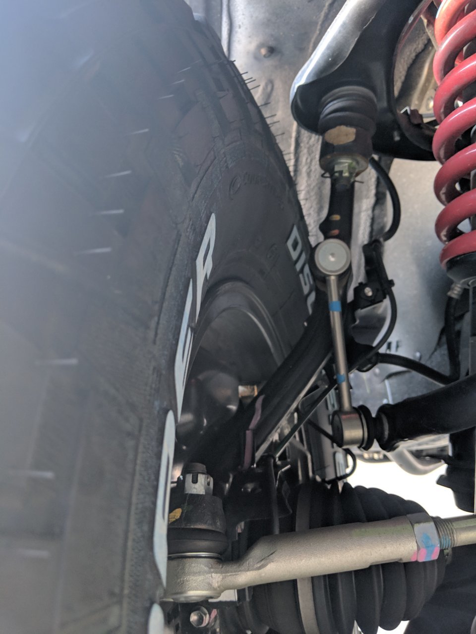

    No Rubbing on regular trails. I do wonder about mud flaps becoming an issue:notsure:
    tire pressure is about 36 Psi. Comparing Cooper AT3 to the Stock Goodyear I like Cooper's gives truck a better stance and little more ground clearance . Going to the larger size will cost you MPG and your speedo is about 3 mile mph under at 70 mph:cheers:

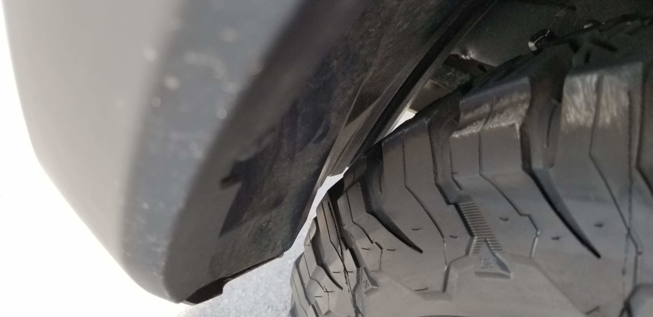

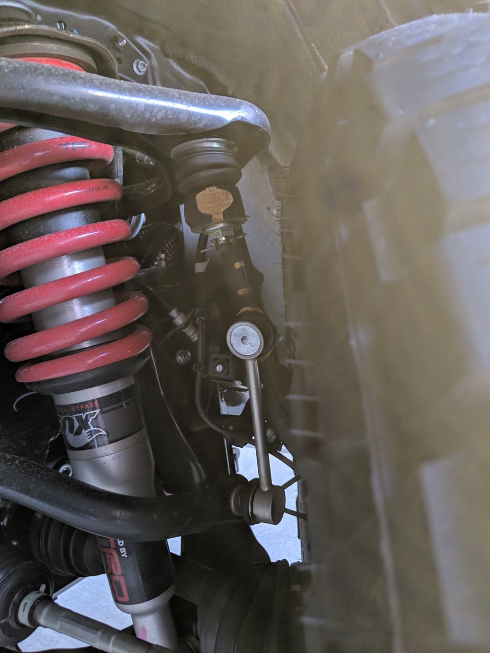

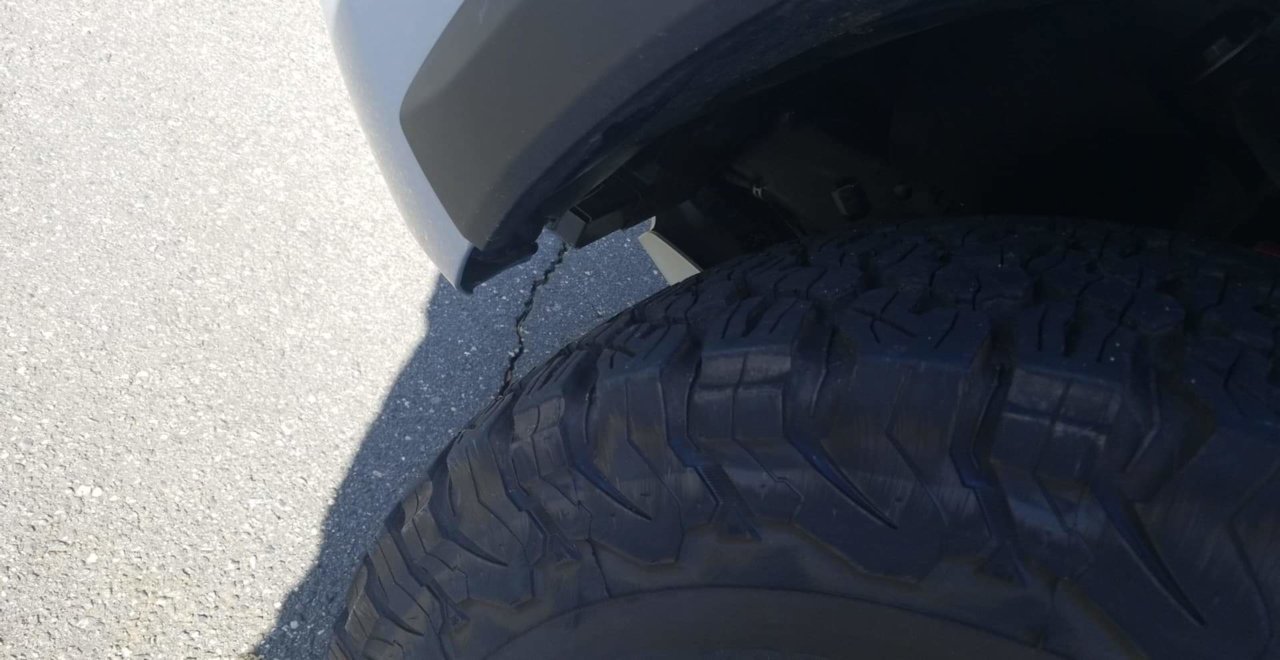

    You got a pick your wheel well by chance? I got the same truck as you.
  17. Feb 12, 2019 at 6:41 PM
    #97
    PJTACO
    PJTACO Well-Known Member
    Sep 24, 2018
    #267263
    322
    2017 Cement TRD PRO
    Before and after. These are the only 2 pics I have, it was more of an issue in the front.received_2203827269885242.jpg received_2160180860972336.jpg

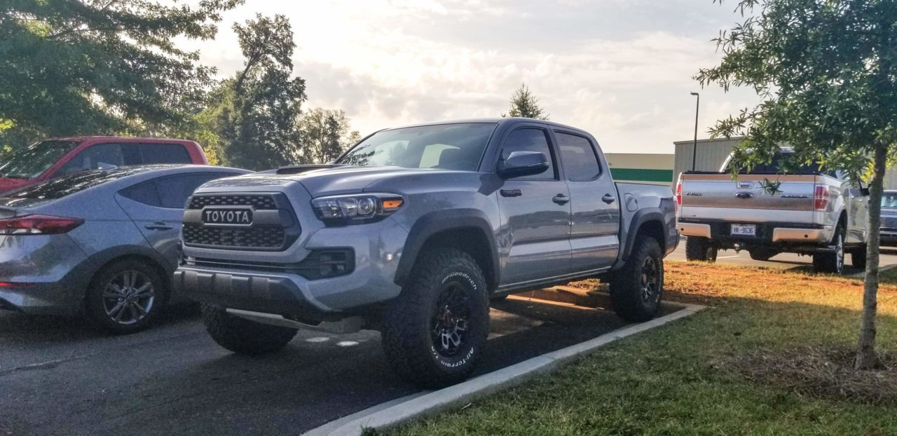

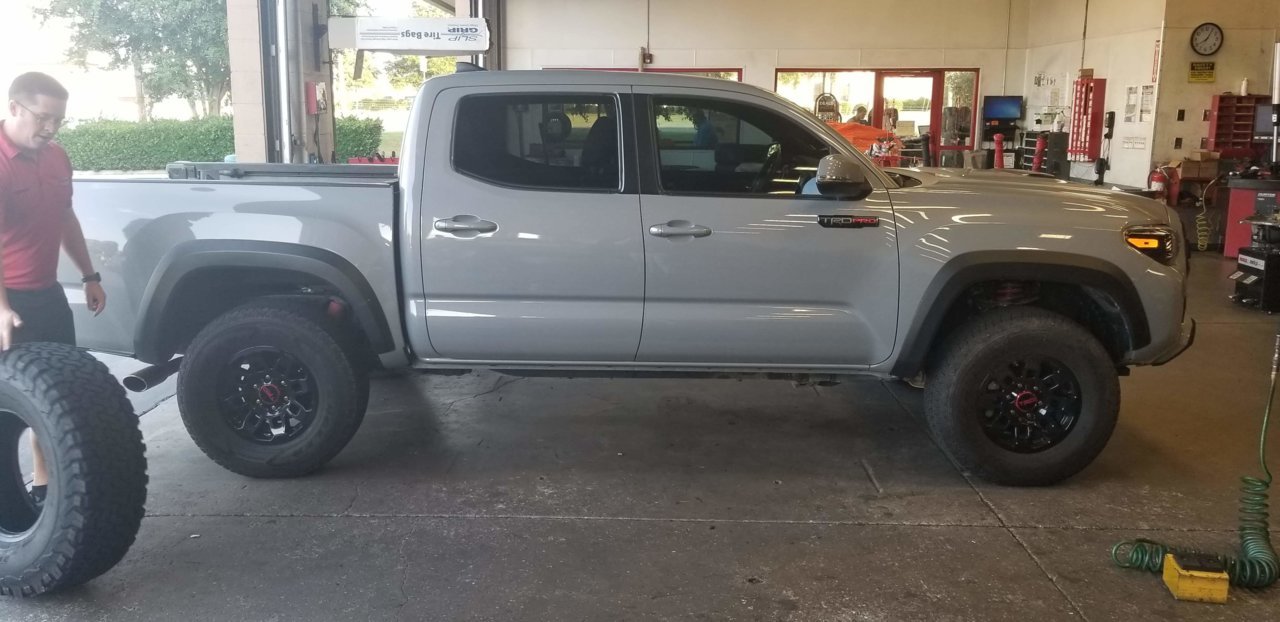

    And here's a before and after stock vs 285/75/16
