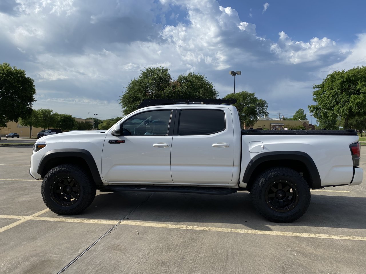

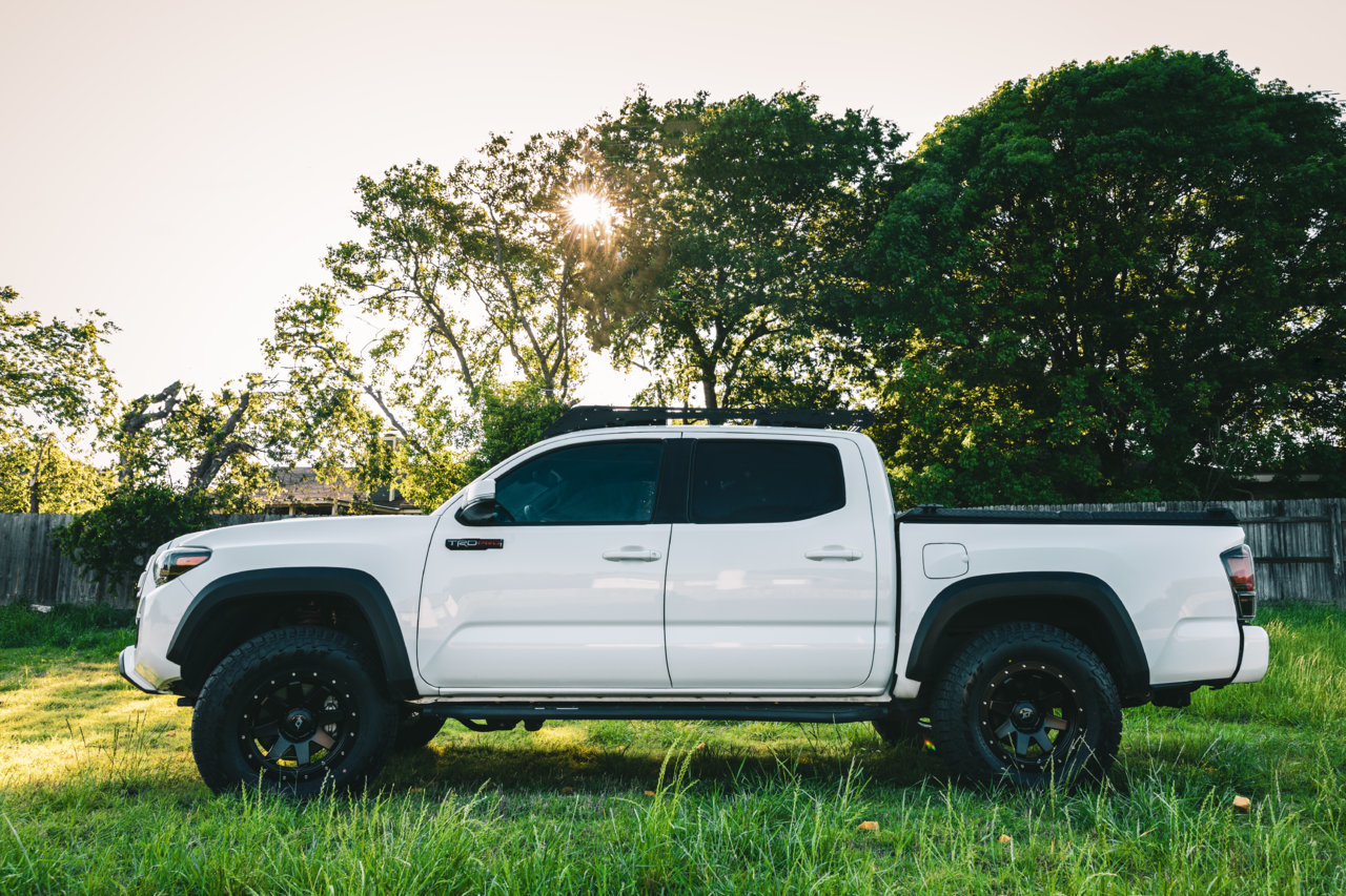

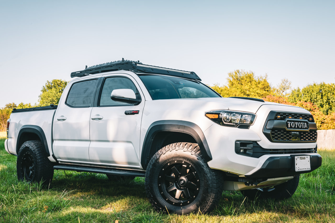

  12. Aug 18, 2020 at 5:26 AM
    #172
    PJTACO
    PJTACO Well-Known Member
    Sep 24, 2018
    #267263
    322
    2017 Cement TRD PRO
