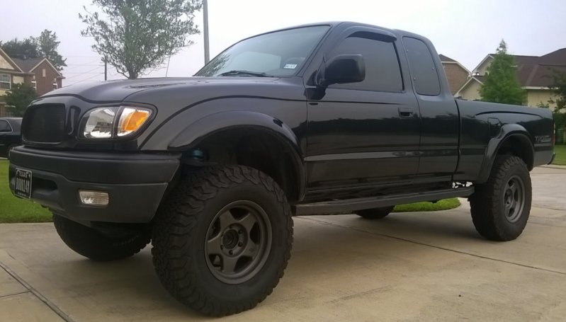

    Gen 1, 2.5" lift, 265/75/16, 4.5BS. No rubbing. Depending on your BS, I would think you'd be ok.
    Prior to lift, same wheels/tires rubbed ever so slightly at full lock but barely noticeable on road. Off road a bit more.

    Kings, SCS Wheels and other mall crawling crap
