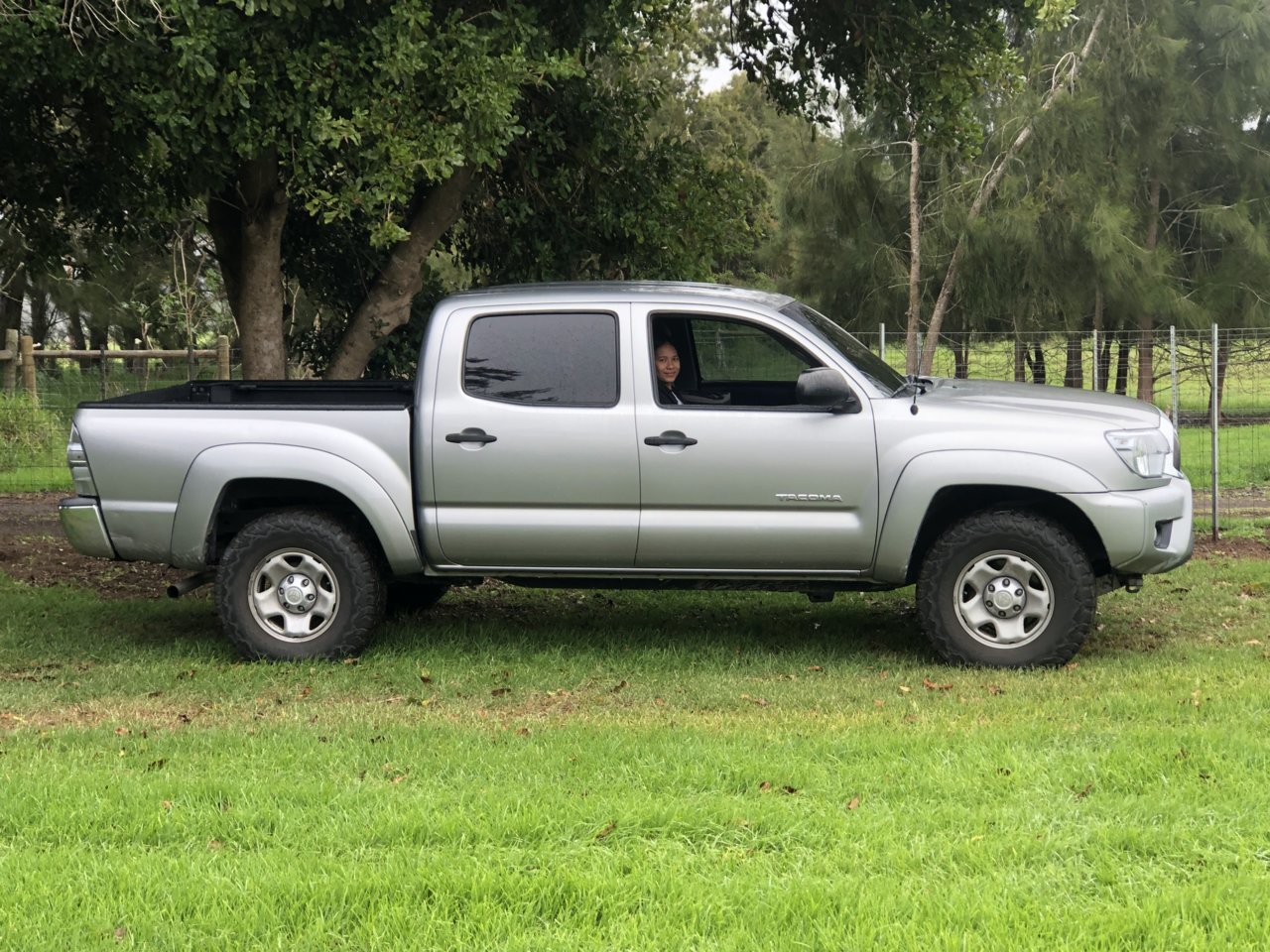

    94328FC2-84A5-46B0-BE95-BA9CC61D9936.jpg These are 265/75/r16 and I never had any problems with rubbing at all.

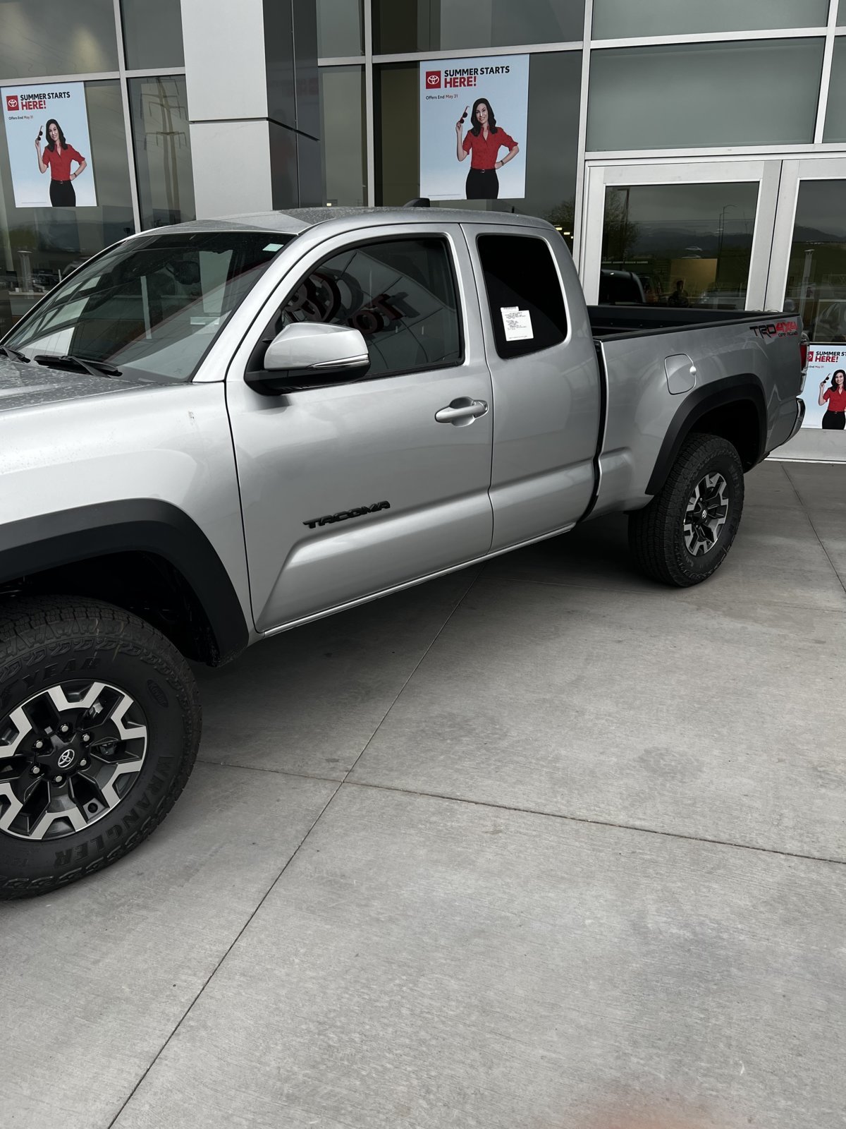

    First time poster: I am looking to purchase Method MR305 Wheels with BF Goodrich 265/75/16, C load rating for my 2020 TRD Off Road Stock suspension. Any issues with rubbing or anythign else?

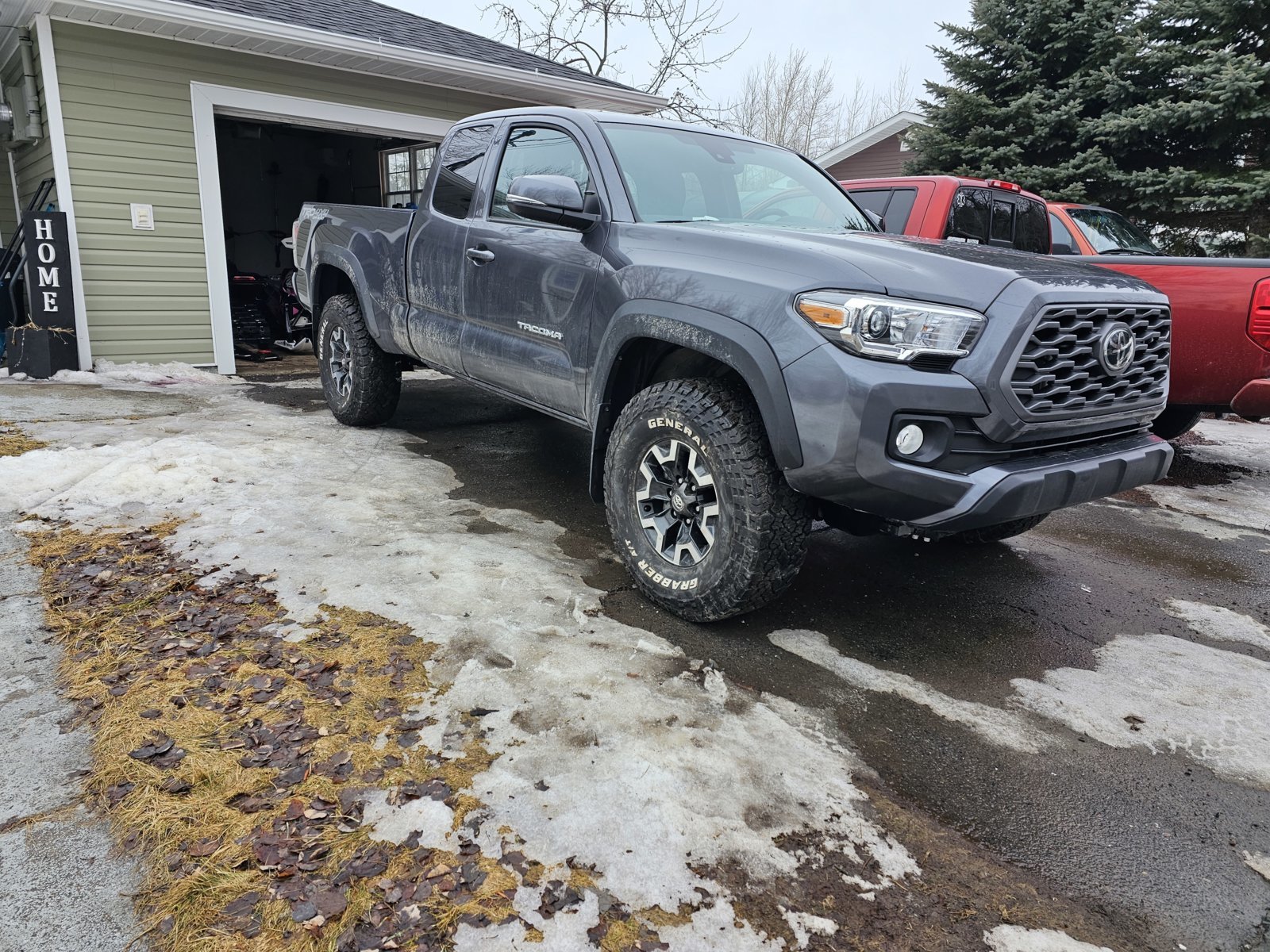

    itl be fine unless those wheels have crazy offset which i dont think methods do. heres my personal trd offroad bone stock with 285/75/16. just needed 3/4" wheel spacer to clear uca because stock wheels have alot of positive offset

    Thank you! It looks awesome. That is how i want mine to look, but with different wheels.
