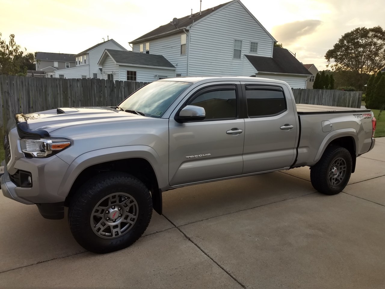

    I did this a last week. 265/70/17 toyo open country at2 in a SL rating. New trd pro Sema wheels. I did do the Bilstein 5100s and a 1 inch rear block. No rubbing, no vibrations, no harsh ride, quiet and zero issues! The tires and wheels weigh a little less than the factory sport wheels and tires. No decrease in gas mileage, calibration is dead accurate and I am completely satisfied.

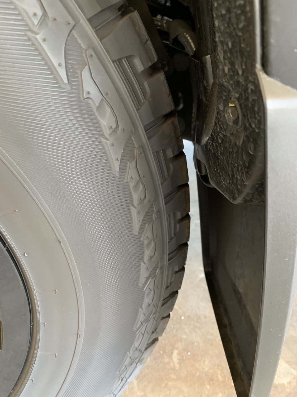

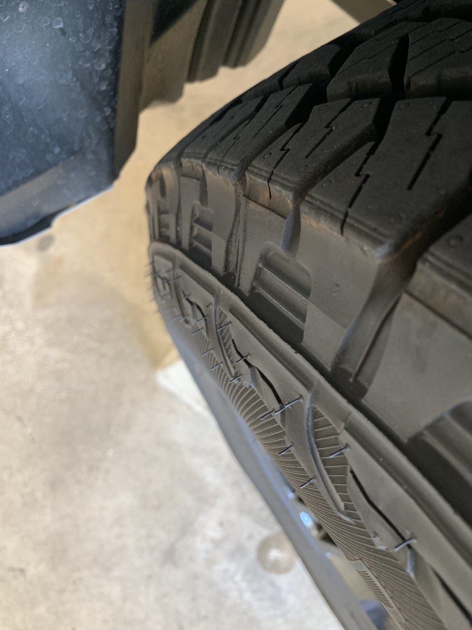

    19 OR: 265/70R17 Hankook Dynapro ATM with 17X8 0 offset. No rubbing.
    FullSizeRender-3 9.34.54 PM.jpg FullSizeRender-4.jpg IMG_6271.jpg IMG_6273.jpg
