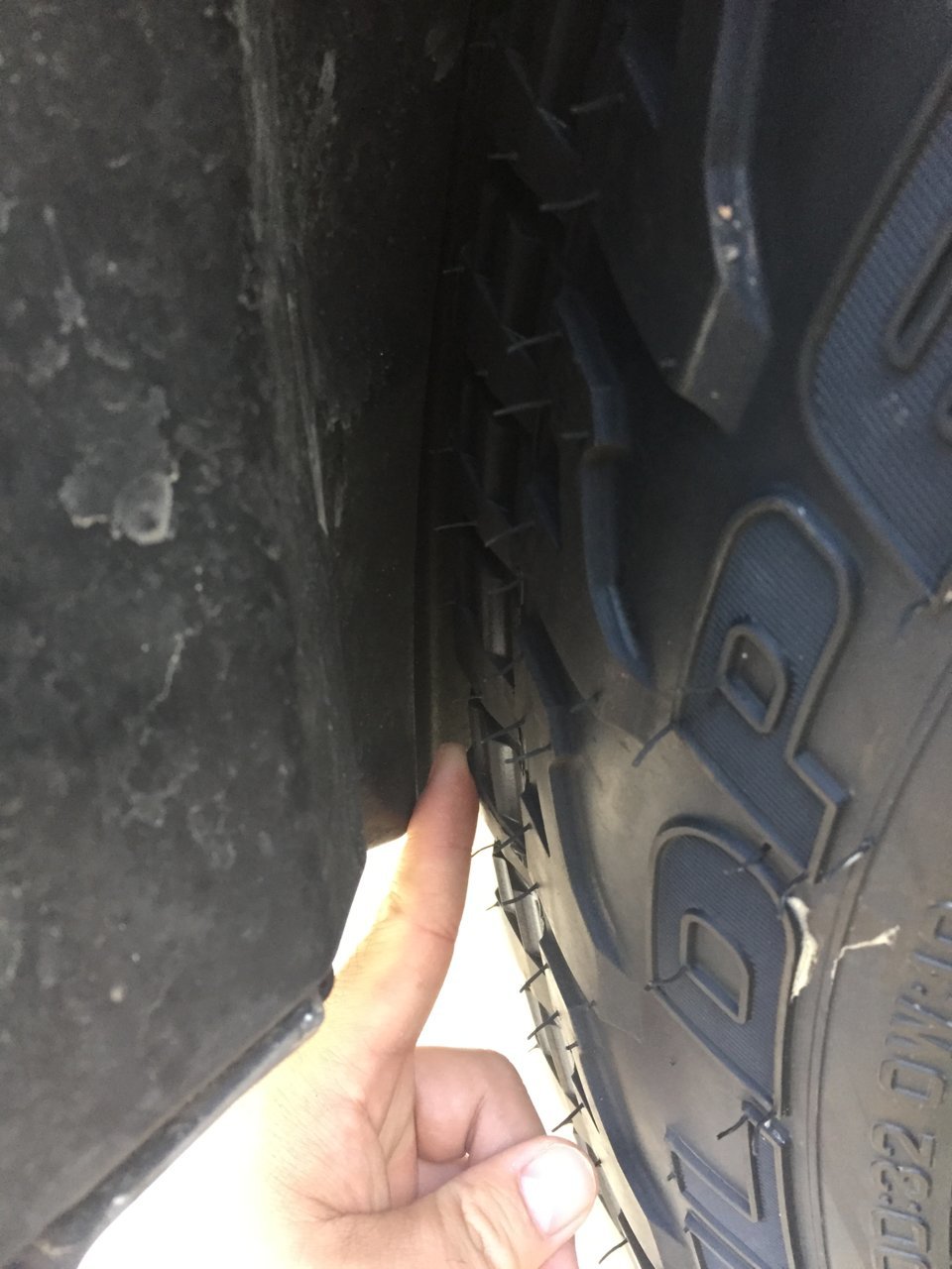

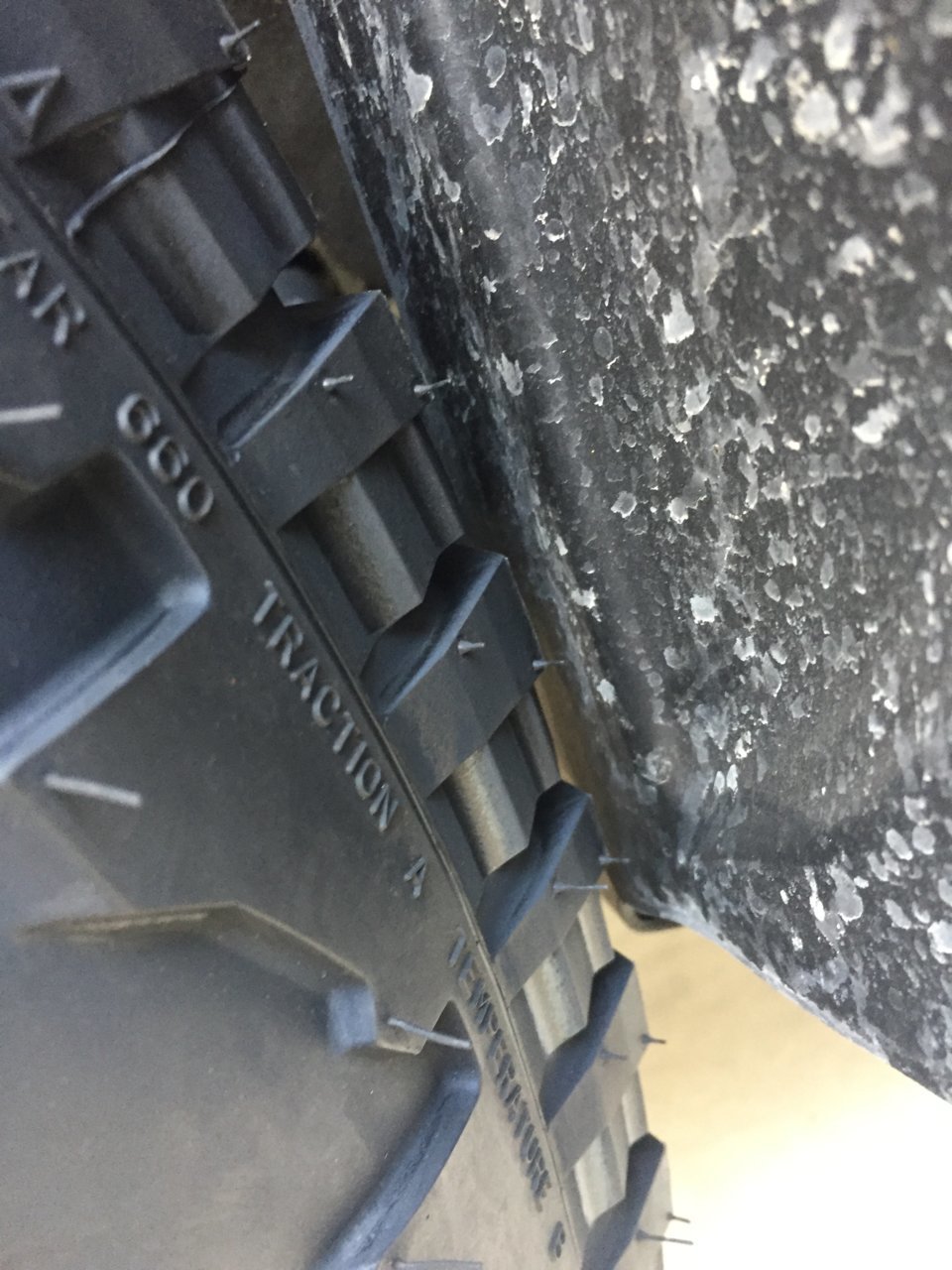

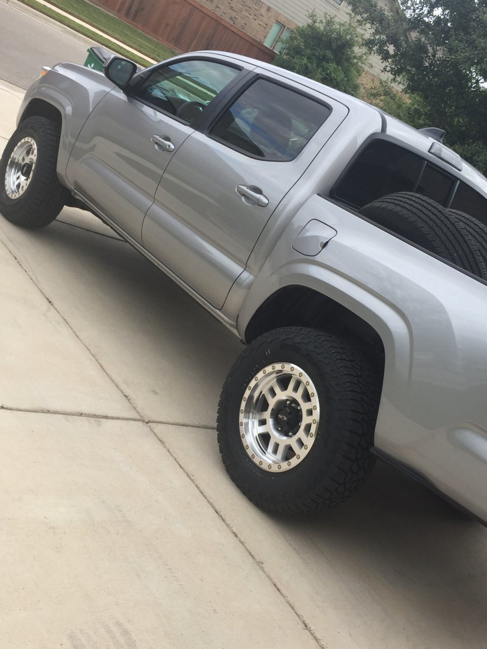

    Here is my answer for my stock SR
    Falken wildpeak 265/70-17. 17x8.5 with 0 offset vision Manx wheels
    Full turn to the right and no rub but just a finger space left.
    Full turn to the left and the back part barely rubs. I’ll have to use the heat gun and push that plastic piece in a little

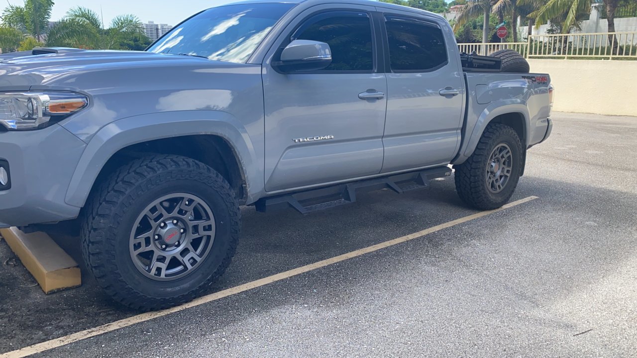

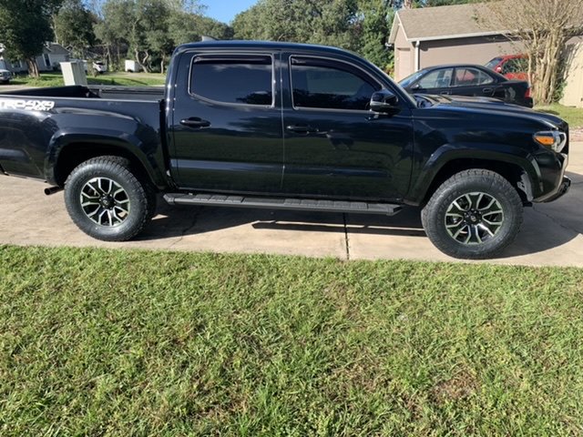

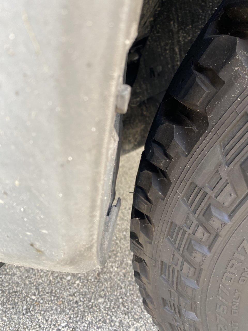

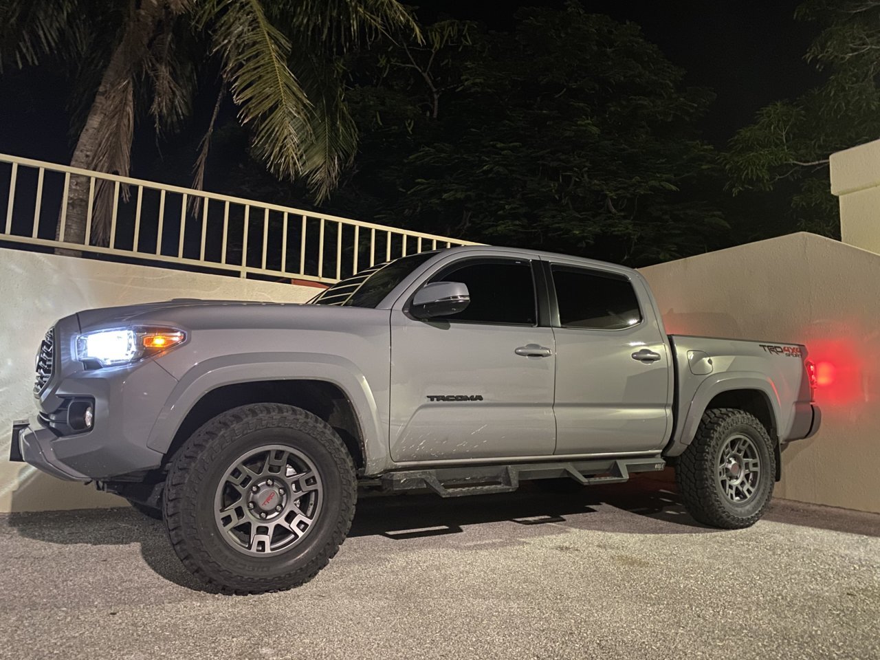

    2020 Tacoma TRD Sport, on 17” TRd wheels stock suspension, no lift and I’m running 275/70r17 Cooper ST Maxx.
    No rubbing at all unless I’m at 1/4 turn and hit a decent bump. I trimmed a piece of plastic nub the size of a raffle ticket. You can’t even tell it’s missing. And had to pull the front mud flaps. 5067F4EF-AFF0-4CB0-87E1-1335891FC262.jpg259B6DBB-8225-4FEE-891F-67D10EF7E3CC.jpg

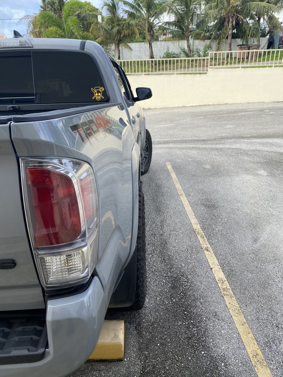

    do you have any pics from straight down the side? How much do they stick out?

    49FB9A4E-2516-4C8C-8DB2-7DDC374C6F4D.jpg 49FB9A4E-2516-4C8C-8DB2-7DDC374C6F4D.jpg BF80758B-E6E8-4C5B-AA33-BB246C844451.jpg BF80758B-E6E8-4C5B-AA33-BB246C844451.jpg
    Not to much. See for yourself
