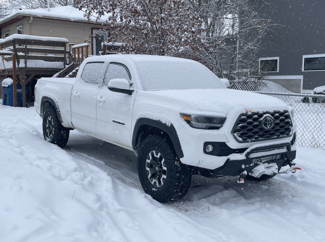

    Looks like this thread is still going! I have to share mine now. I just put 285/75r16 (32.8"x11.2") General Grabber ATx on my 2020 Tacoma off-road. Stock suspension, a winch and mini bumper on the front, 300lbs in the back. NO RUBBING! I haven't had a chance to flex it all the way yet, but with mild amounts of flex it doesn't touch the fenders. With the stock wheels the tire is very close to the upper control arm and spindle, so I'll be looking for better rims with my next set of tires. I'm super stoked this worked!

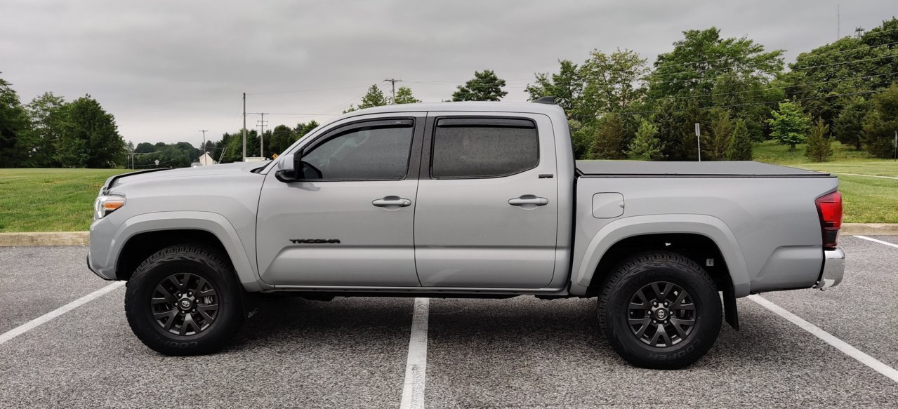

    I just had Cooper Discoverer AT tires in size 265/75r16 installed on my SR5 stock wheels stock suspension on Friday evening so far no issues. image.jpg

    Good to hear, truck looks great :hattip:

    Thanks man I'm working on getting the truck to look really good. I wanted a moderate lift but man changing the tires made a difference. The guys at the tire shop agreed too. I just love this truck. The gray and black looks good together.

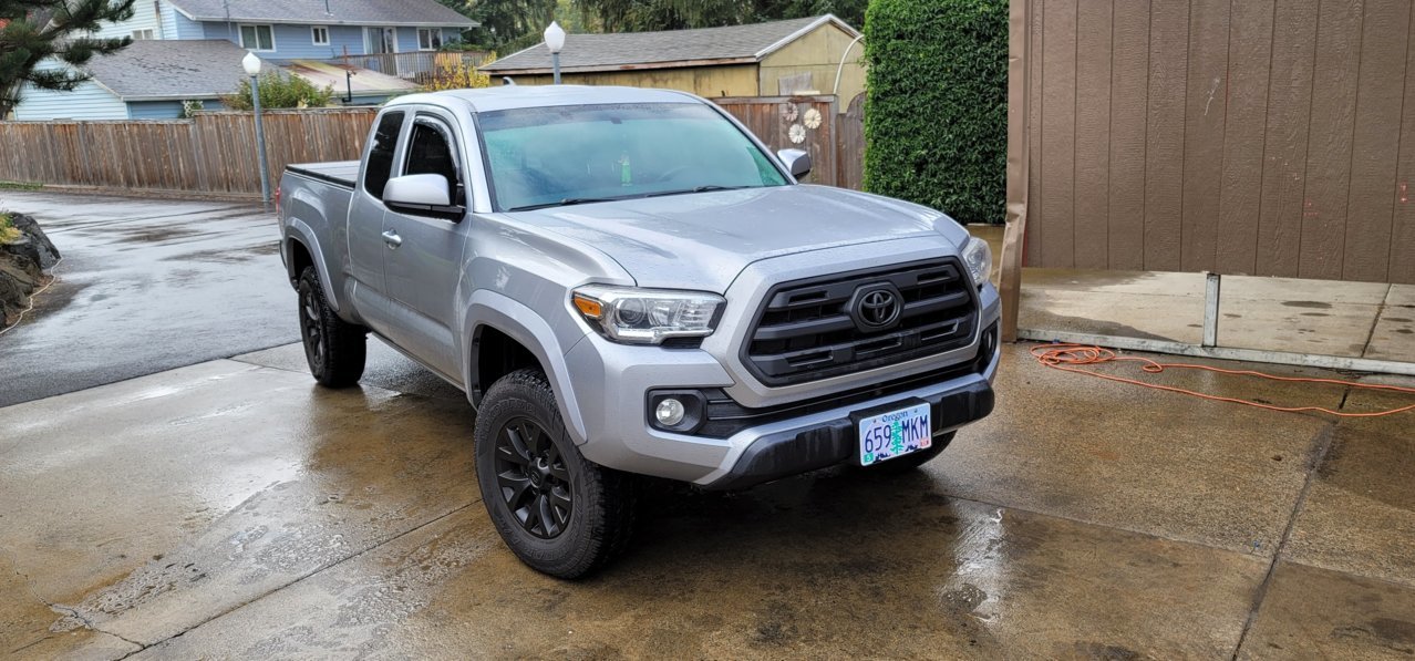

    Looks like we are twins with the black wheels!!
