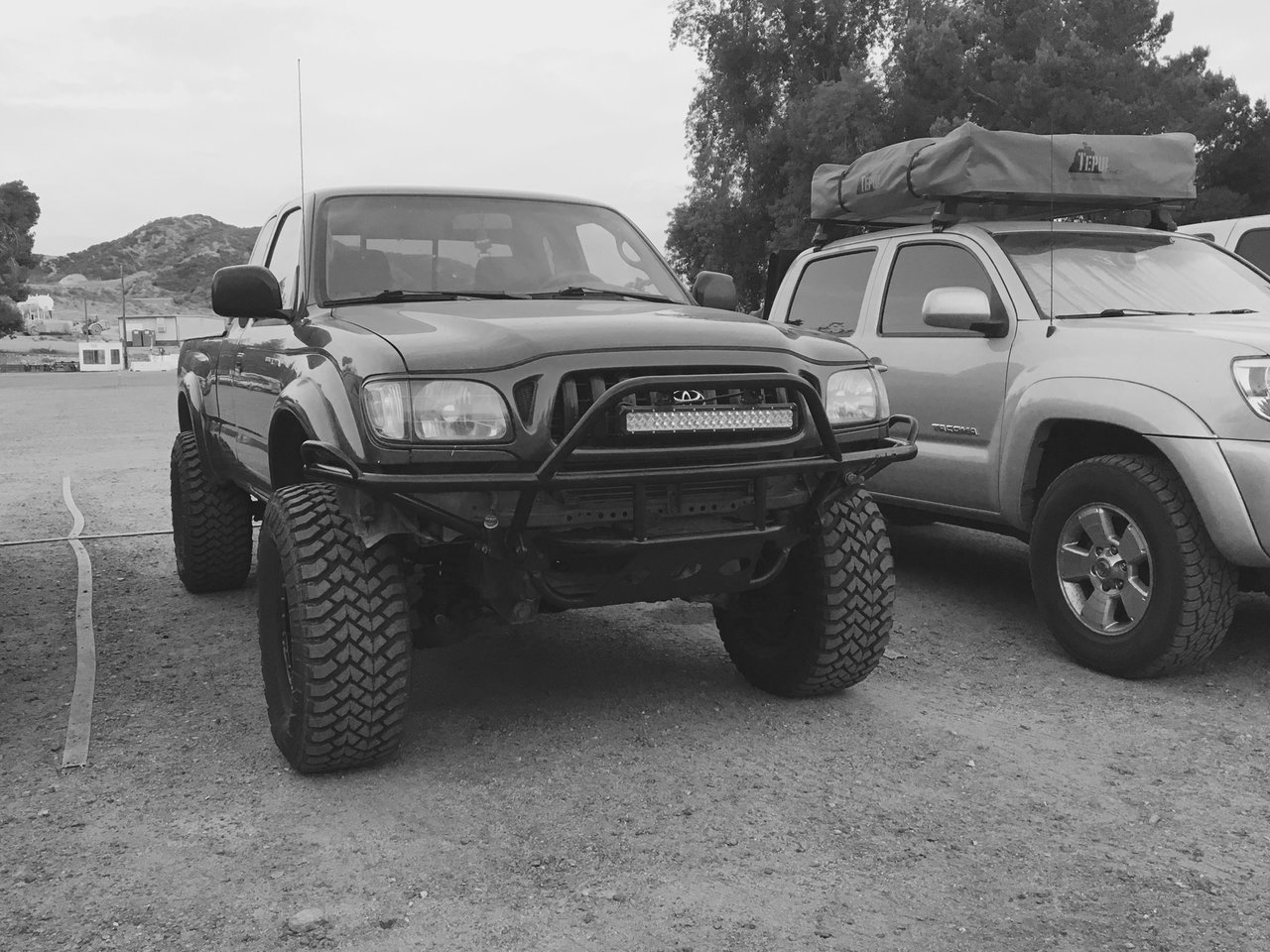

    2004 Tacoma 3.4l Extra Cab
    IMG_2119.jpg 33x12.50/15 fits good looks even better ;)
