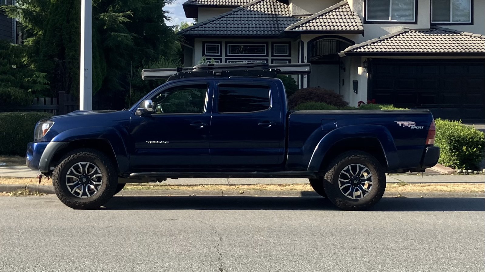

    Tires are 5 weeks young.
    I do hear and feel a light vibration regarding it rubbing at full lock (ie 3point turn).
    Here is the odd thing I only hear and feel a slight noise and vibration ONLY in reverse and ONLY on the left UCA. Yes it rubs on both pass and driver. :notsure:
    I plan to take the truck to get it aligned at a custom shop. Need to pull it back closer to the body mount.
    OR
    Very thin wheel spacer like 1/2in.
    In regards to handling.
    Feels fine, feels great off-road. but when I do get close to full lock (which I do frequently)
    I feel a gentle push back on the wheel kind of like it’s pushing itself away from full lock. (Which it does by stock tires. Just a little more so)
    My definition:
    Full Lock, when driver input steers all the way to one side and holds it. Where the steering knuckle is hitting the hard stops. (If driver lets go the wheel comes out of full lock)

    Oh yah. Wheel offset. Which I won’t change the rims.

    Not the height you should be concerned about. The height will affect your distance to the body mount.
    The width is your (and mine) issue touching the UCA.
    And yes if the manufacturer size is not exactly the same.
    But the. With a thin spacer you run the risk of not having enough threads on the lug nuts so you need longer wheel studs.
    I’m just going say fuck it and not turn as hard.
