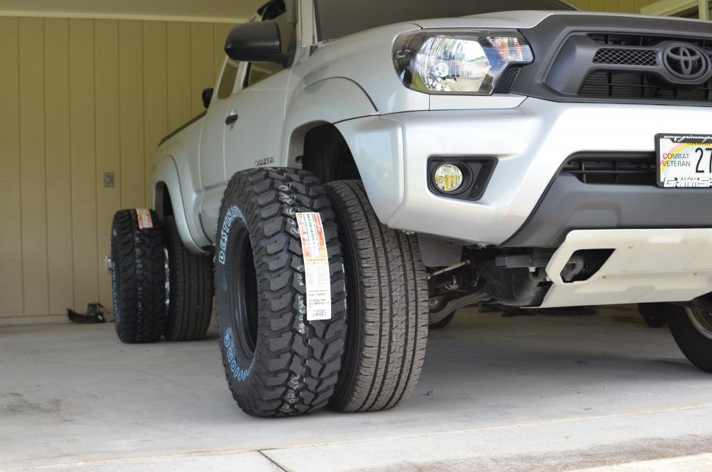

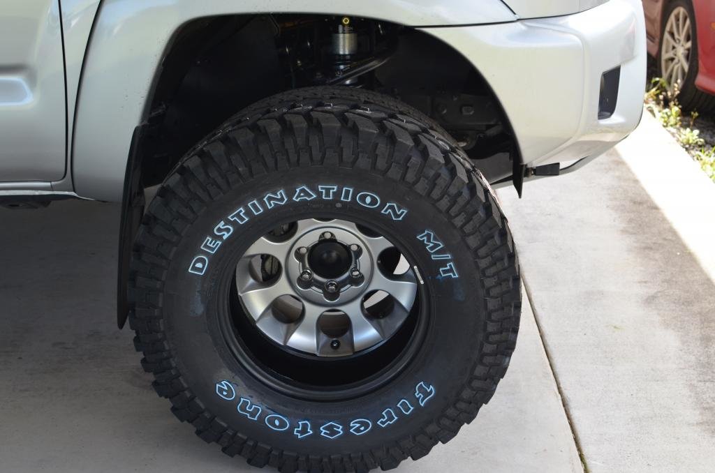

  3. Feb 28, 2013 at 7:51 PM
    Xer0 SiN
    Xer0 SiN Well-Known Member
    Mar 16, 2010
    #33334
    1,769
    Hilo, HI
    19 TRD SPORT TACOMA / 21 LIMITED RAV4
    this and that...
    when i put my 265/70/17 on my truck, i thought i had a lot of space under my wheel wells. i thought to myself, i could easily fit 285's without any modifications. i know theyll fit but now i think it may be tighter than i orginally thought. ive thrown a side by side comparison just to show the difference. currently, im waiting for my welds to come in.
