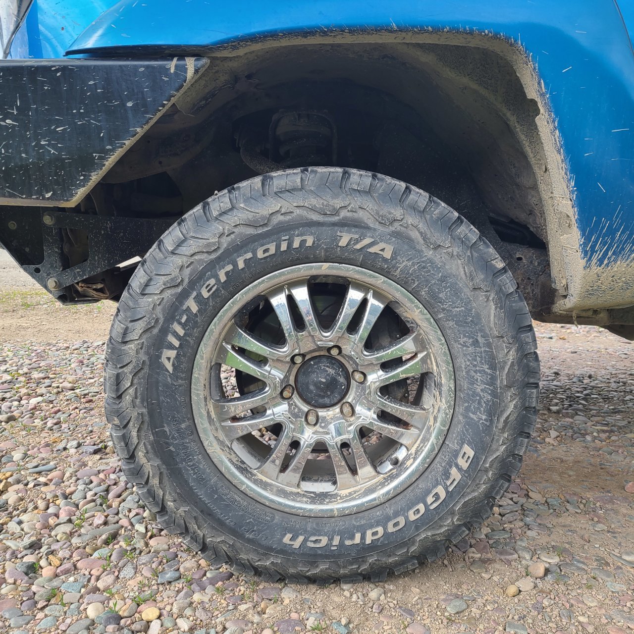

    Upon measuring the wheel, it's 17" high and about 9" wide total. I've heard the real width is bead to bead so I'd guess 8-8.5".
    On top of that, I worry about the UCA clearance. Thoughts on a 1.25" spacer? I've heard good things about Bora spacers.

    I thought you said they were factory wheels? I don't believe toyota ever did a 17x(8-9) from factory. The back side of the wheel should have specs. Should give 17x... And the offset of the wheel.

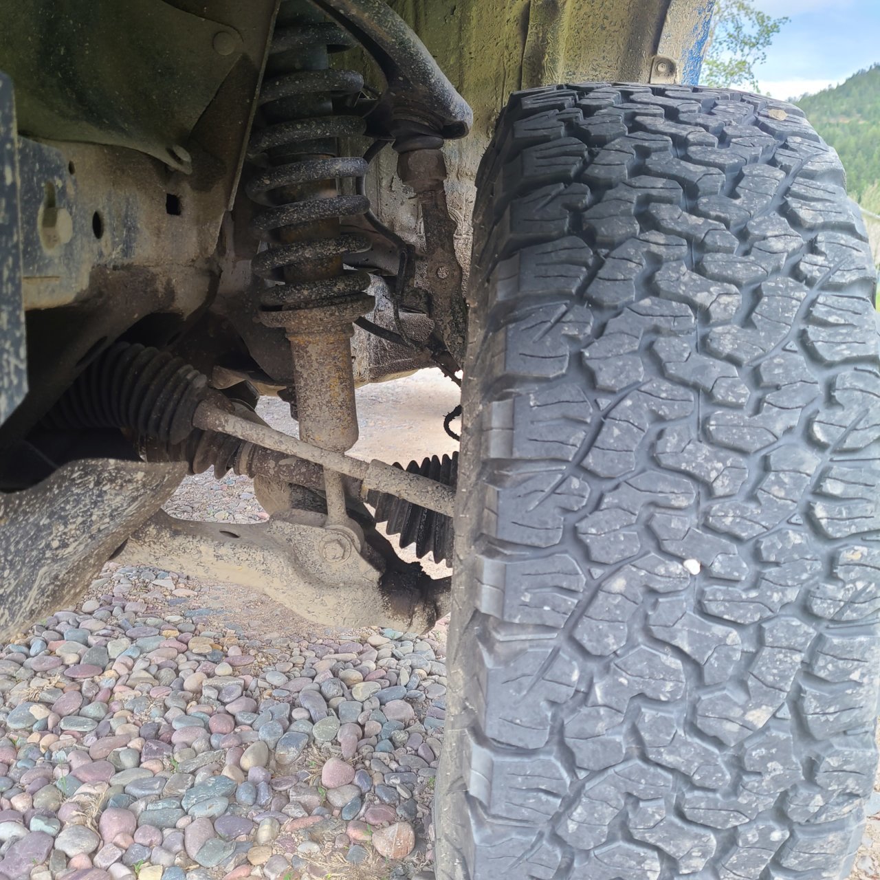

    Yeah.
    You have a torn inner CV boot.

    I said they mimic stock, it was my assumption since the 265 tires were on them like stock just 70 instead of 65. Per measurement they are wider, the offset I'll have to check at some point once I can pull off the wheel. Daily driver and all.

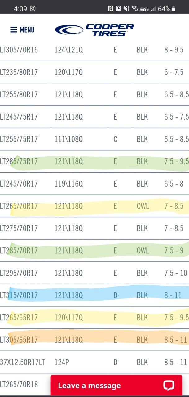

    For example on this Cooper tire. Even the same width tire, 285, has different wheel widtchs it is recommended for based on side profile. Yes, you could find a tire shop that will mount what ever your little heart wants on your current wheel even if the manufacturer doesn't recommend it. However most will not touch it due to liability if that tire were to fail they could be held responsible for damages done since they mounted that tire on the incorrect wheel size.
