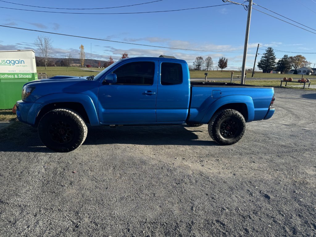

    Same KO2 goodness, all new round bits on the inside. Zero rubbing with the stock OR wheels (16x7, +12 offset I think?), and just a hint of rubbing at certain steering angles with the F5's (16x8, 0 offset). I think it's just barely grazing the mudflaps.

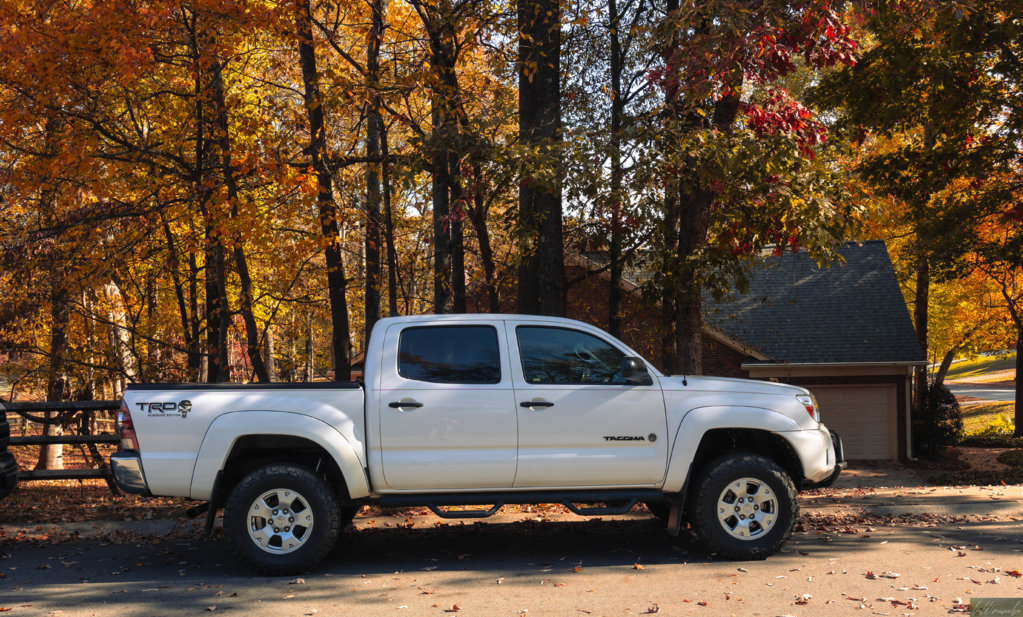

    Same tire, but did a 2.5 lift too. Great tires!! Good looking truck you got there!

    Did Rough County

    I think everything is just fine. I purchased the equipment from their site and had my local Toyota dealership do the installation. After a couple of months, I went through the install checking the nuts and bolts for tightness to be sure nothing had loosened up. This is just enough clearance for off roading here in the Carolinas and overlanding out west.
