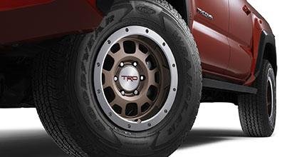

    Is anybody here running 33’s on TRD beadlocks or other wheels that are 16x7 with +10 offset and if you do is there any rubbing?
    The information seems a little limited on this setup and I would like to run it but I’m trying to avoid running spacers or getting any rubbing if possible

    Note that your post says 17x7.5 -6 but the TRD "beadlock" wheels are 16x7.5 +10.
    What size 33's are you talking about? Adding spacers will increase your chances of rubbing, not prevent it - unless you're talking about running a tire that's so wide you're having tire to UCA rubbing. But if that's the case then you're also going to have rubbing in other places. For 33's, your typical options are 255/85R16 or 285/75R16 and those will both clear the UCA with the TRD "beadlock" wheels. So you should not need to run a spacer.
    Whether you are going to have rubbing or not is based on so many darn factors so it's hard to trust other people's anecdotal experience. I have 255/85R16 Yokohama G003's and they rubbed a little on the mud flaps but that's it. (I should note, this is with no spacers and no aftermarket UCA). But, based on my reading in the skinny tire thread it seems 3rd gens are less likely to encounter rubbing than 2nd gens when it comes to running skinnies.
    If you want to run 285/75R16 then I'd expect to experience some rubbing but everyone's situation seems to be a little different. Some claim they can run this tire without rubbing. I'm skeptical though since my skinnies rubbed and a wider tire definitely would have rubbed more.
    Stick to skinny tires and high offset wheels if you want to prevent rubbing. And contrary to popular belief, aftermarket UCA's often lead to increased rubbing, not decreased.

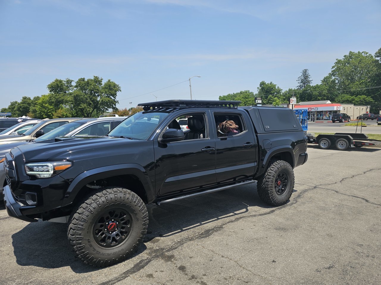

    315 75 16 on a 16x7, you just gotta find a shop that will do it

    That is with cutting though right and I assume a cab mount chop right?

    oem
    Body mount relocation
