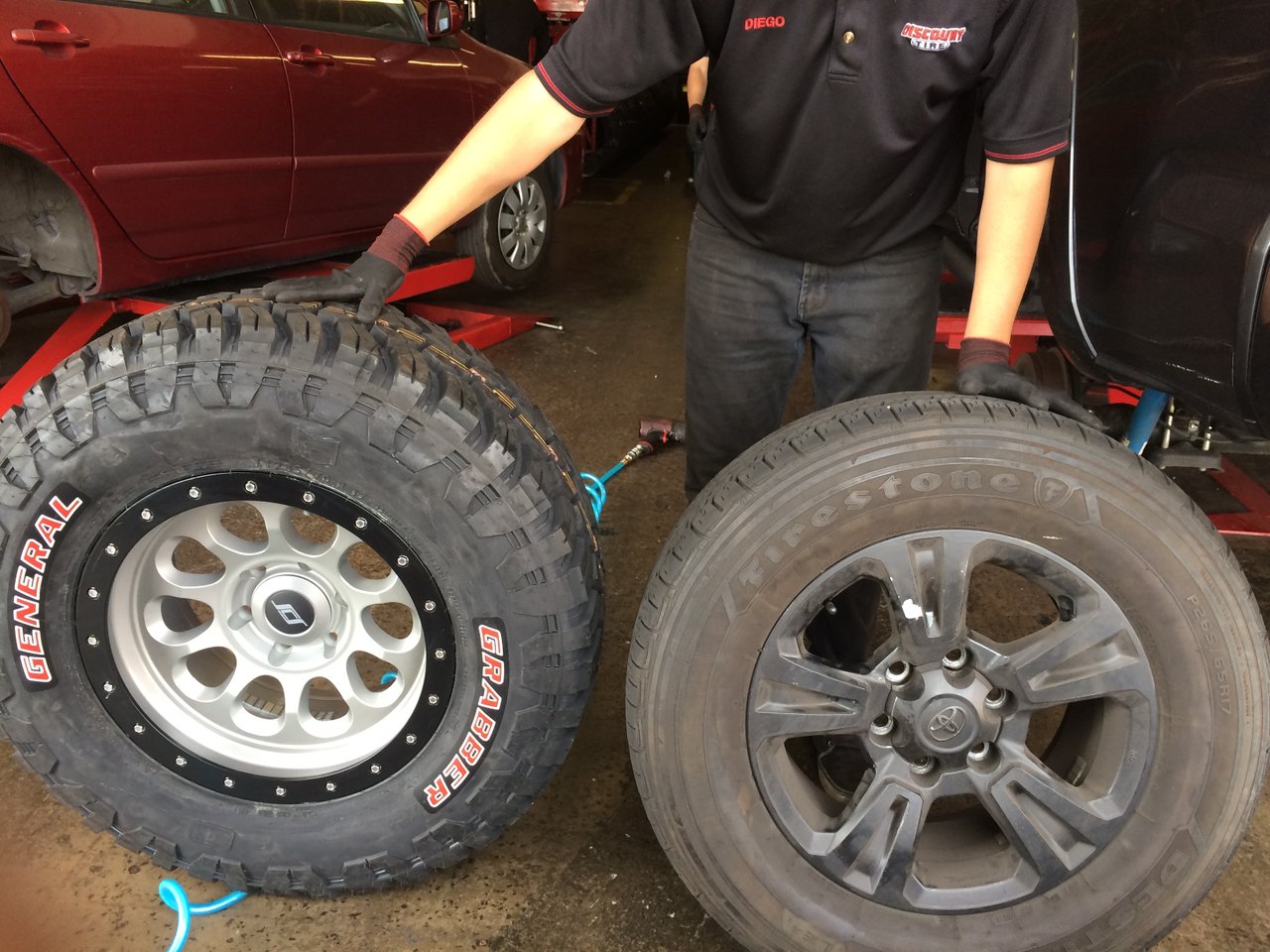

    I put 285/70/17 tires on 17" ray10 wheels on mine.
    I had a lot of rubbing, and I had to take my truck to a shop to get professional CMC done, and trim my inner fender wells.
    Amount of cutting and chopping can be reduced if you lift conservatively.
    Like you, no hero stuff. Just regular driving. I did it mostly for the aggressive looks and stance.
    See below difference between 285's and 265's, and my truck. Still has taco lean.

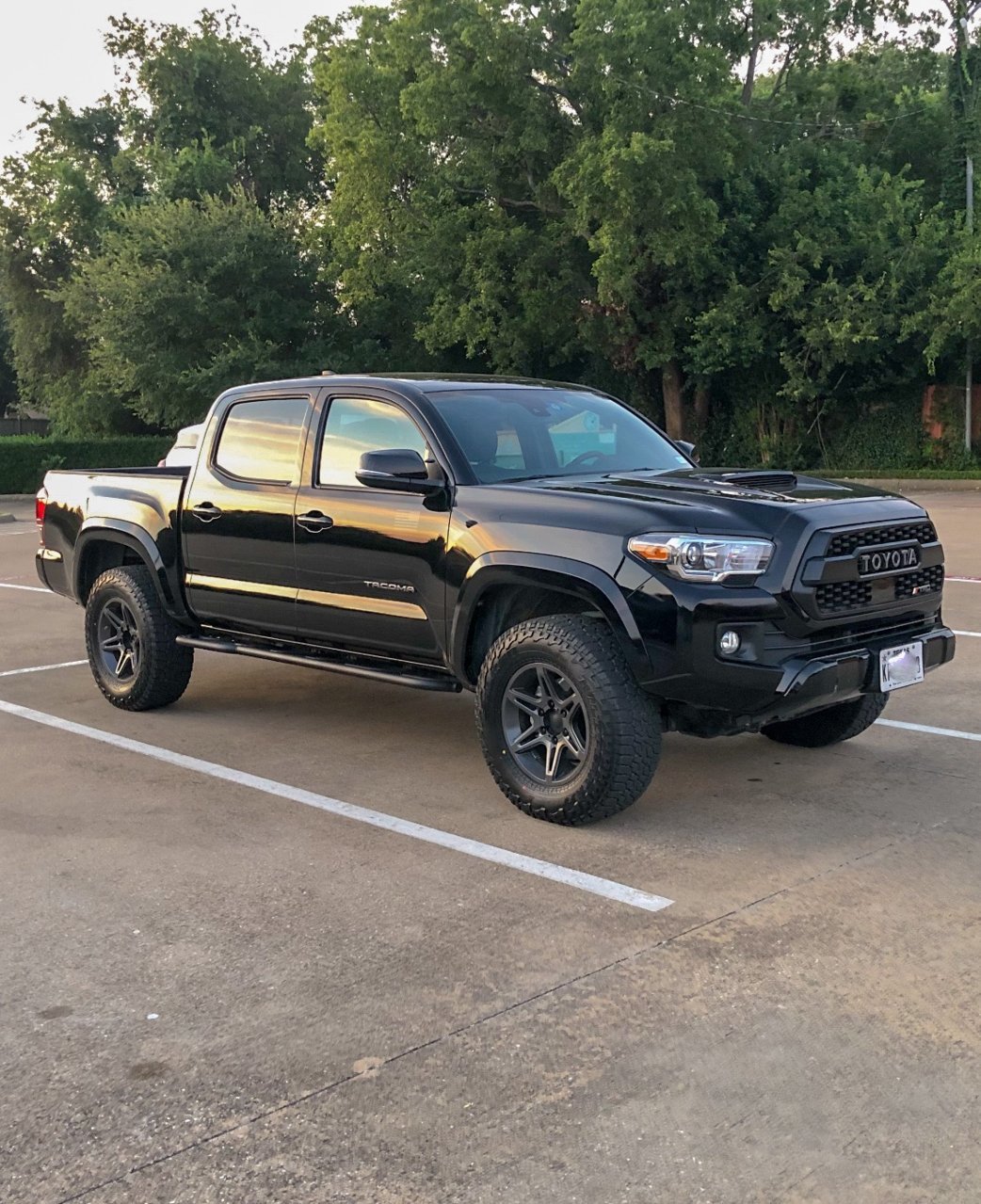

    Jon
    Dallas, TX
    2018 Tacoma TRD Sport 4x4
    Some people report slight rubbing with 265/70/R17, but mine clear without issue. I have stock sport suspension, but about -10 more offset in the wheels than stock.

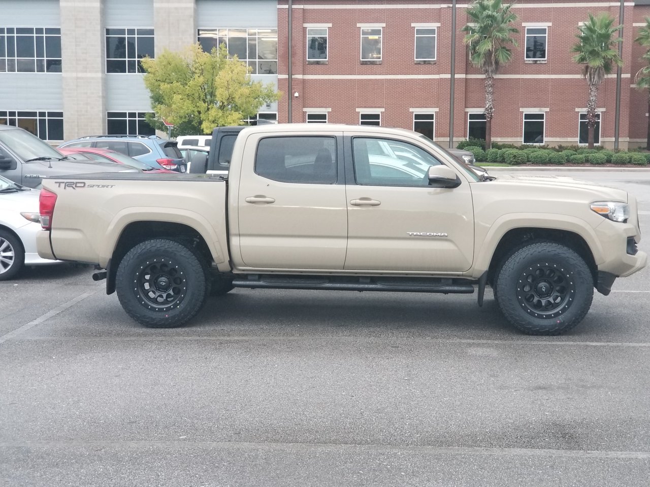

  8. Aug 26, 2019 at 7:37 AM
    EmanC19
    EmanC19 Well-Known Member
    Sep 4, 2018
    #265211
    347
    San Diego, CA
    I plan not to lift also but same here warm bigger tires and scs rims. What is the biggest size we can go without rubbing? Sorry I'm a noob at wheels, suspension, and other stuff...
  9. Aug 26, 2019 at 7:45 AM
    HelloMyNameIs
    HelloMyNameIs I know words, I have the best words.
    Sep 10, 2018
    #265787
    862
    Location: Dayton, Ohio
    2018 TRD Off Road in Cement
    OME 2885, Billie 5100s, HS Prog AAL, 255/85r16 Cooper ST Maxxs
    255/80R17
    Biggest without lifting OR chopping.
  10. Aug 26, 2019 at 7:45 AM
    Clearwater Bill
    Clearwater Bill Never answer an anonymous letter
    Oct 11, 2014
    #140097
    24,674
    Billy
    Largo Florida
    '13 5 lug AC w/convenience package
    A few OE parts from fancy trucks
    255 80 17
    Full 33"
    Couple mega threads on it.
  11. Aug 26, 2019 at 5:18 PM
    navybsn
    navybsn New Member
    Apr 1, 2019
    #288680
    2
    2016 Quicksand Tacoma TRD Sport
    265/70/17 Falken Wildpeaks on Ray 10s. Minor rubbing before trimming the mud guards.
