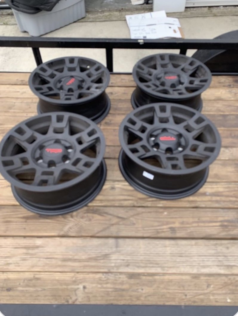

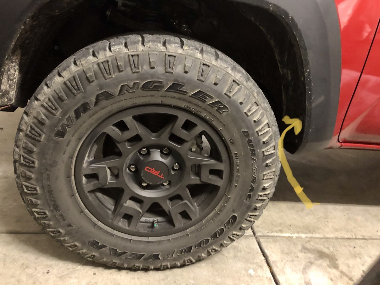

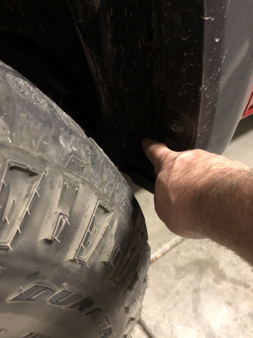

    BA811AB5-1864-46EA-9E07-2E8600A1AE01.jpg I have those wheels on my truck, and 255/75/17 Duratracs. Overall they are slightly above 32” in diameter. They rub on turns, and compression, on the mud flaps only. I haven’t noticed rubbing anywhere else. I could not run 33’s on my 2019 DCOR 4x4, without having to get a cab mount chop.
