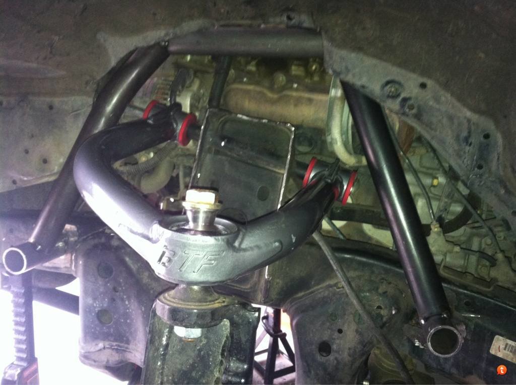

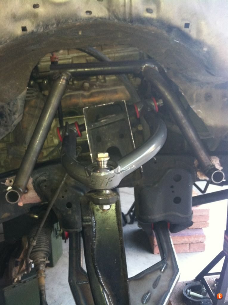

    got the driver side tacked up...passenger side will be done later today

    Might have some questions coming your way. I'm thinking about making my own engine cage as well

    so my guess is you aren't going to run secondary?

    yea i plan on running some tube over the front of the engine as well ill be sure to post some pictures
    naaaa never planned on it. i dont even want to think about fitting a 10" bypass somewhere in there as well

    So fitting that 10 is a pain? Was thinking an 8 and having Brandon make the upper wider to fit a secondary?

    yea if you wanna run a secondary i would go with an 8" forsure. theres really only a couple places to fit a 10" on the drivers side but the passenger side has much more room
    i could have moved the top mount farther up but i needed to match what i could fit on the drivers side

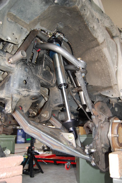

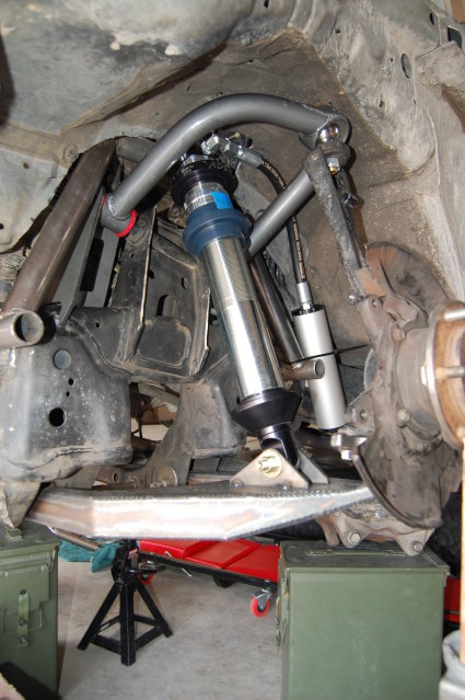

    took some better pictures
