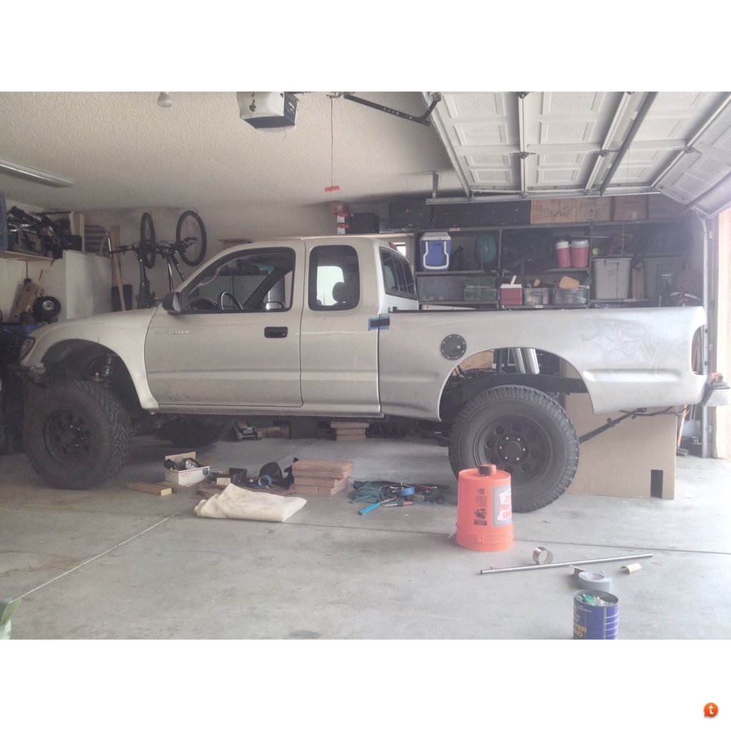

    mounted the bedsides last week and been adding some more tube to the rear of my bedcage. im going to chop my frame behind the shackle pivots and use tube for the back end wich will hold a flat spare and support the tailgate mounts. ill take some pics tomorrow

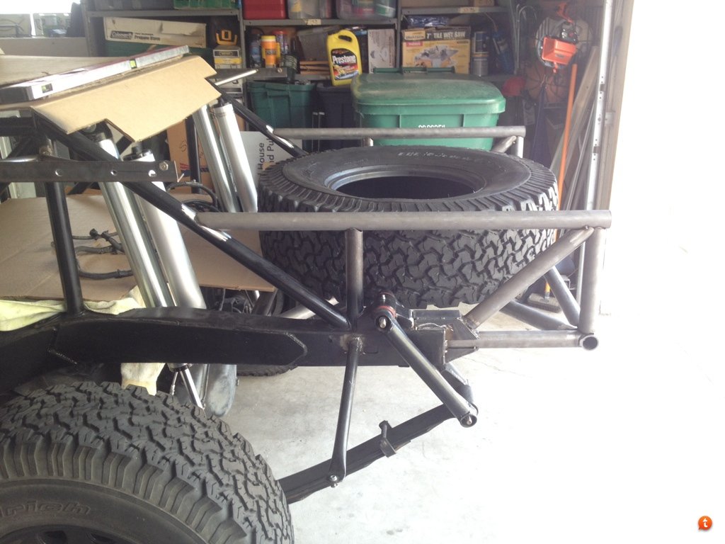

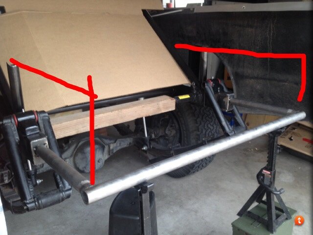

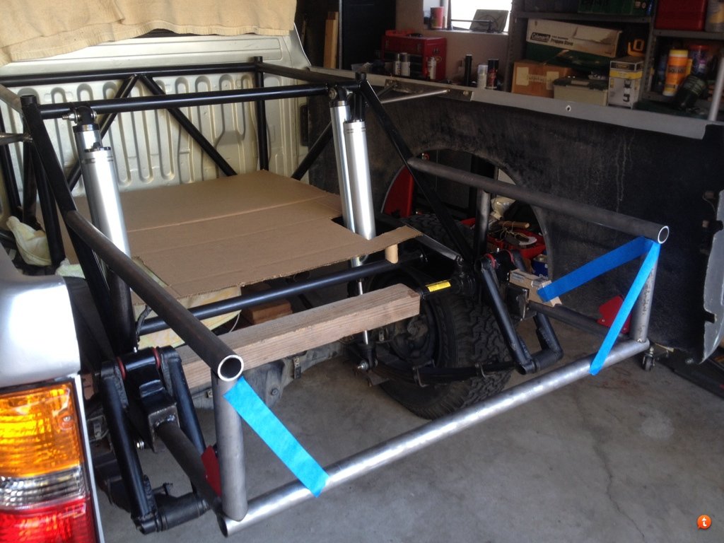

    chopped off about a foot of the frame and capped it off.
    upahunyg_98c6ddf2a4b0b9fb7c6129bbeebaf44d1a85907f.jpg9ygydehu_7cb1e63cbd873016e1894cfabdfe476f82a58317.jpg
    squared up the rear structure which i will eventually build my rear bumper off of
    the red marks the tube that will tie it all in
    it got really windy ad rainy all of the sudden so ima get back to it tomorrow

    you may want to consider tieing your shackles mounts into the cage, most of the bed cages i see have the bar that runs over the frame rail end onto it (assuming for added strength).
    yours ends before it, dunno if it will make a big difference, or a difference at all

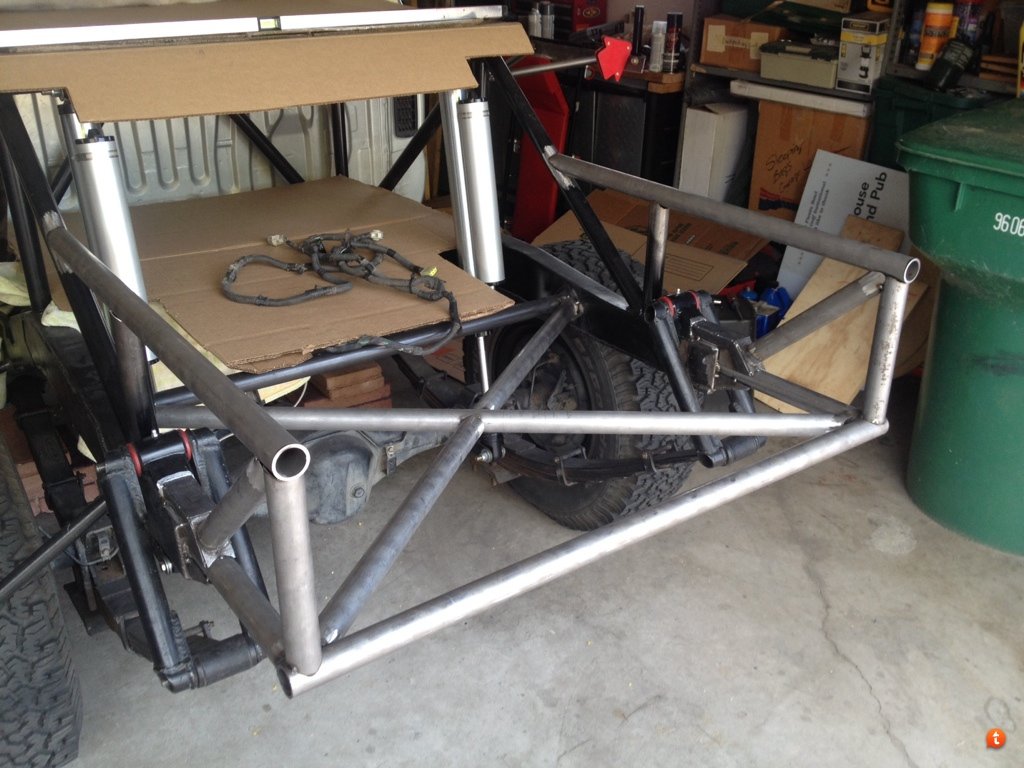

    still got a lot of welding to do

    you arent using a bender at all are you?
