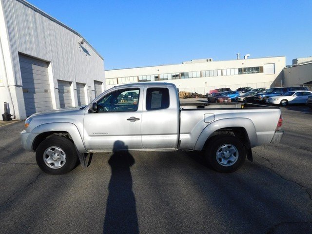

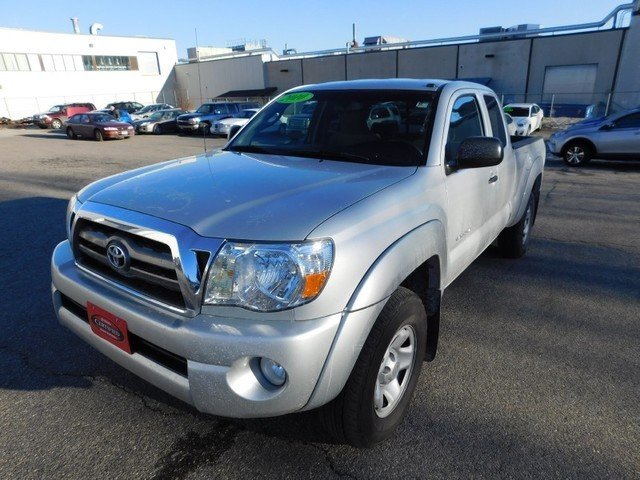

    I bought this truck in 2016. It is a 2010 Access Cab SR5 V6 Automatic with 43k miles. Here is what it looked like when it came my way:
    And now (October 2019):

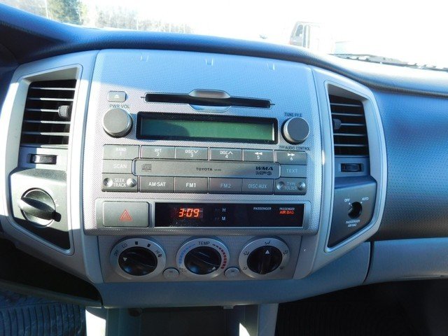

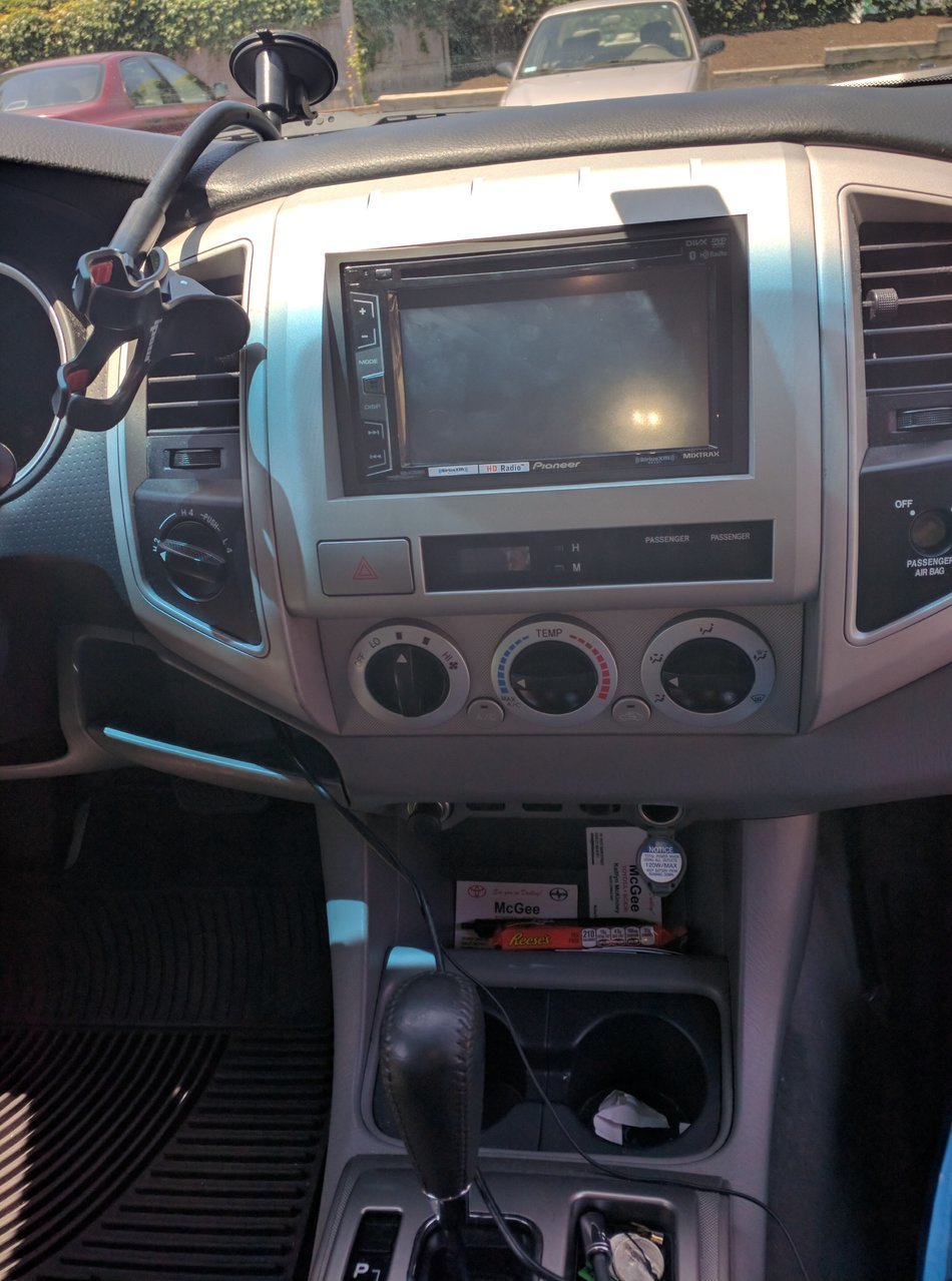

    Immediately I knew I needed to upgrade the radio and add the amp and subs that I had in my Rav4. This:
    became this:
    I just used a kit with pre-cut wires, which ended up biting me in the ass later on...

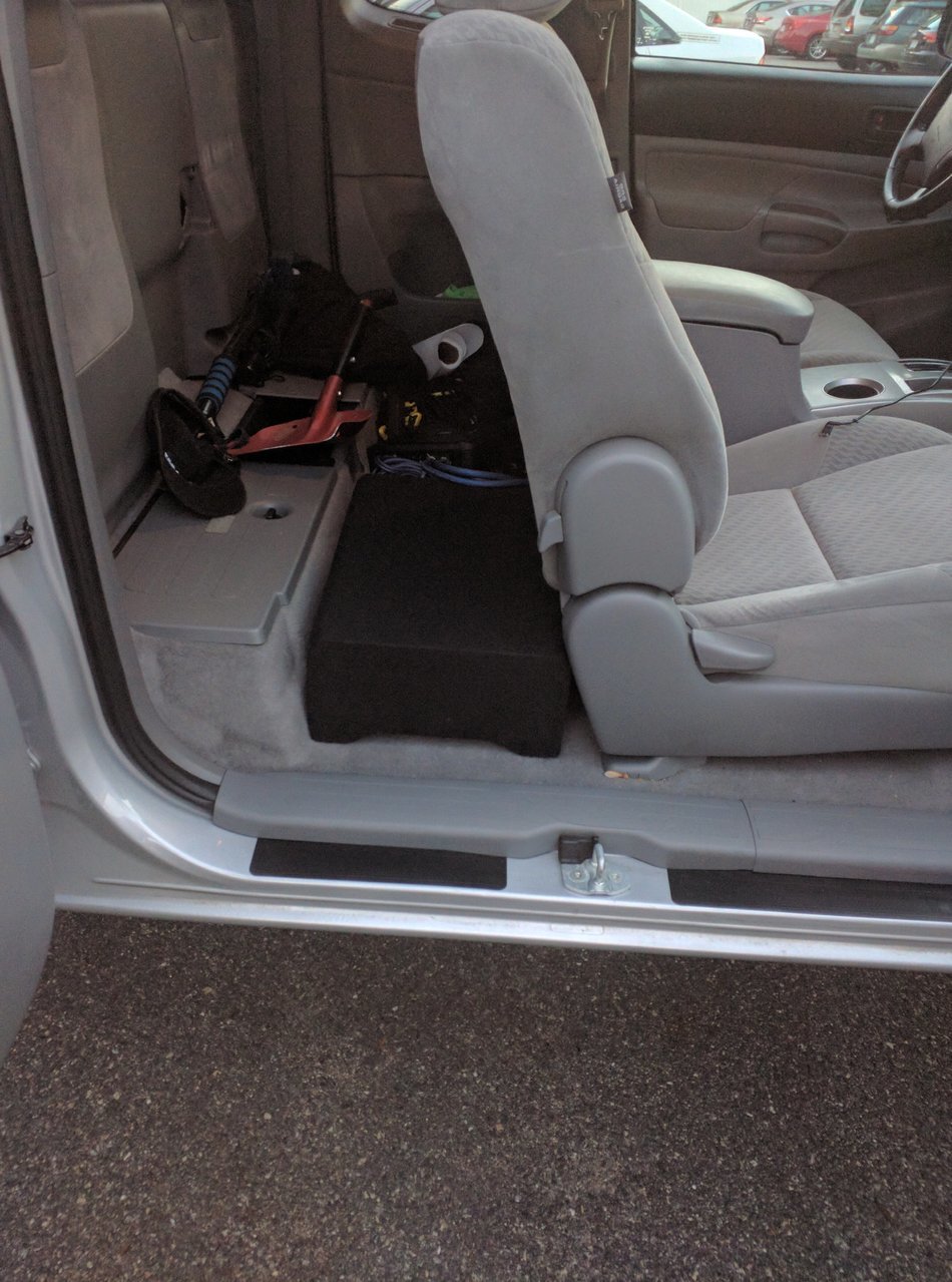

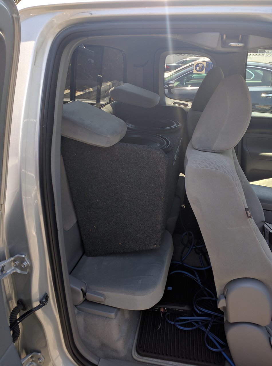

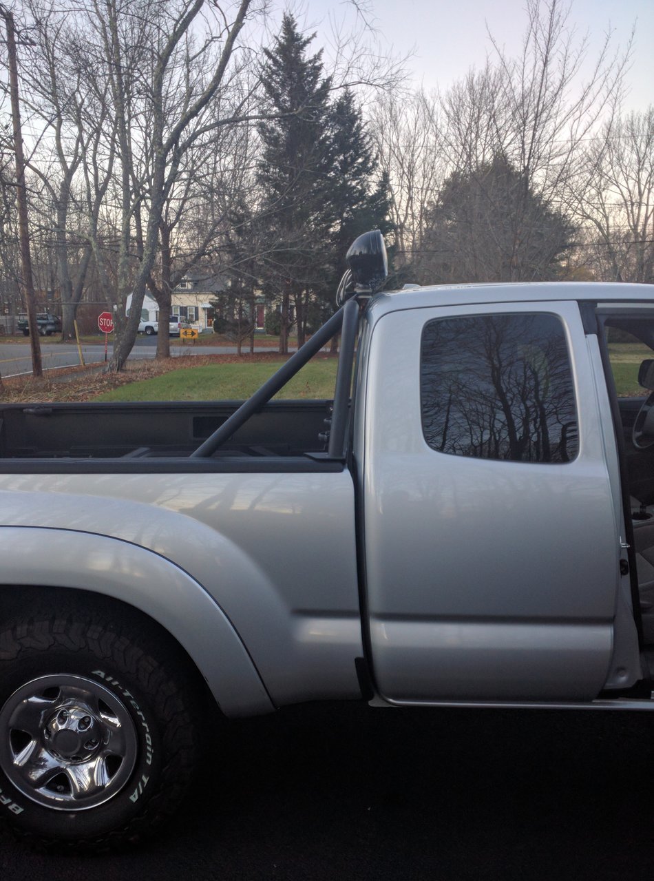

    Obviously these things are too big for those tiny seats, and sitting behind me is impossible, so:

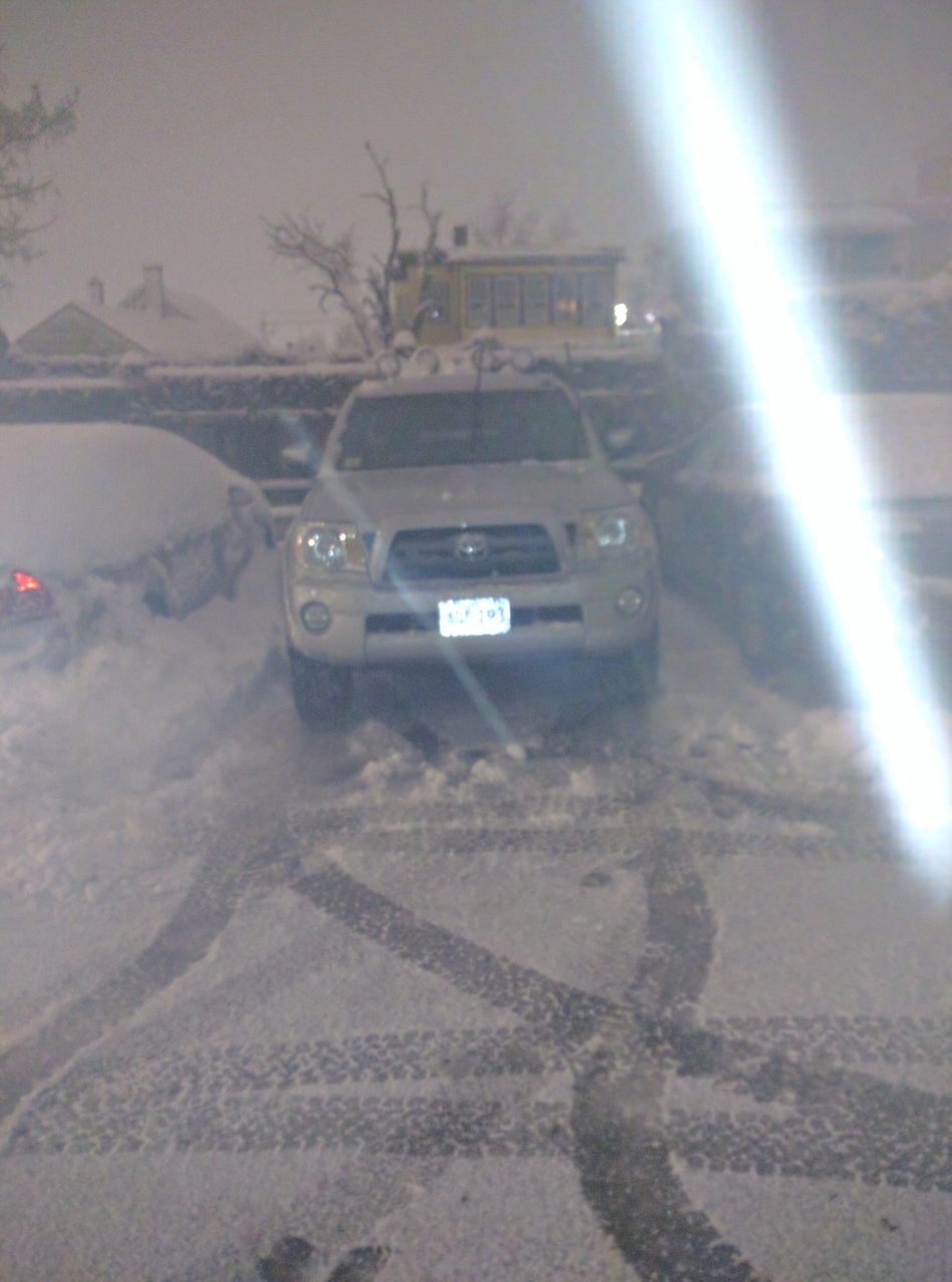

    My first New England Winter in the truck was approaching, so I installed some BFGoodrich KO2s in 265/75/16 on the truck.
    Living in an apartment in the city means the truck doesn't see much work, but I also have used it to help people move a few times.

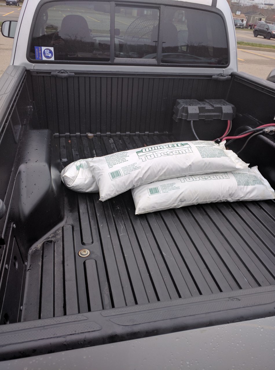

    As I got big into TW I knew I'd want lots of lights, but I didn't want to strain or run down my battery, so I installed a dual battery system with a battery in the bed:
    It's got a Blue Sea ML-ACR, and a Blue Sea Fuse Block so all my additions run off the battery in the bed. This way I'll never have to worry about not being able to start my truck, no matter how many accessories I add!

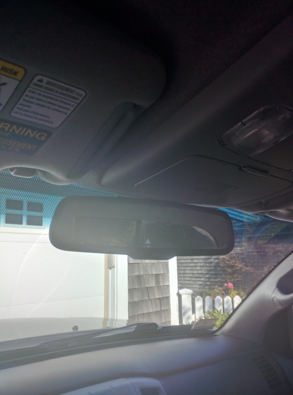

    Next up was the first thing I bought over TW and PayPal, a MrImYo mirror riser! Works beautifully so that my tall ass can see out of the truck.
    Last thing I did before winter hit was add some weight in the back (180lbs) for traction.
    Last year I didn't need it much, thankfully.

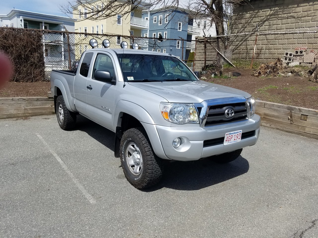

    In early 2017 the first thing on my list was to get and install a lift. Thanks to HeadStrong OffRoad I got Bilstein 5100s with OME 885s and an AAL in the rear. It gave me about 2.5 - 2.75 inches and leveled me right out!

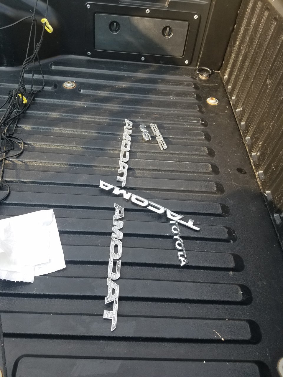

    I also got rid of these pieces of chrome

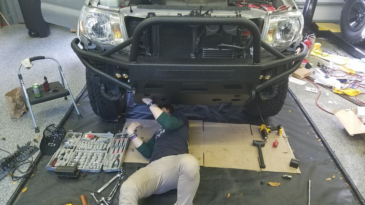

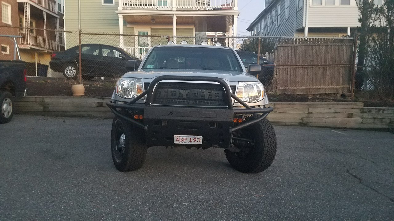

    Just recently my buddy and I installed a Pelfreybilt Hybrid bumper, which I absolutely love. I wired in a pair of KC Flex duals (spread) into the stock fog light harness and angled them down quite a ways. They are great!
