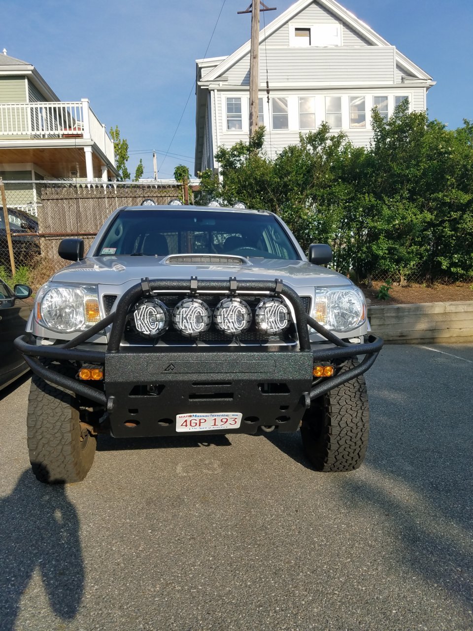

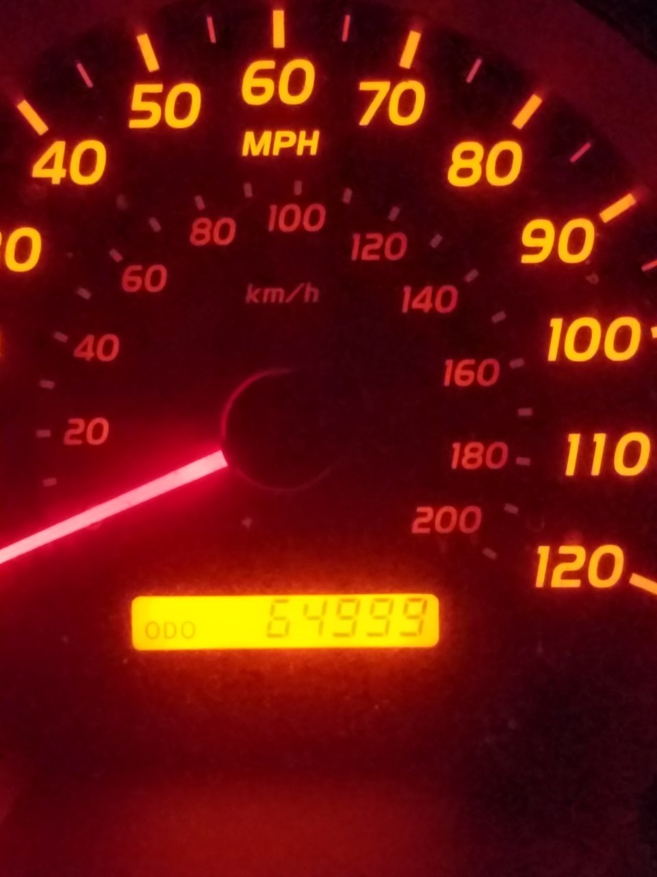

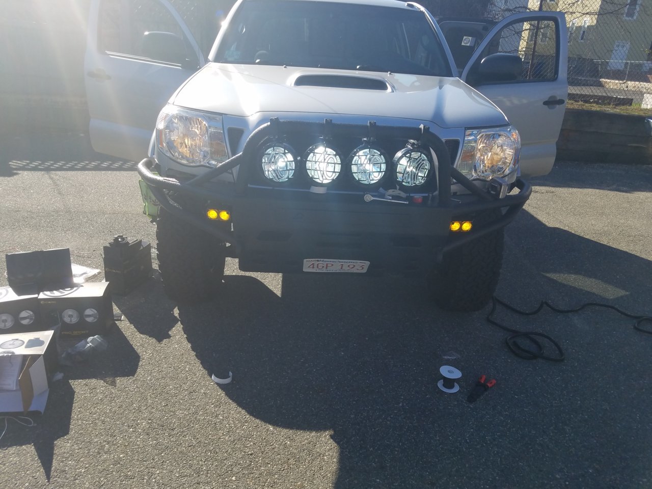

    I finally got around to swapping out the old KC Dayliter 100W Halogen spots with some new KC Pro Sport HIDs, spots in the middle and spreads on the outside. And the wiring is clean!
    I'll miss those smiley faces though...
    Also, I just hit 65k!

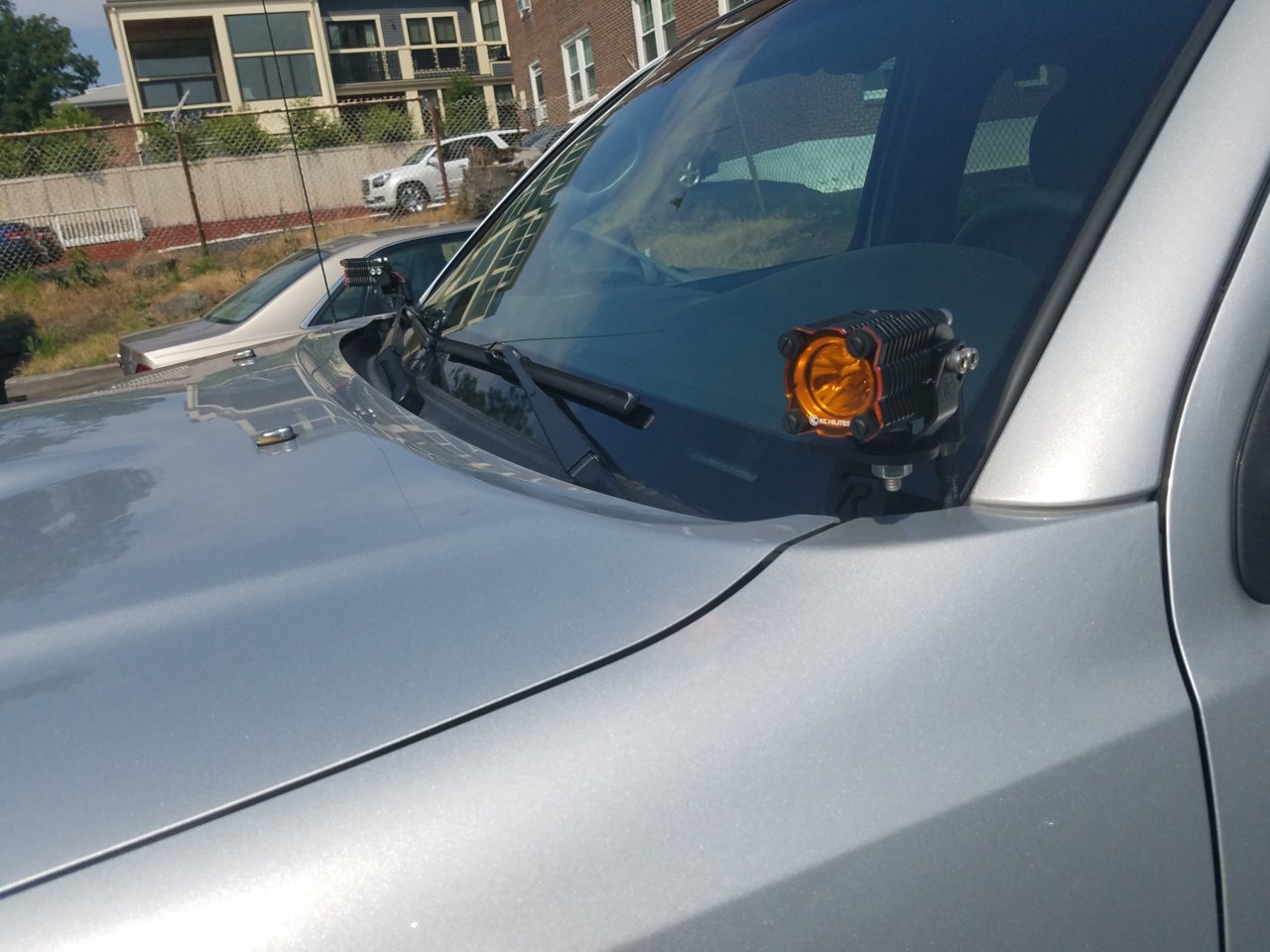

    Yesterday I finally mounted up my KC Flex Singles on the ditch light mounts I grabbed off @617mike9c1
    Had to do a little trimming to make them fit, but it wasn't too bad! I like the look a whole lot.

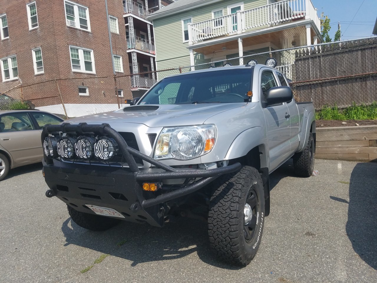

    Alright I haven't updated this in far too long, but to be fair I haven't done too much to the truck in a while. I've added a second 10" sub and upgraded to a 1200w amp, and a couple smaller things, but nothing major. I'll get pictures of the small things soon.
    In the meantime, I do have pictures of something major that I did last weekend. I finally put some 35s on my truck!
    I went from 265/75/16 BFGoodrich KO2s to 35/12.5/17 BFGoodrich KM3s:
    These have been taking up so much space in my apartment since Black Friday, so it feels great to finally get them on the truck. They are mounted on some ProComp 17" wheels.

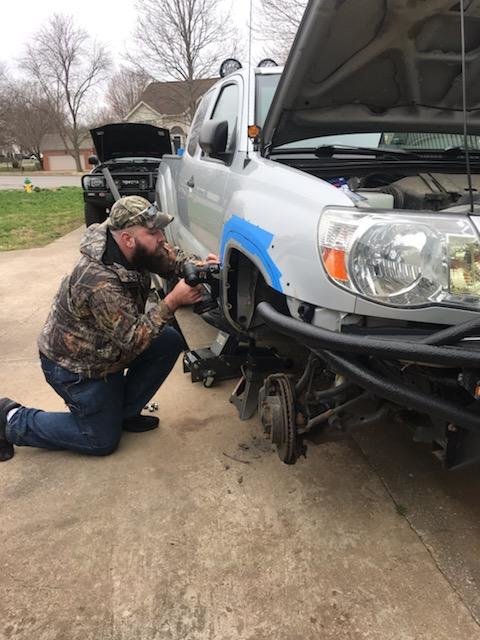

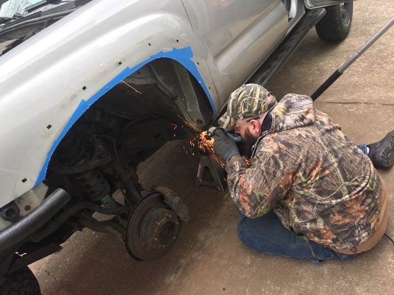

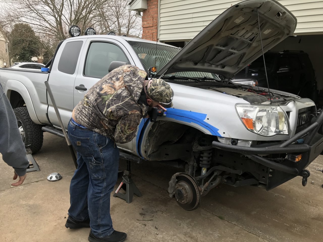

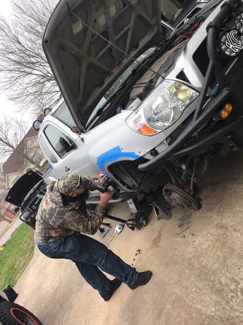

    To get these on, I (with copious amounts of help from the TN TW crew) cut 2.5" out of all four fenders, and 2" out of all four fender flares, aggressively cut the cab mount, and hammered the pinch weld flat.

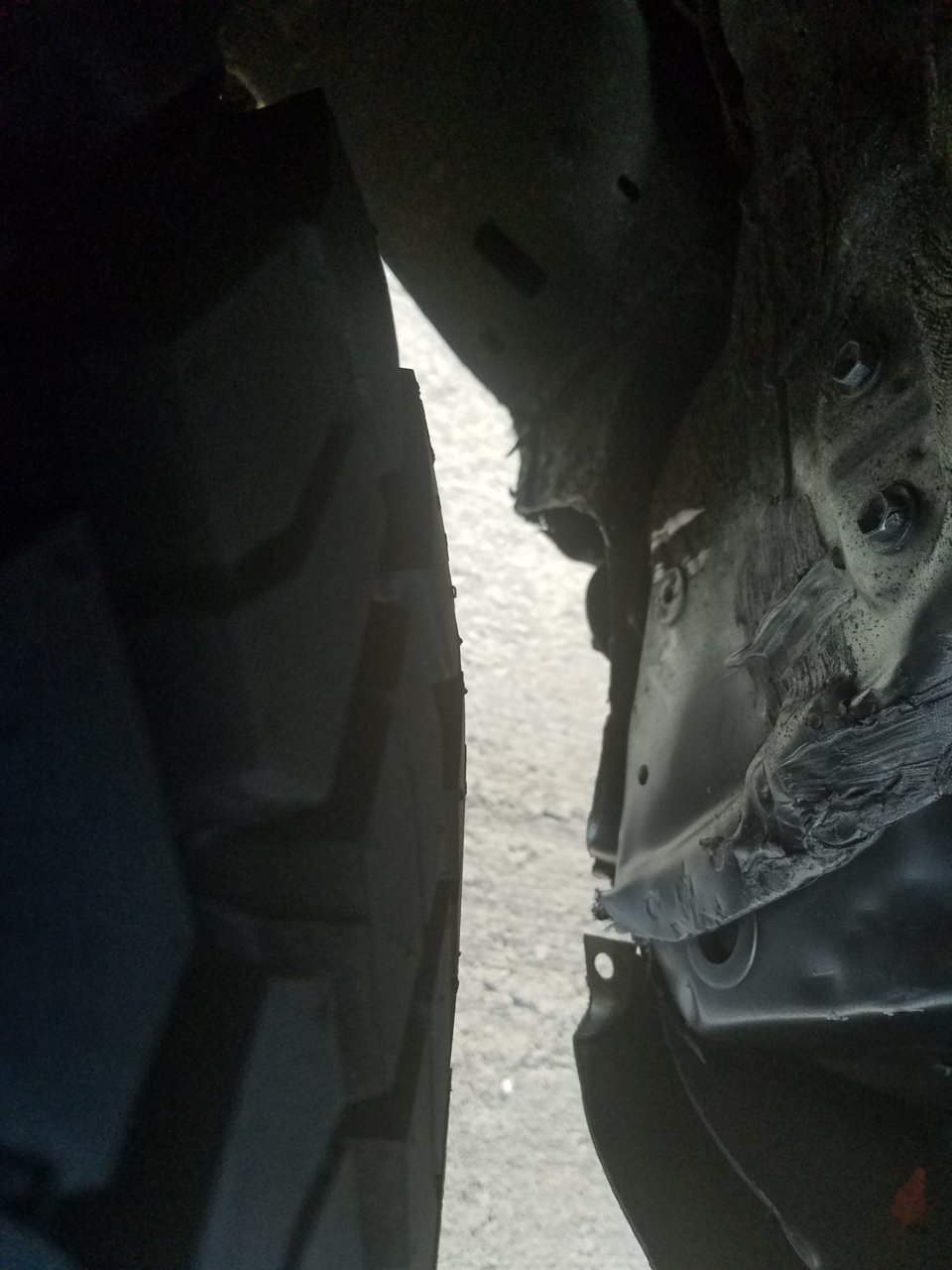

    And it all worked out great! I've got the slightest amount of rubbing at full lock, probably on the frame. Nothing to be concerned about yet. Now I look ridiculous in the office parking lot.
    So what's next? Well I'm still on stock gears, but so far it hasn't bothered me too much. I'm more concerned about stopping rather than accelerating. I'm also not a fan of how open the air intake is now. And all the armor is making me think I really should upgrade the suspension. So I hope to install the Tundra/T4R big brake kit, regear to 4.88s, grab a snorkel (now that I've already cut up my truck a snorkel doesn't seem so bad), and look into some premium coilers to really get that 3" lift.
    Should be fairly cheap, right?:censored:

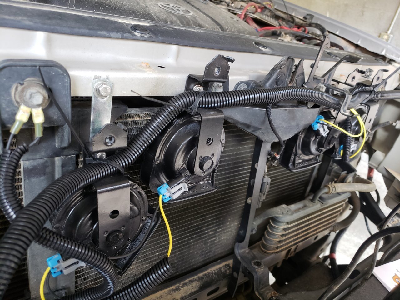

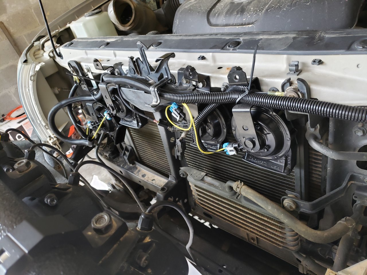

    This past weekend @ThunderOne and I installed some nice new horns out of a Cadillac thanks to @BartMaster1234
    Shitty comparison video:
