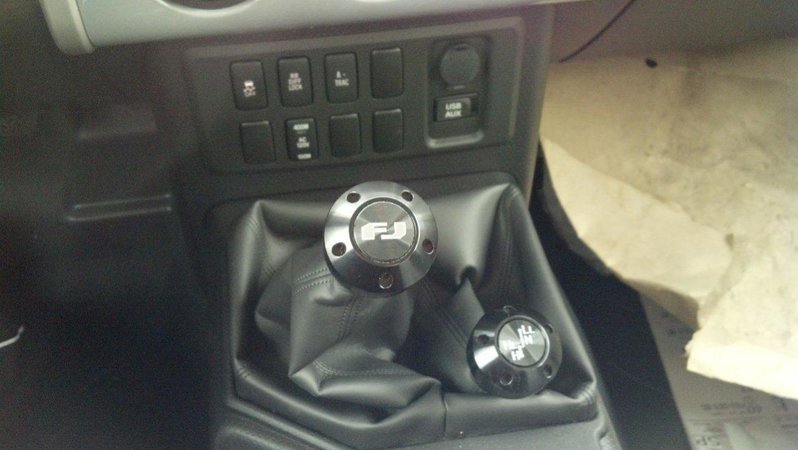

    Why did you not dog leg the shifter forward next to the 6speed shifter?
    Like the way FJ 6speeds are located.BD3D006D-E7AB-4508-AE84-9F283B96F3E8-21672-000017CB5D535B96.jpg

    Thank you for the question. I took measurements of the Automatic console layout and beings this space is not available there plus I had limited time to get to Moab, I just had Rocky stick it out the front cup holder.
    We do have a short throw shift kit for our TacoBox that makes dog leg shifters far easier to fit in tight spaces, but there isn't room under the console for it (it sticks up too high).
    At the end of the day I'd like to design something different than our traditional shift arrangement, such as a remote cable shift, so that we can cover many more applications without having to modify as much of the interior.
