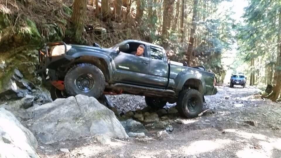

    Ya totally love whoring out pics lol. Well as of right now myself and a friend are headed down the last weekend in May provided the weather has cooperated and there's not a bunch of snow. I would love to come for an event unfortunately being the rookie on the crew i got last pic for time off so late May early June is all I could manage... anyways here's a few shots of the mighty 09 4cyl 4x4 5spd lol
    I wont fill up too much space here. She might be slow but she gets the job done eventually
    JesseB and BigMike[QUOTED][OP] like this.
