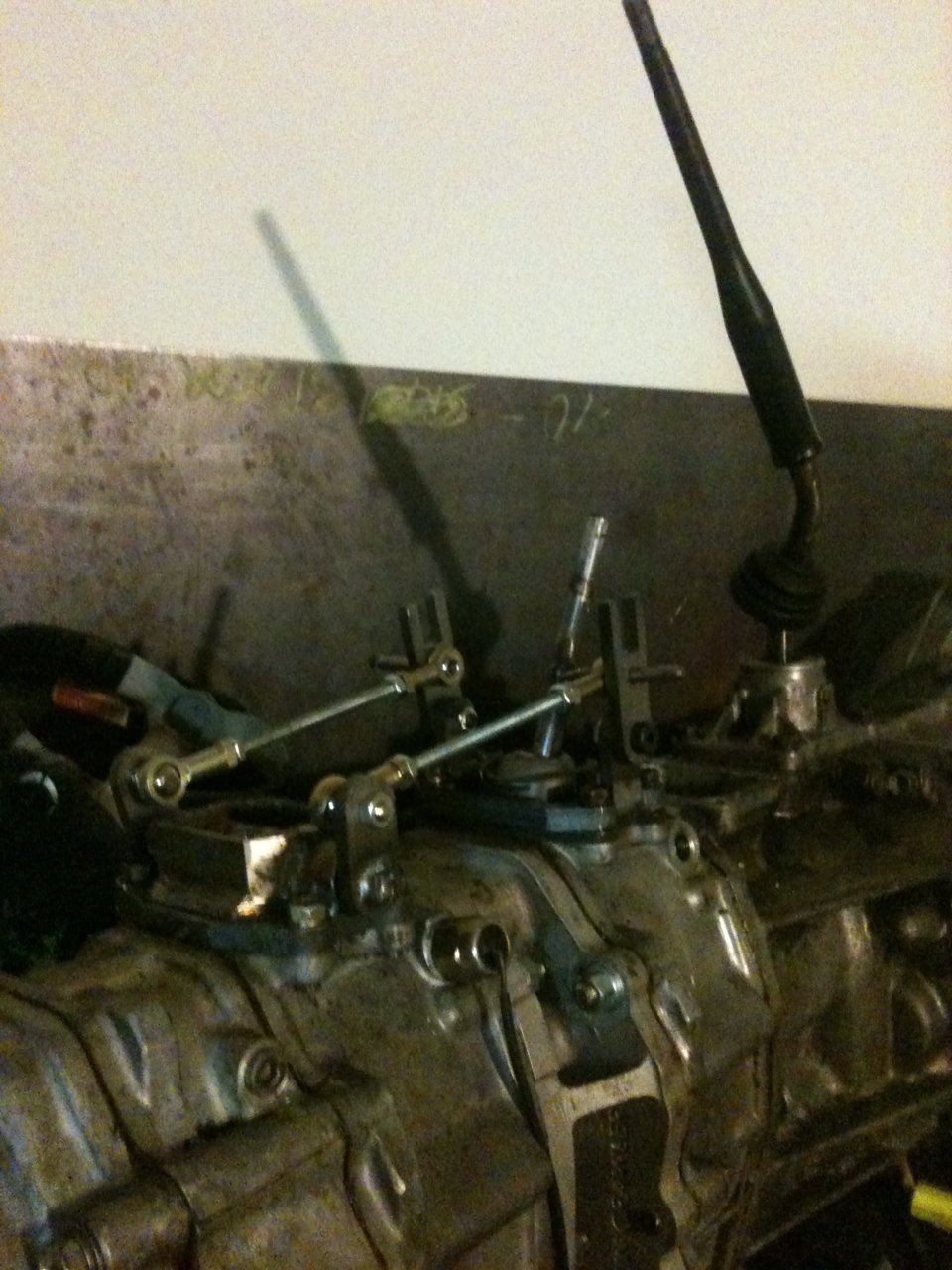

    You need to twin stick it into the six speed hole now... CB230618-3EAF-47AD-80C2-0E3EBEFFF709.jpg

    Thanks again for the continued replies :) We've been doing Twin Sticks since the 1990s and now that I've got my own Taco I've got something much better up my sleeve ;)
    (But with so much going on it's down on the priority list)

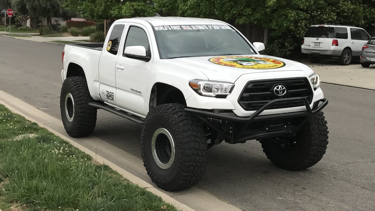

    So I've got a question. If the axles can now handle 40s where does that move the weakness to?
    I'm guessing inside the passenger arm of the clamshell
    I'm curious your take on moving the weak spots around by adding stronger parts.

    Thanks for the reply. First would be steering, and I'm hoping to have that addressed (the MarRack still needs to prove itself). I am not expecting to have issues with the front differential. At least not yet.
    Currently, the thing I wonder the most about is what would happen if I ran into a tree stump at speeds over 10 MPH. Don't laugh: This happens more frequently then you'd think while in 4WD stock low range buzzing around our High Sierra trails with tight tree squeezes. It happens with rocks too as I've accidentally clipped a boulder sticking out into the trail so hard in my 1981 at probably 15 MPH that stopped the entire truck and stalled the engine. This is why we don't drive with our thumbs to the inside of the steering wheel :D Nothing broke on my Hilux. But with 40" tires, I'm increasing the lever arm of any object acting against the tire, and those increased stresses have to get absorbed somewhere.
    As @MonkeyProof has mentioned, the lower a-arm attachment points to the sub frame assembly are already known to crack. I have a few ideas to help strengthen there. Hopefully I'll get around to that before my June Rubicon trip.
    I'm not worried about my UCA, LCA, or spindle for reasons I will hold to discuss until summer. :D
    A local customer of ours who works at a collision repair center mentioned issues Tacoma's have with breaking off factory shock towers in roadway accidents. Should we be worried about this? Are Tacoma's built for jumping still running factory shock towers? I know they have added second shocks but are there kits that add extra bracing (other than extra shock mounts) to the factory tower or is this not an issue even for them?
    We're also likely to reach the point where stock t/case outputs are failing, an issue we addressed on older gear drive transfer cases here and here. When this time comes for the Taco t/case we'll get on it, no worries.
