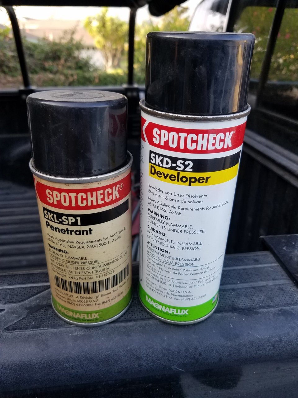

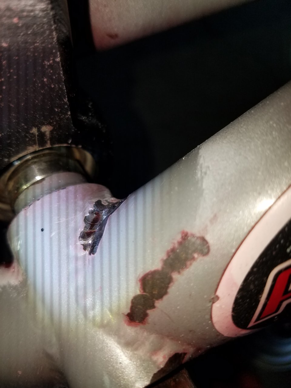

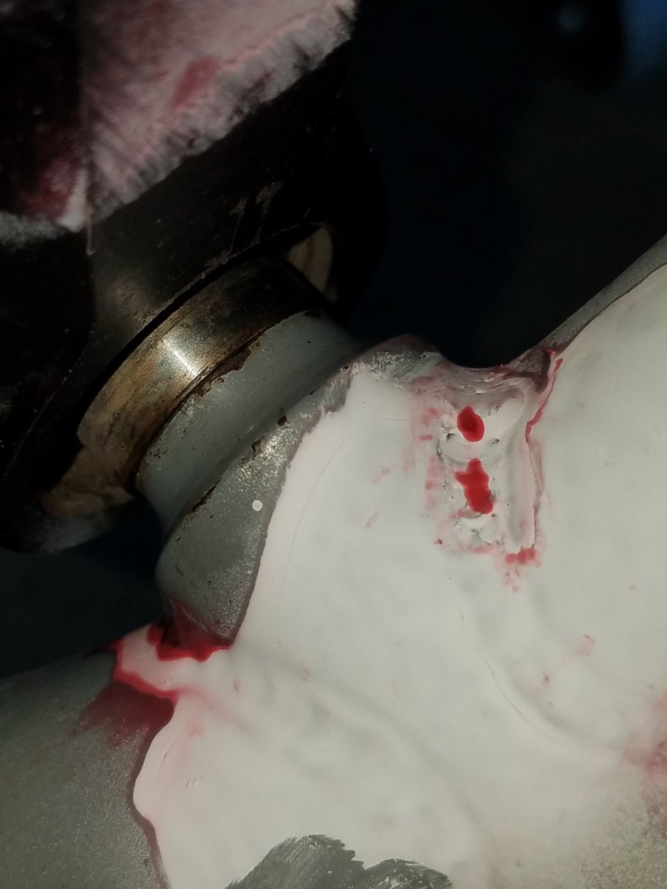

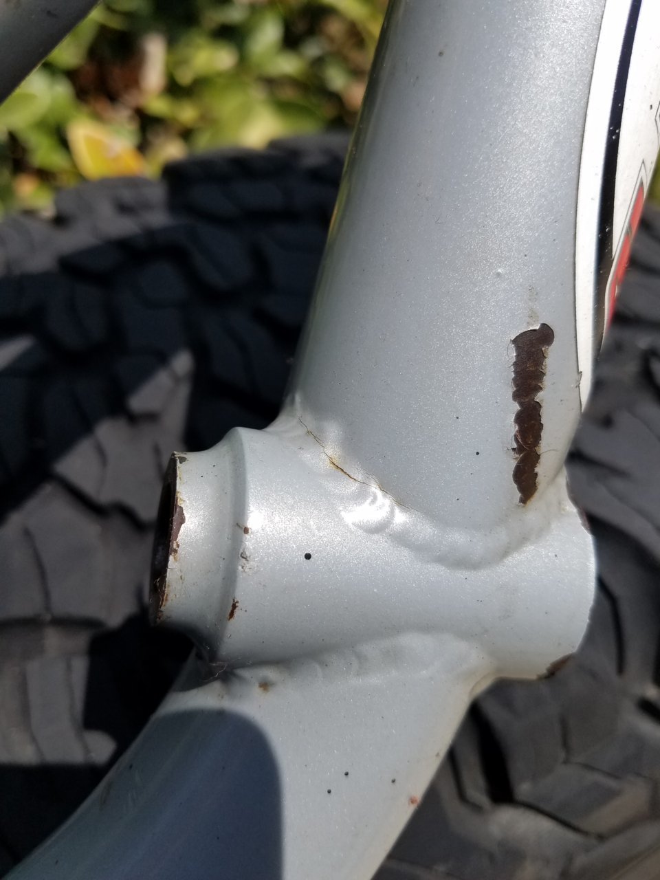

    I'm not seeing a clear shot of a crack. You're using a dye penetration test but I don't see any cleaner used before applying the dye nor after using the developer. Also, to get proper results you have to remove all paint surrounding the area and it doesnt look like you did that very well. Not to slam your process but the dye penetration testing is very finicky if not done properly. Can you post better pics of the crack?

    You can barely see the where the dye has been pulled out of the center of the weld where the crack is.
    But yeah, he probably should have wire wheeled and cleaned before he sprayed the penetrant.:p

    Yea but because it looks like a small pool that means it wasn't cleaned properly after the developer was applied. It should look like a red hairline crack, not a smudge of red dye.
    I'm not saying it's not cracked, just be careful because the evidence is misleading if the test isn't done right. Prepping the material for the test is important too. All the paint around the suspect area needs to be removed and it looks like the test was done over the paint in one picture.
