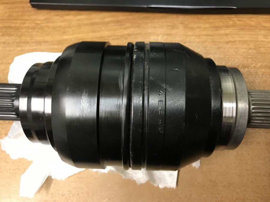

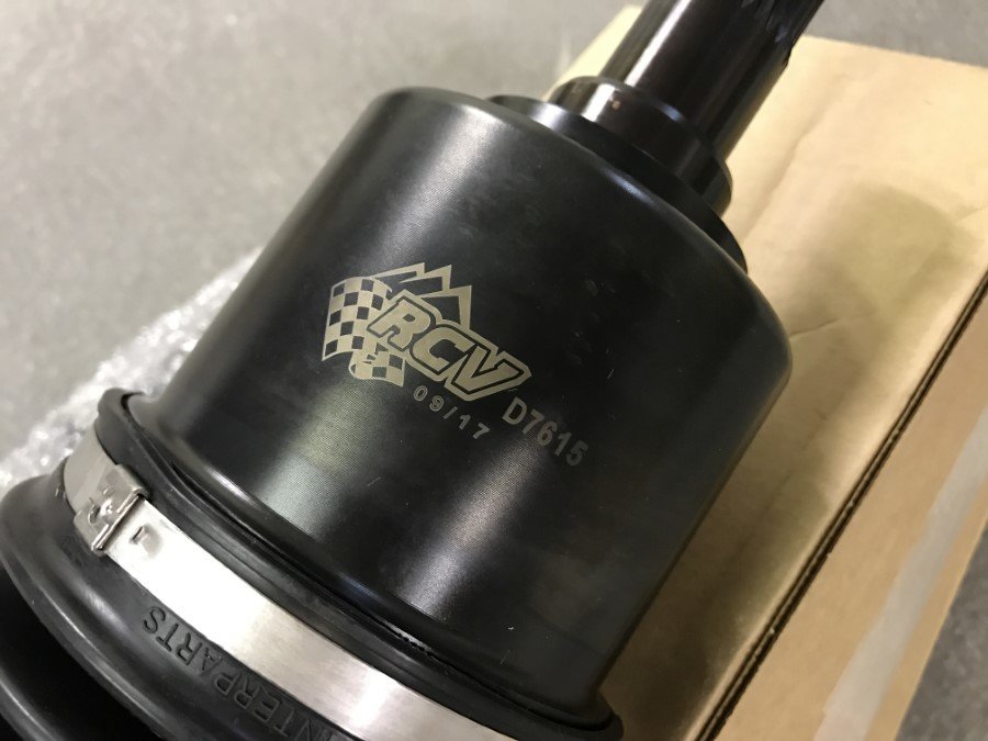

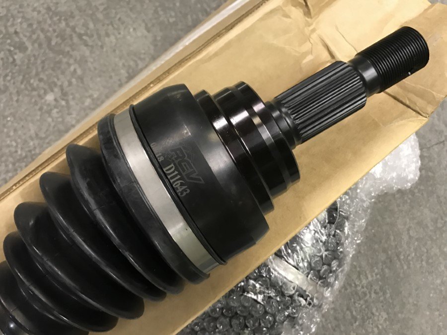

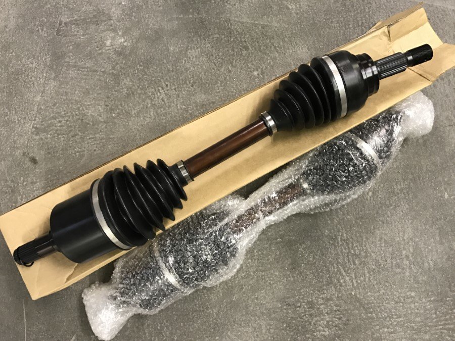

    RCV's new "Gen.2" Ultimate IFS Shafts
    New, more compact outer joint
    Inner slip joint

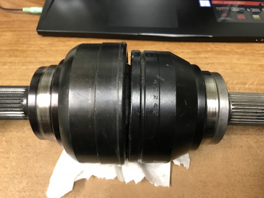

    And here are a couple random pics I took comparing Factory vs Old (larger) Style vs New (compact) Style RCV outer joints
    Left to right: New Gen.2, Old Gen.1, Factory
    New compact Gen.2 (left) vs Factory, showing about the same outer diameter:
    and finally old larger design (left) vs Factory, showing how much larger they used to be.
    The important thing to mention is that according to RCV's lead engineer, the weak link has never been the bell of the CV, it has been the inner cage components. So Gen.2 increases the strength of the inner cage components to the point now that they are breaking the spud shafts that either lead to the spindle (outer) or to the differential side gear (inner). So the actual strength limitation now is the physical size restriction of the Toyota design. The only way to make it stronger would be a larger front diff or larger spindle/hub.
    So moving to the smaller diameter outer joint did not cause a loss in ultimate / overall strength, and made designing a compact IFS LT system focused on ground clearance much more easy for which I am very pleased for the new compact joints!
