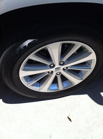

    Front shot of our newly acquired HiHy:
    sportin 19 inch wheels:

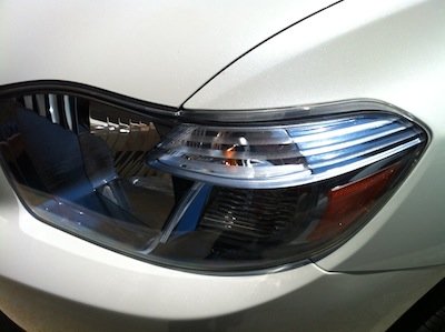

    Blue tint lens (hybrid style):

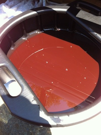

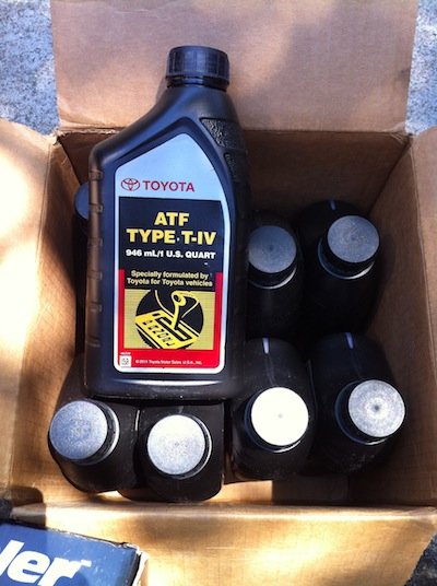

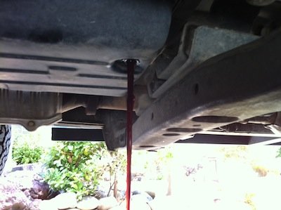

    Today I did a long overdue drain and fill using 4 quarts of genuine Toyota fluid that I bought online for decent price..
    Draining the nasty ATF:
    Wow, looks like a dirty brownish clay color :eek: :
    It's super hot in Cali right now so I'm gonna delay my transmission cooler install for another weekend. That will give me another 4 quart round of another ATF drain and fill.

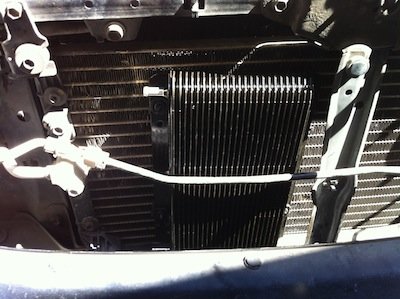

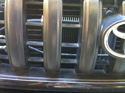

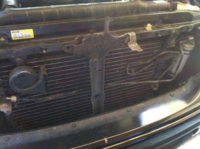

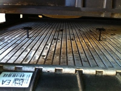

    Sorry for the lack of updates, It's been awhile. I've been adding one too many mods on our new HiHy so had to give Cargo some needed love. I finished removing the front OEM grill, repositioned the front AC line, and relocate one of the horns in order to mounted a new B&M 70264 SuperCooler automatic transmission cooler to Cargo. I chose to bypass the radiator's built in trans cooler to avoid the dreaded "Pink Milkshake" that seems to be a common issue with the 3rd gen 4runners, but less with the 1st gen tacos. I'm not taking any chances with my beloved taco considering the cooling system is factory original and has been running flawless over the 100K mile mark. Google "pink milkshake" and you will see why I was so anxious to do this mod from the get go. Something to note, I needed some extra transmission hose since the hose supplied with the B&M wasn't enough. Make sure you use transmission hose and not fuel hose, they have different pressure ratings!

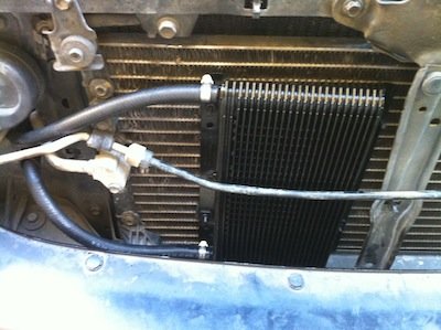

    The B&M 70264 is rated at 14,400 BTU and pressure tested to 200 PSI. The really great feature about this cooler verses others on the market is that this unit SELF REGULATES ITSELF! This is great cause when its freakin cold outside, the ATF bypasses the cooler and warms up the engine faster. If you are in cold climates this is a must! Product description from B&M: "The B&M 70264 unit monitors resistance to flow by allowing a controlled amount of ATF to pass through a self-regulating orifice. Controlled by viscosity, thicker ATF is returned directly to lube through two bypass openings in the stacked plate core, while thinner ATF is directed through the core to cool as operating temperatures increase."

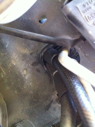

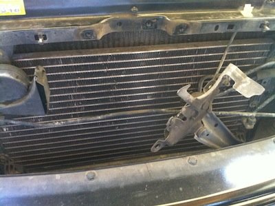

    After taking off the grill, notice the AC line behind the center spring support tower.
    unbolted the support tower
    carefully repositioned the AC line to the front (ac line has a nice gap from the support tower).

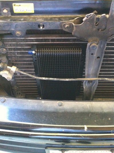

    Test fit the cooler into position (like a glove!)

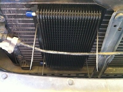

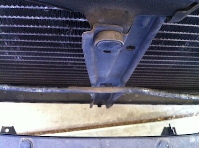

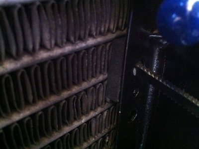

    Unbolted the 4 screws that shield and surround the fan so I could route some specialized zip ties from the radiator side (B&M's instructions is to use the zip ties for best performance, I have read that allows the stock radiator fan to pull enough air through the cooler to keep the trans fluid cool. Leaving a gap between the cooler and ac condenser using metal brackets is not optimal)
    View from the AC condenser side

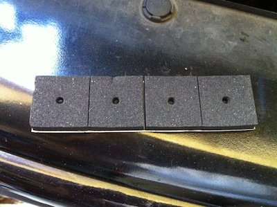

    Used the foam between the AC condenser and the cooler to avoid any rubbing
    Here's a shot of the foam installed
    Shot of the complete zip tie mount in all it's glory
    Routed the transmission lines through the same factory hole where the AC lines get routed, used the factory rubber protectors from the old transmission lines to protect the new ones.
    Transmission lines installed to cooler
    Grill back on, no interference, clean install, time to get a cool drink and prepare for another transmission oil drain and fill and call it a day.

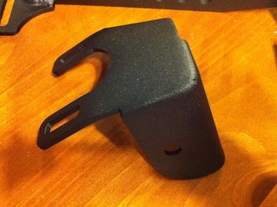

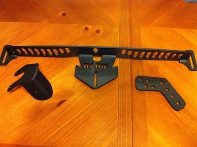

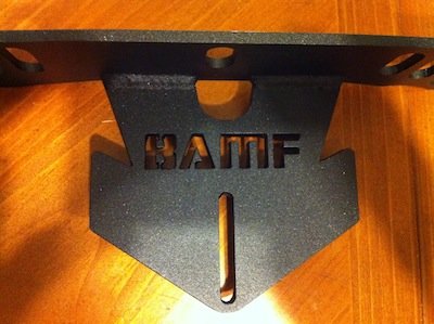

    Stopped by the BAMF shop after work and picked up some AWESOME parts from the GB deal. :yay: Even though I wasn't planning on installing these parts right away it was too hard to resist a BAMF GB deal!
    BAMF 1st gen light bar
    BAMF BPV Relocate Bracket
    BAMF 1st gen CB Mount

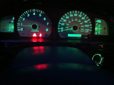

    I did buy some extra goodies for my trusty Cargo, I just haven't had time to post them up, hopefully later this month I'll updated this build with some pics.
    I remember following a excellent writeup off customtacos to get to the back of my gauge cluster in order to "twist and swap" to LEDS: HERE
    I forgot the LED part #'s off the top of my head, I think I found the #'s : HERE
    I hope that gets you pointed in the right direction! Good looking taco you have in your possession! Take good care of it and it will last you forever!! :D

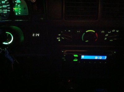

    Hey bigoly, thanks for the link for the cluster light change. I couldnt wait for the LEDs so I put in some blue bulbs. Not impressed with the brightness so I will be replacing them soon. Thanks again fod your help.

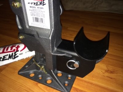

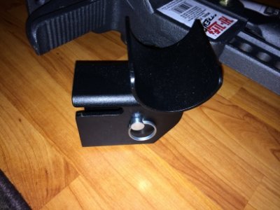

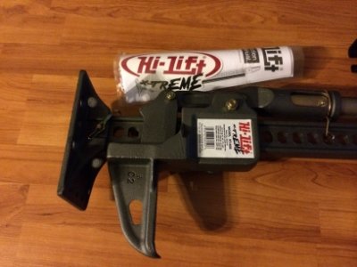

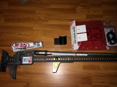

    Planning on doing my first round of tire rotations later this afternoon -I can't fathom dropping cash to have someone else do my rotations, unless you have a bad back or don't want to get your hands dirty, this task is not rocket science lol :D -

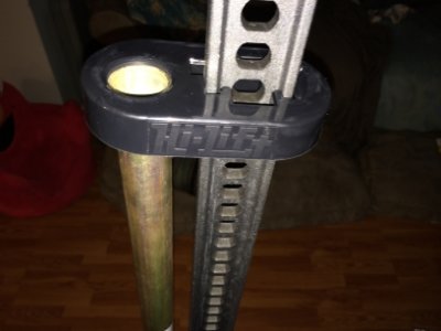

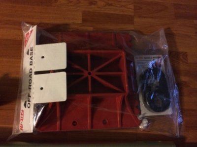

    Purchased an awesome hi-lift 60" x-treme version (omg this thing is heavy) with a base and plastic rattle holder gizmo. Also purchase a sweet (but a bit expensive) non-brand hi-lift slider adapter, off Amazon prime (via third party) of all places, already powder coated with attachment pin, perfect to clamp to my BAMF sliders and give Cargo a lift while I perform the tire rotations. Hope to have some pics of cargo hi-lifted with the slider adapter.
    Here's a showcase of the goods I've recently acquired:

    Are you hooking up the orange/white wire for dimmer? It should dim the buttons when the lights are on.
