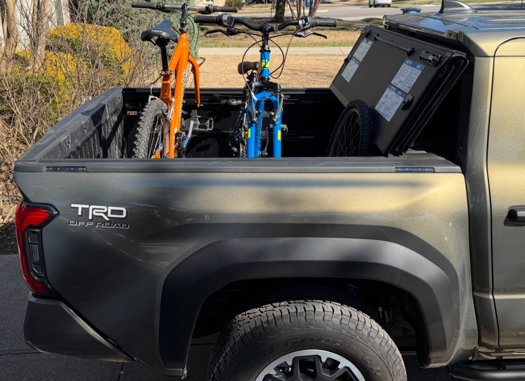

    Goals:
    • Carry two bikes (possibly add a third later)
    • Keep OEM tonneau in place
    • Don’t get in bed to load/unload bikes

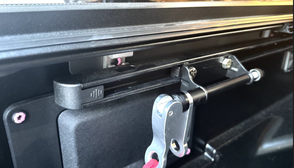

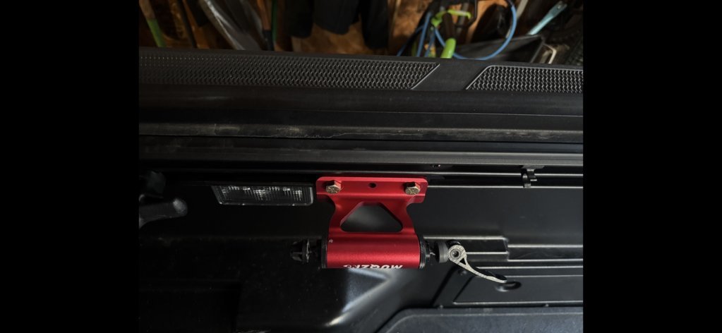

    Hardware:
    Benefits
    • Utilize bed rails
    • Open only two of three tonneau panels (tonneau doesn’t block digital mirror camera)
    • Crossways mounting allows easy fork access over the side vs. climbing in the bed
    What Didn’t Work:
    Inno Velo Gripper RT201 - I liked the possibility of hauling two bikes along the edges of the bed and didn’t really care if the tailgate was open. Unfortunately, the tonneau cover has edges that interfere with these racks.
    Swagman Fork Mount Rack - This could be mounted ‘backwards’ at the tailgate end of the truck, but the front of the tonneau cover interferes with the rear wheels and it only holds two bikes.

    modern mountain bikes will not fit that way in bed.. wheel base is to long.
