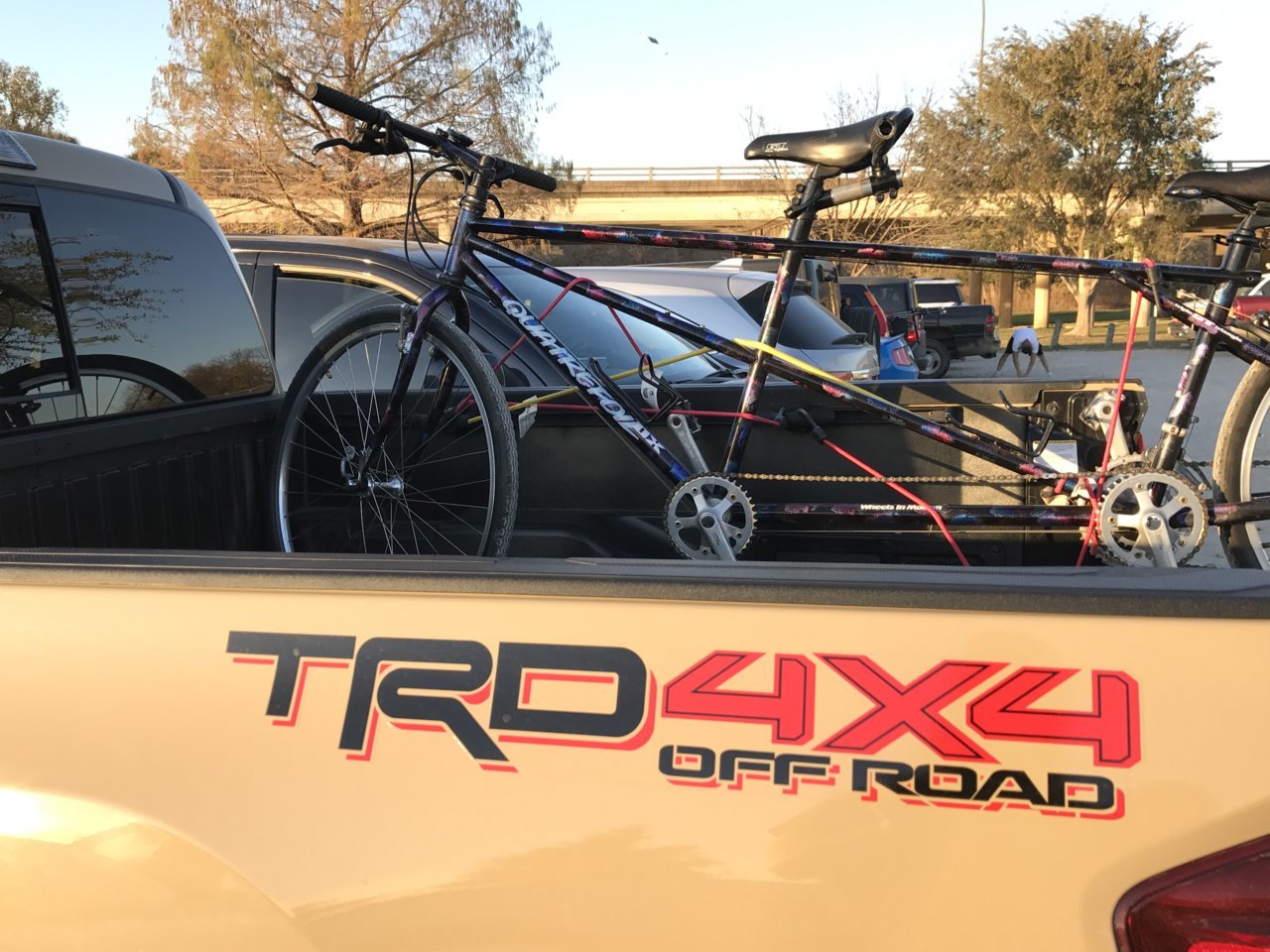

    228FD04D-65BA-4EBE-977B-3936F876B3D6.jpg 9879F5DA-05AA-432B-AC8D-893A2671B405.jpg That’s kinda what I’m doing now, but using bungees and just strapping it to the side. Works well since we don’t bike too far from home, but now that we want to venture out a bit I want something a bit more reliable.

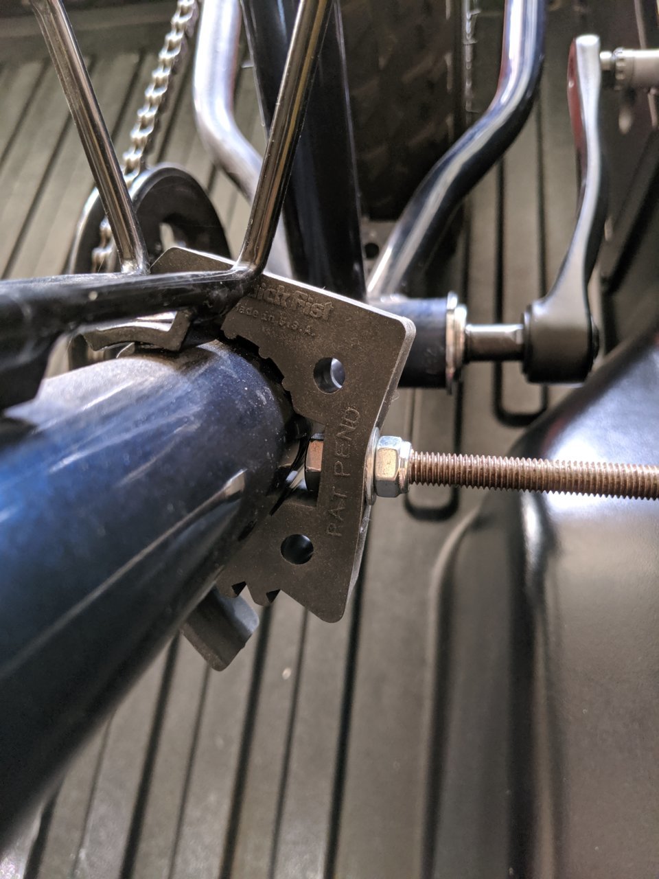

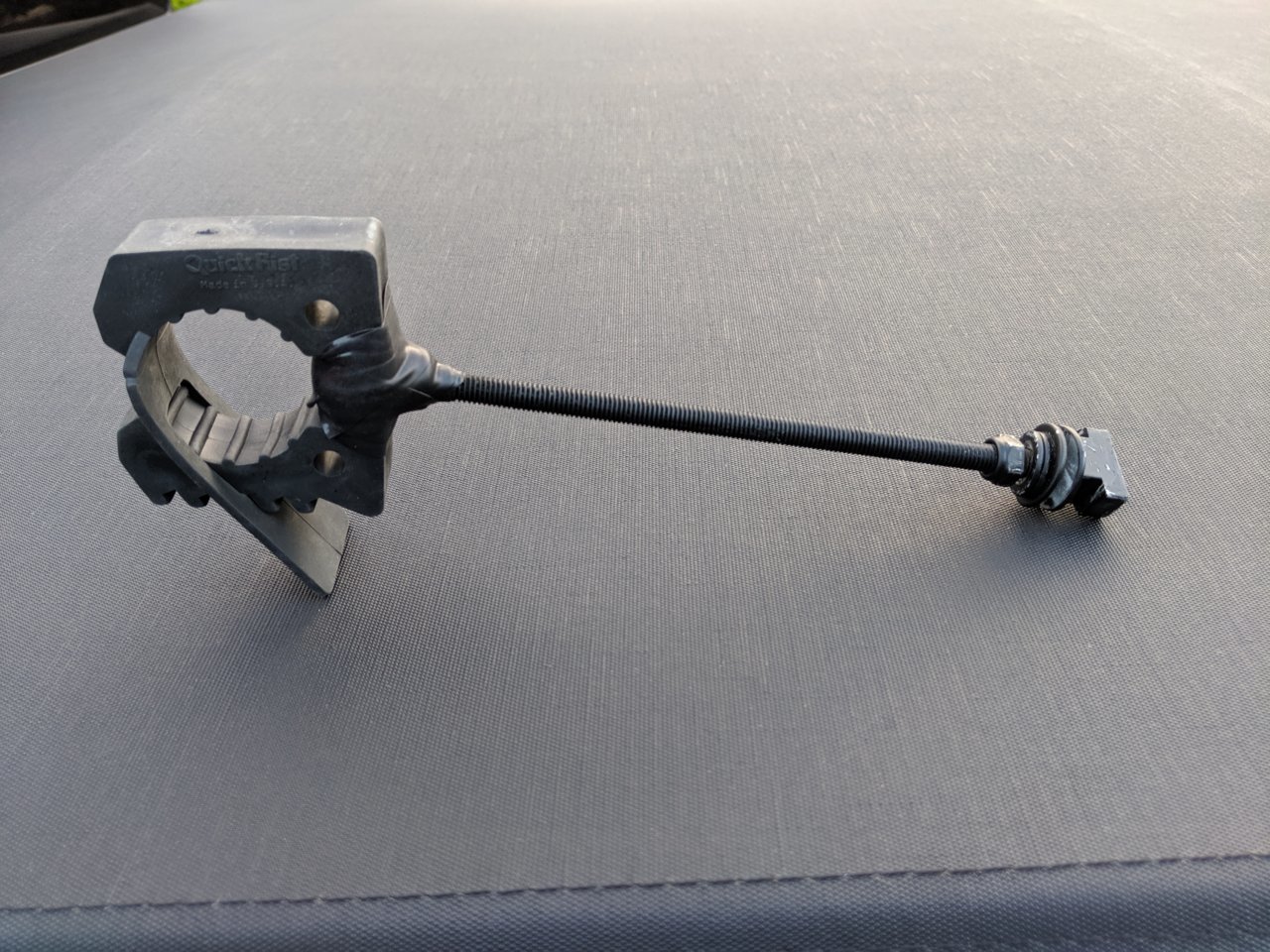

    I liked the Inno, but didn't seem worth the price, so I made my own:
    Since those pics, I have wire brushed and painted it. I also added a felt pad over the nut on the QuickFist and a wrap of self sealing tape.

    This is EXACTLY what I was looking for!! INNO is way overpriced and it looks like you hit the nail on the head with a DIY solution!

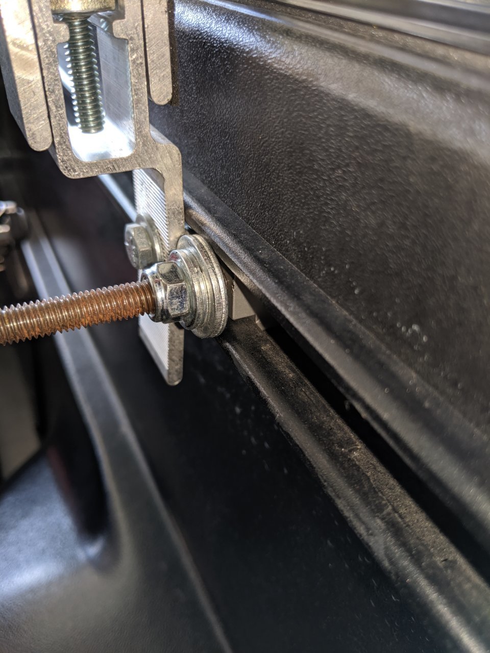

    It looks like you drilled a hole in the QuickFist, ran a threaded rod through it and locked it with two nuts/washers. However, Im not following what those aluminum brackets are against the C-Channel? Could you explain?

    The hole is already in the QuickFist. I just had to work the larger diameter rod through. Yes, a nut on either side of the QuickFist locking it.
    The accessory rail attachment is just one from Hondo Garage. You get four for $12 or $13 shipped.
    Here is a close up:
    Like was noted above, the clamp is right near one of my tonneau clamps.
