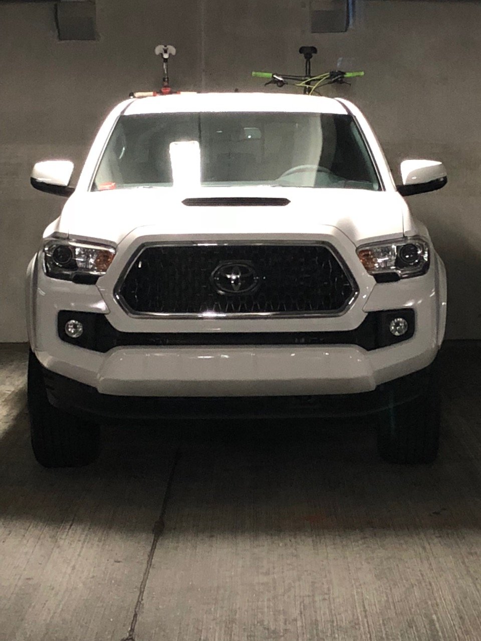

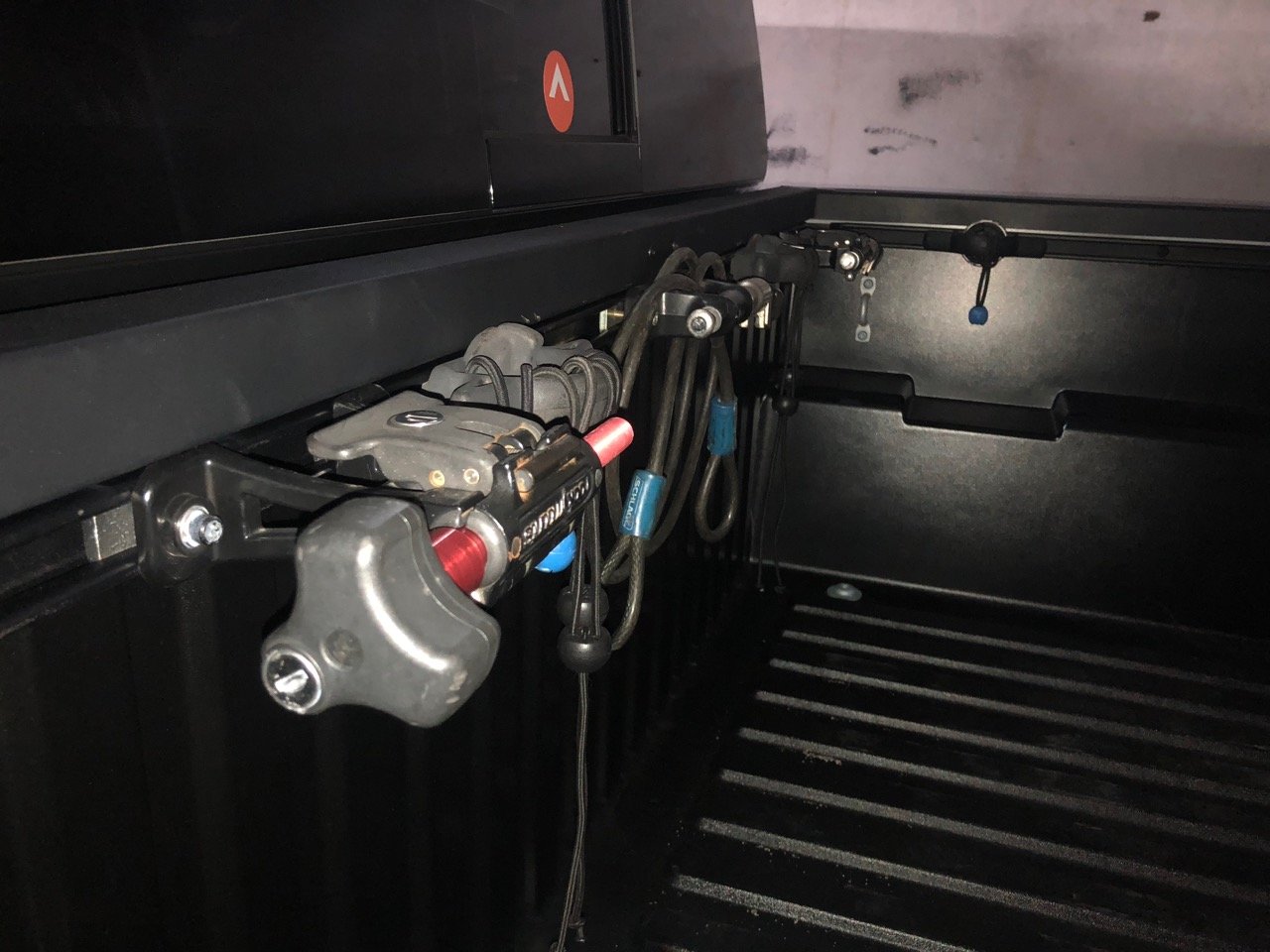

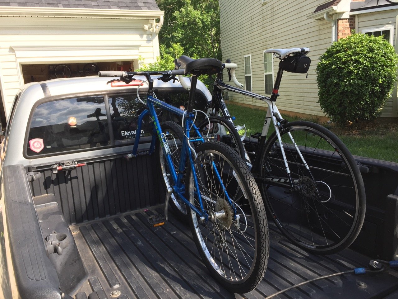

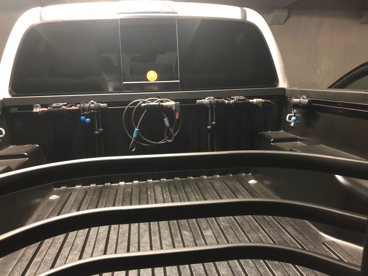

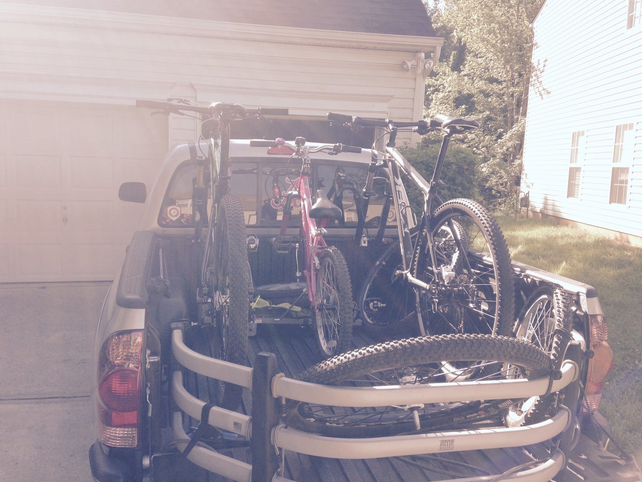

    If you have a 3rd Gen, you'll need to order a extra bedrail and install it.
    Then, I'd highly recommend the RockyMounts Driveshaft HM, (https://www.amazon.com/RockyMounts-...5948&sr=8-2-fkmr0&keywords=rockymounts+clutch), or the Driveshaft Track, (although the track gets a bit tricky with the bulkhead bar for spacing; https://www.amazon.com/RockyMounts-...s&keywords=rockymounts+driveshaft+track&psc=1 ).
    Then I use Yakima Universal Locking Skewers for my 9mm Axel Bikes, (https://www.amazon.com/Yakima-8002118-Universal-Qrlocking-Skewer/dp/B06X96RCJB/ref=sr_1_1?s=sporting-goods&ie=UTF8&qid=1520026257&sr=1-1&keywords=Yakima+locking+skewers%29%3B and I use a Locking 15mm Axel for the 15mm ThruAxel bikes, (FOX fork ThruAxel: https://www.ebay.com/itm/Fox-15mm-l...49336?hash=item4afda85cb8:g:E4EAAOSwOVpXV2lN; RockShox: https://www.ebay.com/itm/Rock-Shox-...177427?hash=item33c7f6e093:g:E4EAAOSwOVpXV2lN) ... you can just use the standard ThruAxel that comes with the bike if you have one and the RockyMounts Driveshaft mounts will take a 15mm or a 20mm ThruAxel with the supplied adapters).IMG_0334.jpg
    It's hard to see, but the rear wheels of these bikes are lifted and secured to the AMP Research BedXTender to give me space for cargo in the bed.
    IMG_0367.jpgIf you have a 2nd Gen Taco, the front bedrail should be present and this is what it looks like without using the AMP Bed Extender to Lift the bikes out of the bed.IMG_2165.jpg
