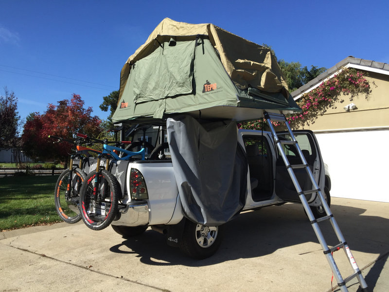

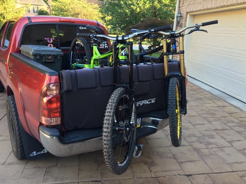

    Anyway, the project of the month is bikes and tents. I have a lot of hitch racks and am pretty dialed in with the 2 inch hitch. Then I started using a tailgate rack and that's even better. Fits up to 6 and it's very convenient.

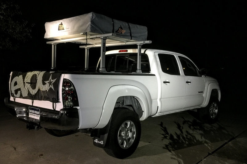

    The new project is a roof top tent bed rack as I have a Tepui Kukenam Sky. I just got the Thule Xsporter and it's cool but it doesn't really fit unless it's cut down.
    Turns out one of my good buds is a welder/fabricator so he's gonna make me a custom bed rack that can accommodate a tent still let me use the tailgate for bikes. I just dropped it off with him so should be done by Monday. I'll get rid of the Xsporter then. I got a few ideas from the big Bed Rack thread already.

    Dang that rack is high, I wouldn't be able to justify the loss of MPGs with that thing

    So high!! That is the lowest point the Thule 500XT can be set at as it hits the side molding on the bed of the truck.
    I hear it's common to cut down the legs of the Thule to get that rack low. Since it can't go all the way down to the bed floor without hitting the sides, one can only get about 6-7 inches of height adjustability out of it. And you'll lose the lock core holder to prevent the towers from getting stolen.

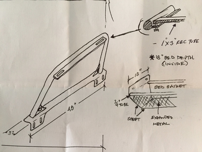

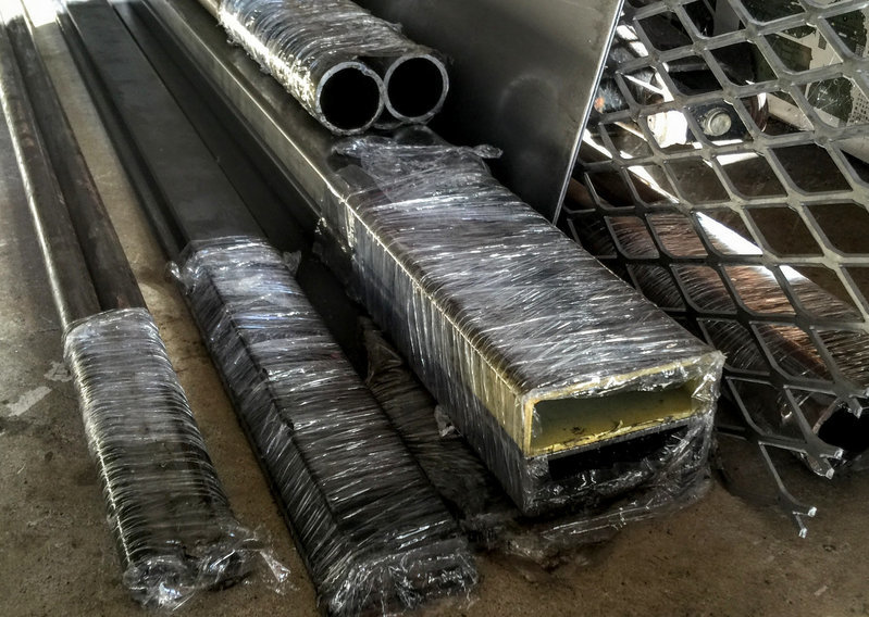

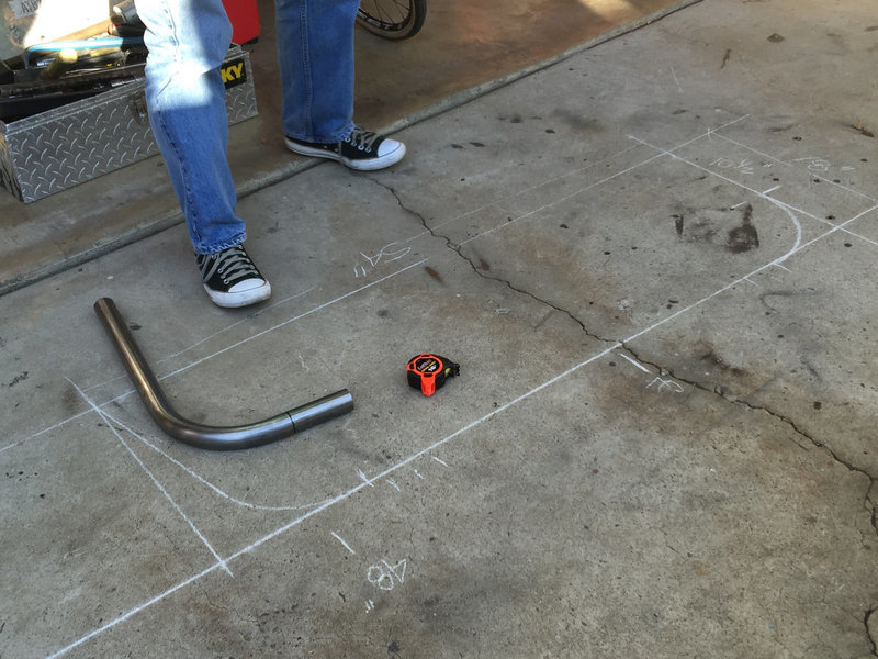

    Yes, we'll see how the custom rack turns out. My buddy's got the gift so he's got free reign on this one.
    He uses very strange software.
    He wants to make it modular.
    <ateroa;s

    What do you mean by "modular?" I have been wanting a rack that you can use for an RTT but somehow be able to take off the center bars easily in case I need to move furniture or put a 4 wheeler or something like that back there. There is one company that makes that, but they charge almost 2k for it lol

    I think that is possible indeed since he is making the crossbars removable. His initial intent was so the whole rack can be removed in pieces and stored flat. But hey, getting crossbars out of the way is certainly a useful feature. There's storage and expandability possible too.
