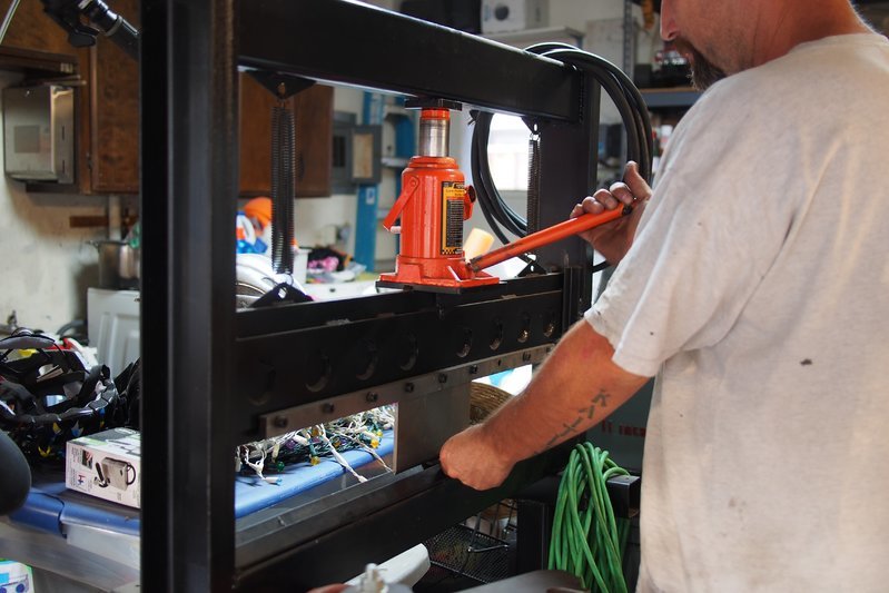

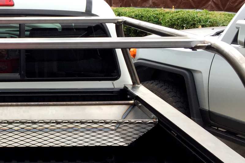

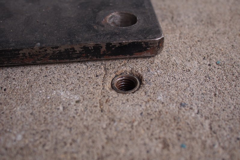

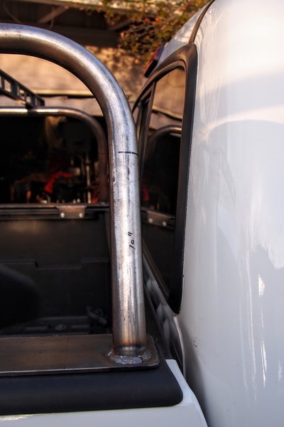

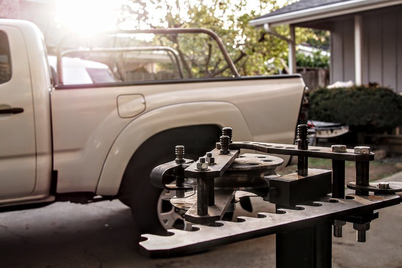

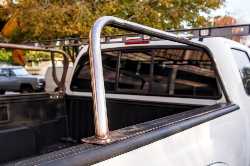

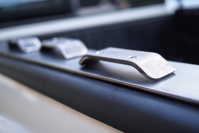

    bending pipes
    clearance with cab
    bending plates with a car jack based steel bender
    bent plates
    smoothing out the edges
    test fit
    anchor holes for the tools.

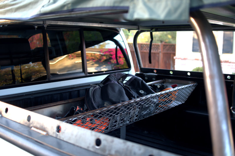

    Coming together

    Here we go!
    Paint or powdercoat?
  4. Nov 7, 2016 at 5:55 PM
    #24
    GHOST SHIP
    GHOST SHIP hates you.
    Mar 9, 2015
    #150537
    22,404
    GHOST
    Powdercoat. With the modularity you built into the rack, and it is expected to go together and come apart quite frequently, the PC would hold up better than paint to the extra traffic. You can always paint to touch up if necessary. Great design BTW. Mine will be similar. :thumbsup:
