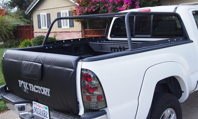

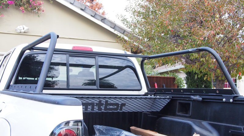

    Ok, just got it back from the powdercoaters. Turned out to be $150 since it turns out I have some dealin' skills.
    So sick.

    Lookin good. Powdercoating came out nice

    PC looks awesome!

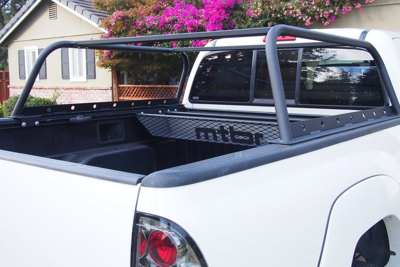

    If anybody is in the Bay Area and needs powdercoating, this is the place: https://www.yelp.com/biz/br-and-f-spray-santa-clara?osq=Powdercoating

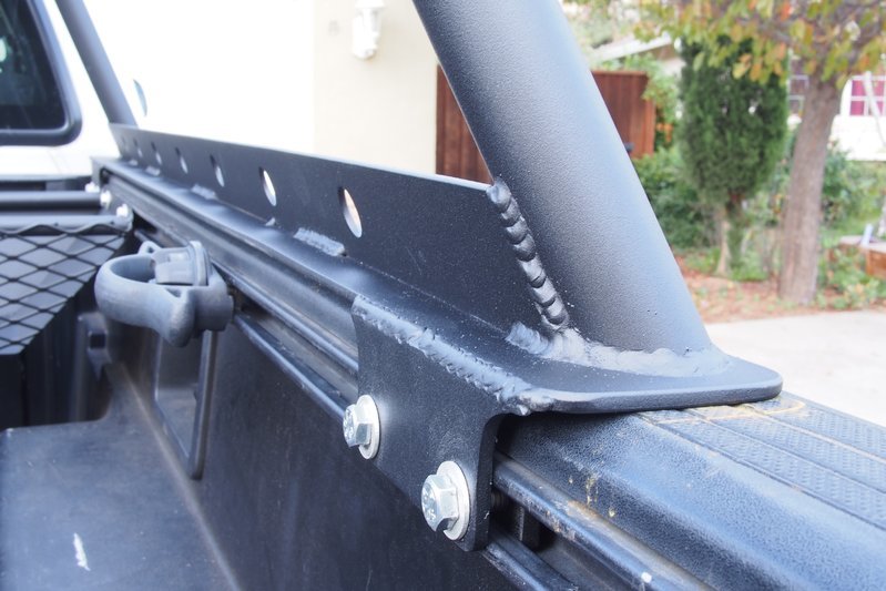

    Some photos:

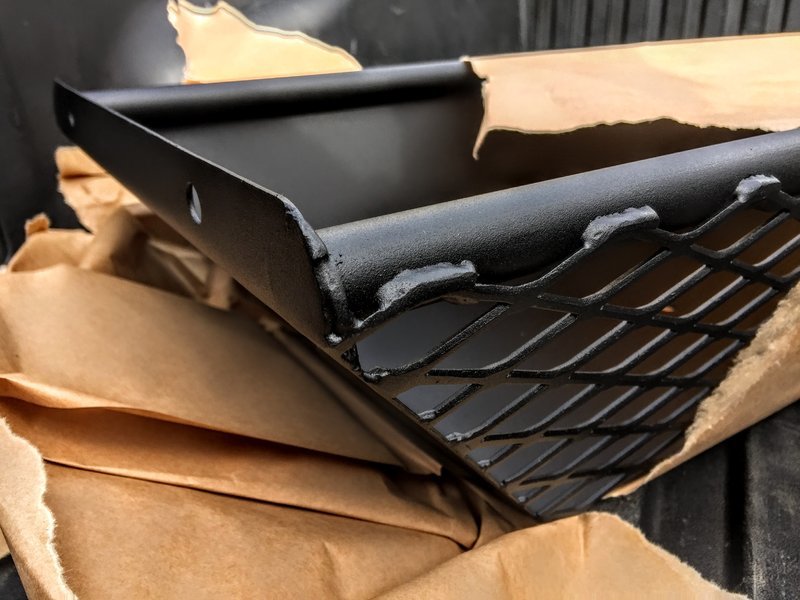

    Rack was brought out with the major pieces wrapped in Manila paper.
    Fine Texture finish came out so perfect.

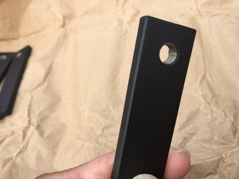

    These plates go in the sliding rail to anchor the rack. My fabricator reminded me to get these powdercoated since they will rust if unprotected. Threads were untouched!

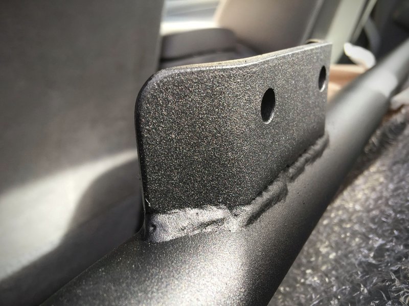

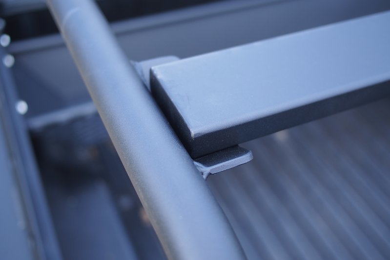

    The magic of the system is with these removable crossbars. It's held in place by one bolt from the bottom threading to a nut welded inside the bar. The bar ends are capped and smoothed out.

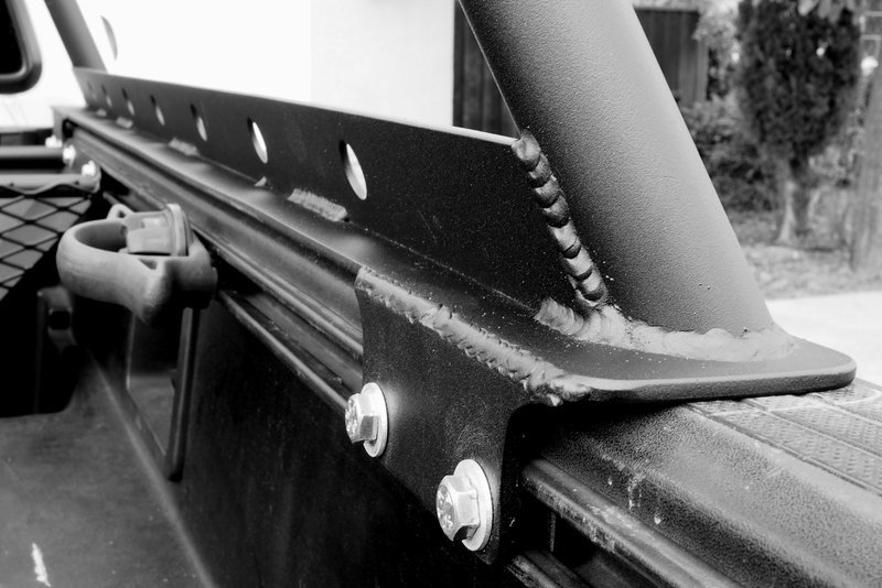

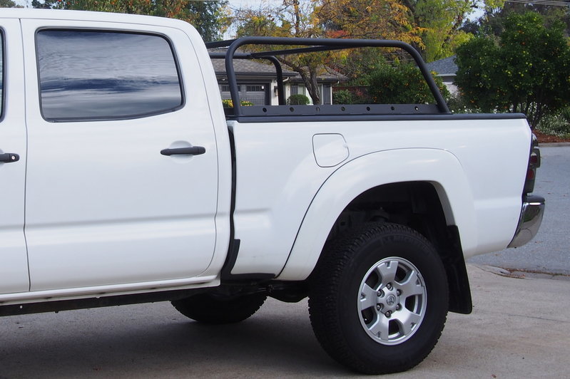

    Powdercoating is key since many parts are removable or movable. Does not scratch at all. Side rail is used to keep the rack in place. All the weight is transferred on to the top of the bed.
    Money shot with rear crossbar removed.

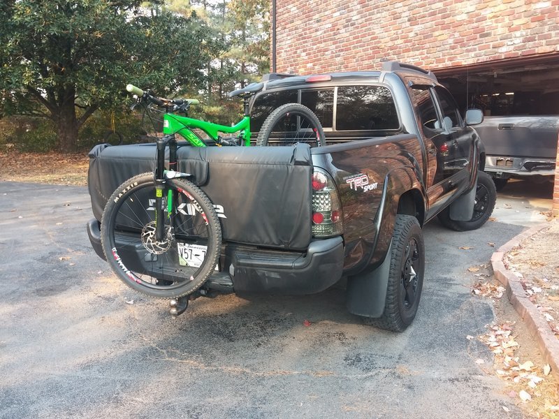

    Everyone's trucks and bikes are looking good! Here's my beaters.

    Very nice. You got two sweet trucks??
    Nice SC Bronson!!! And brick house!
