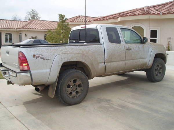

    this is 5100's at 2.5 stock springs and 2"aal
