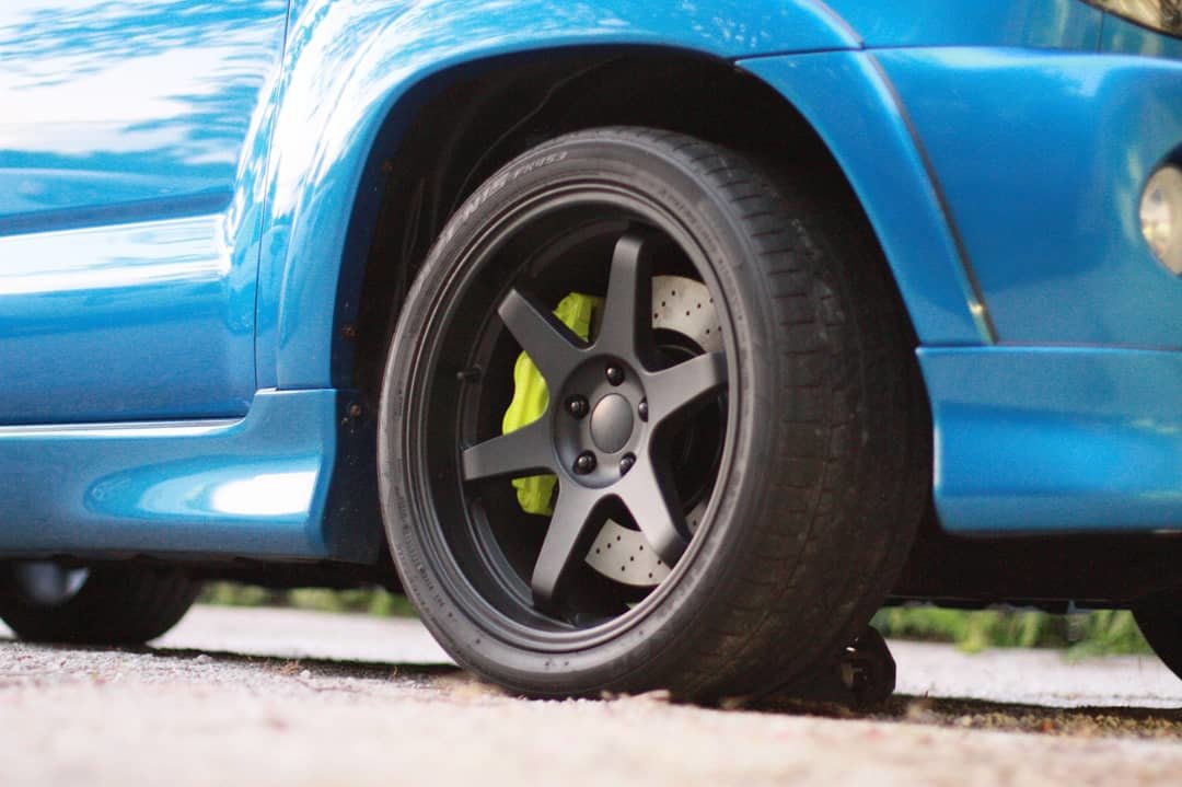

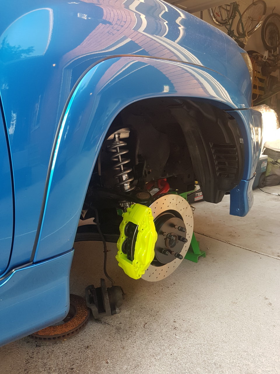

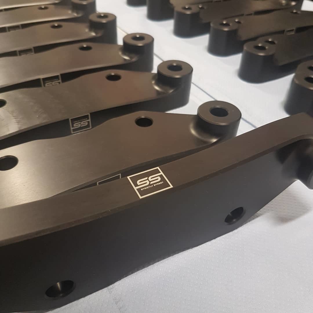

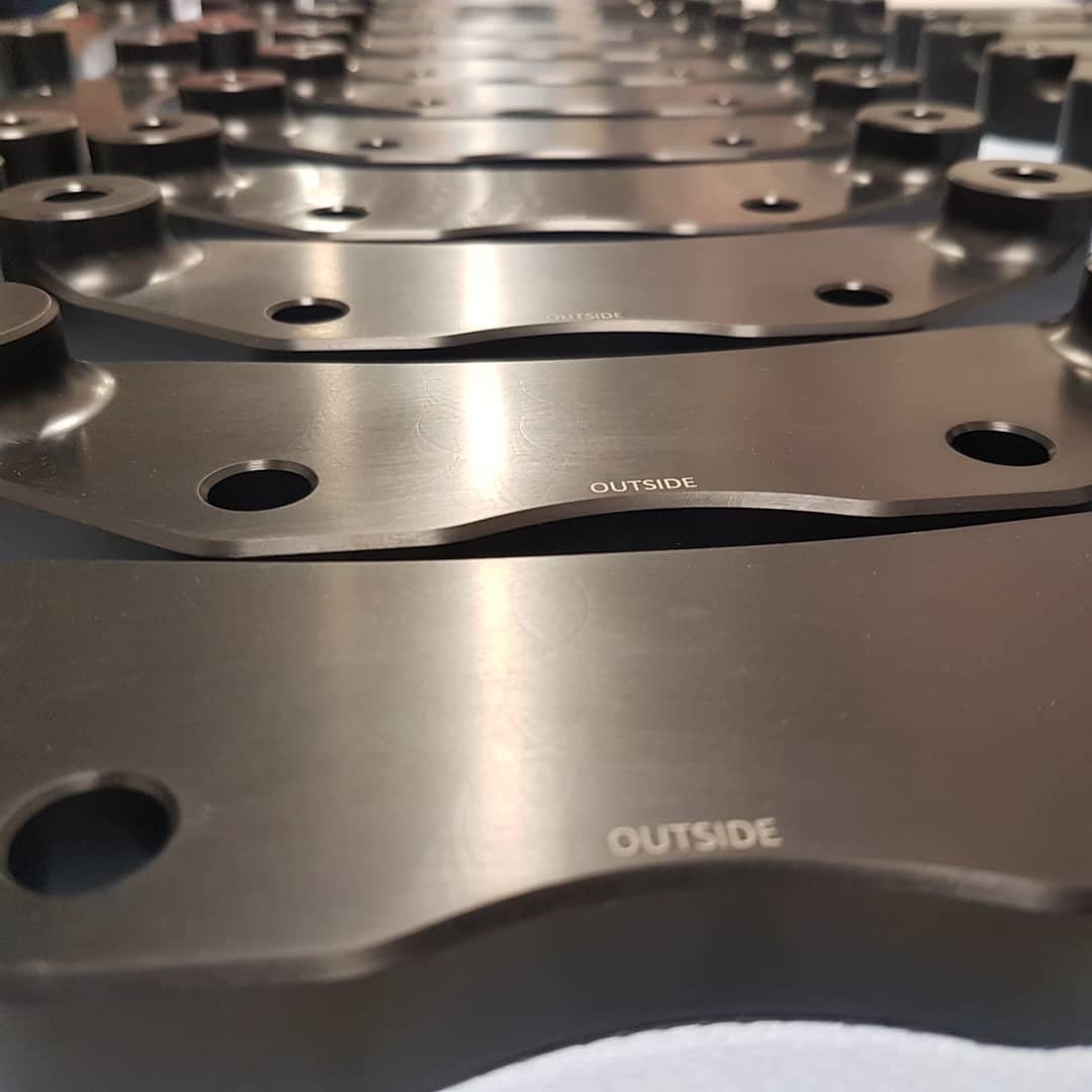

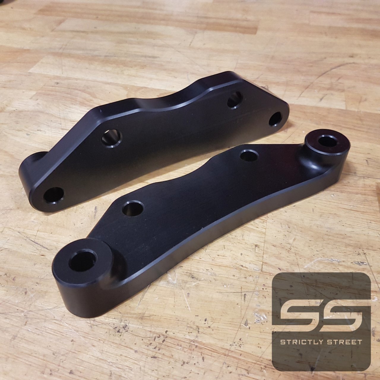

    I recently designed and manufactured some billet 6061 aluminum caliper adapters for my X-Runner that uses Tundra calipers and Lexus ISF front rotors. The brackets are fully machined and hard anodized.

    I do not think the will work on the 6 lug trucks, but I can design a system for the 6 lug trucks if there is enough interest.
    They will not work with the third gen. I can design something if you would be interested.

    Will those allow the Tundra caliper & ISF rotor to be used under the stock 18" X-Runner wheel?

    Yes it does clear the stock X-Runner wheels
    Brake Lines - https://www.summitracing.com/int/parts/sph-950-44016/overview/
    Rotors - https://www.rockauto.com/en/moreinfo.php?pk=1792332&cc=1442132&jsn=1
    Pads - https://www.rockauto.com/en/moreinfo.php?pk=6094776&cc=1502967&jsn=3
    Calipers - https://www.rockauto.com/en/moreinfo.php?pk=4924806&cc=1502967&jsn=2220

    After doing some quick research I found that the 3rg gen and 2nd gen share the same steering knuckle and caliper. So the bracket would mount up but the rotors for the lexus ISF are 5x114. I would either have to make a new bracket utilizing a different rotor or I could redrill the ISF rotors to 6x139.7.
